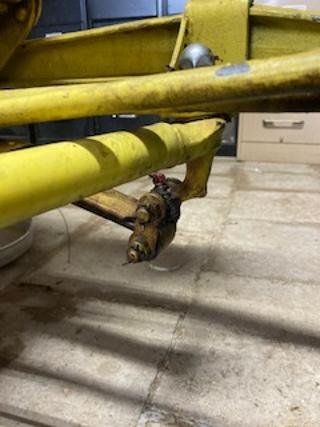

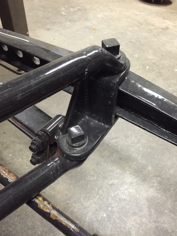

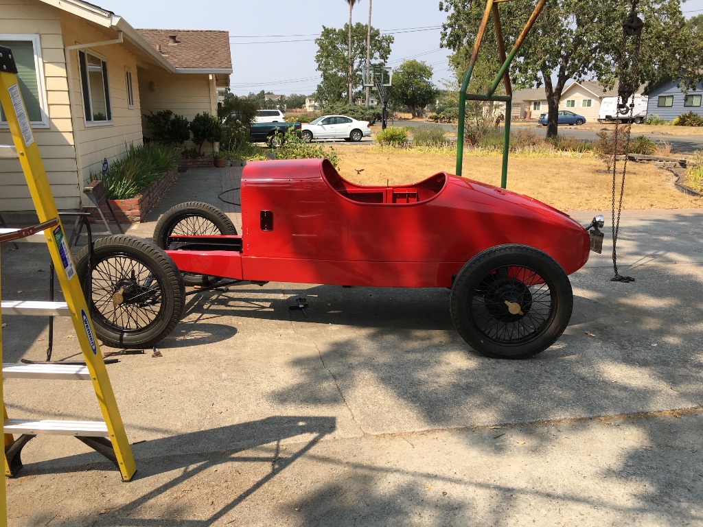

Still very rough, but mine was lowered with a bracket fabricated in front of the radiator for a spring perch. Wishbone lengthened to accommodate. Have not had time to see how the rear was lowered, but I can see some odd turnbuckle mechanism though the trunk.

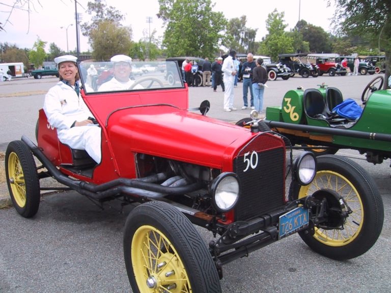

Re: Speedsters
Post by Kevin Pharis » Tue Dec 28, 2021 1:07 pm

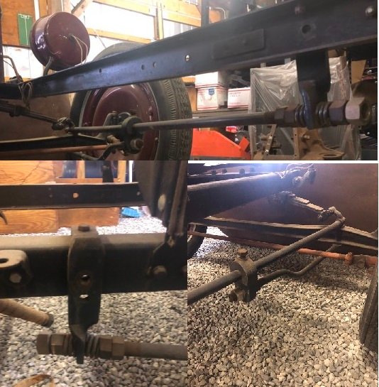

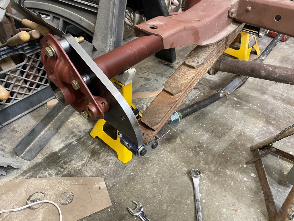

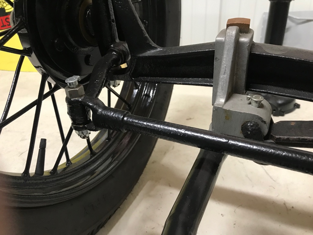

Here is a pic of my speedster, and my homemade “Laurel” type front lowering brackets. The rear has a 4” drop Z bracket holding the rear crossmember. Front and rear springs have very low arch.
Les makes a good point... I’ve bumped the drain plug a few times, never ripped it out... but it has loosened!

Nice cars posted so far, for the most part they look to be period mods. Kevin, looks like you have some steering rod chatter.
Picture below is my start point today.

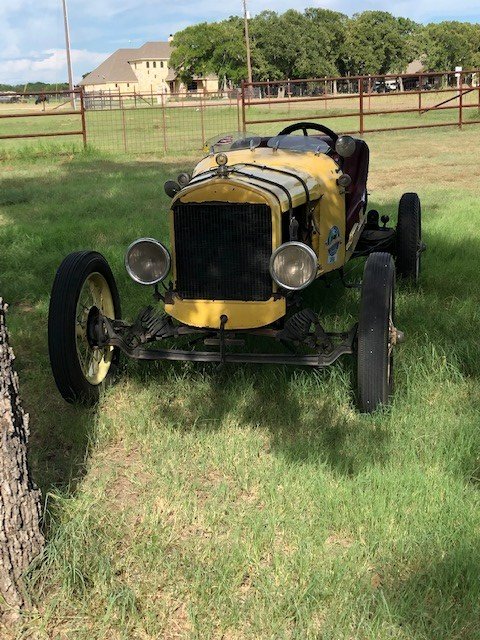

Here is the one my father-in-law built and my wife now owns.
Father-in-law and brother-in-law has made this speedster well known all over the us.

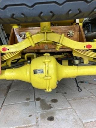

Tim, I hate brake rod rattle. I made these and I’m using juice brakes.
Andy

Re: Speedsters
Post by Kevin Pharis » Tue Dec 28, 2021 2:43 pm
Caswell wrote:
Tue Dec 28, 2021 1:18 pm
Not steering rod chatter... just plain ol not enough clearance. The tie rod is Model AA truck, and so tapers from 1-1/4” in the center to 5/8” out at the ends. Turning the wheels not only causes the steering arms to lift due to the caster in the axle, but the tie rod increases in diameter as it passes under the hair pins... damn homemade cars...!🙄

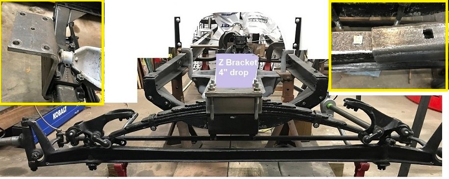

Caswell
Posts: 449
Joined: Tue Apr 27, 2021 9:45 am
First Name: Dean
Last Name: Brevit
Location: East coast
Re: Speedsters
Post by Caswell » Tue Dec 28, 2021 6:26 pm

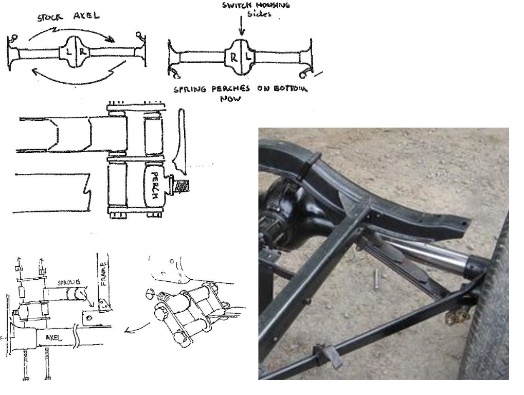

This is a copy but the car it is based on is one of the first speedsters, at least Model T type. Also added pictures of original.
If I do look at lowering (if) am I correct with regard to amount of drop front to rear, 4" or 5" Z frame drop at rear goes with 3" dropped front axle .

Here is mine. Laurel brackets up front with ‘26-‘27 spindles. “Z” brackets out back. Stock front and rear leaf springs. Rides great, plenty of ground clearance.

Hi Dean,
The rear is only Z'ed 1 1/2" the rear spring was made by a local spring shop with reversed eyes & I flattened out the ends. The front end is simular to Laural brackets with T spring perches turned upside down with two beveled spacers between the bracket & raius rods so you can adjust the caster. If you look close the front axle is even with the hand crank hole. Maybe I should have mowed the grass before I took the pictures the car realy isn't quite that low. The radius rods have no clearance issue but I had to turn the rear spring bolts upside down to prevent the rear end from hitting the threaded end of the bolts. I don't think the next one will be quite this low, I'm collecting parts for it the one part I can't seem to find is time. The car with the chrome stacks is way faster that mine is.
Craig.
Craig.
Hi Craig,
Based on your explanation of rear mods I guess the rear drop is 4" to 4 1/2", front I just measured my car from axle top edge to top edge of frame crossmember at center and come up with your drop being 5 3/4" to 6" .Now without a body on my car is 6" from axle to crossmember.

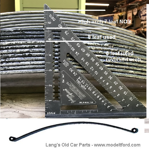

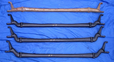

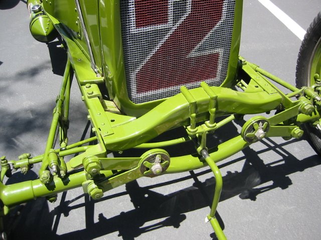

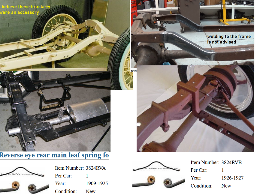

Post by TRDxB2 » Thu Dec 30, 2021 3:16 am
Tie rod & drag link interference with the wishbone or lowering bracket needs to be considered when lowering the front axle. Several methods to avoid this but to depending on the method used to lower the front axle. I had a Z bracket made for the front locally for $38 by a structural steel fabricator. 4 inch drop and have '26 spindles for a bit more - no wishbone going with side radius bars. The current spindle arms are late model and are turned upward. Not sure if I can get more drop if reverse them to turn downward or swap out the spindle arms for earlier straight ones. Lowered the steering wheel with the firewall wedge and added my own additional wedge. In doing this the driver position is pushed back some and the angle of the steering shaft no requires a u-joint (just got a Vega box from Hank so still adjusting the plan). The axle is also about 2 inches forward.
Other methods
A reverse eye gives about 1 inch drop
drop 4.png (606.61 KiB) Viewed 28170 times
drop 5.png (207.75 KiB) Viewed 28170 times

If I do decide to lower I will stick to what I have done before for less problems, Z bracket at rear and 3" drop axle from Sid's.
TRDxB2 thanks for posting the information you did, this thread is also intended to be informative for potential speedster builders.

Rear drop examples

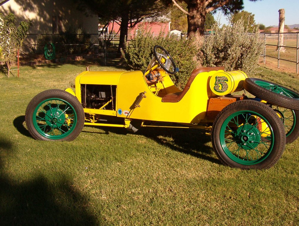

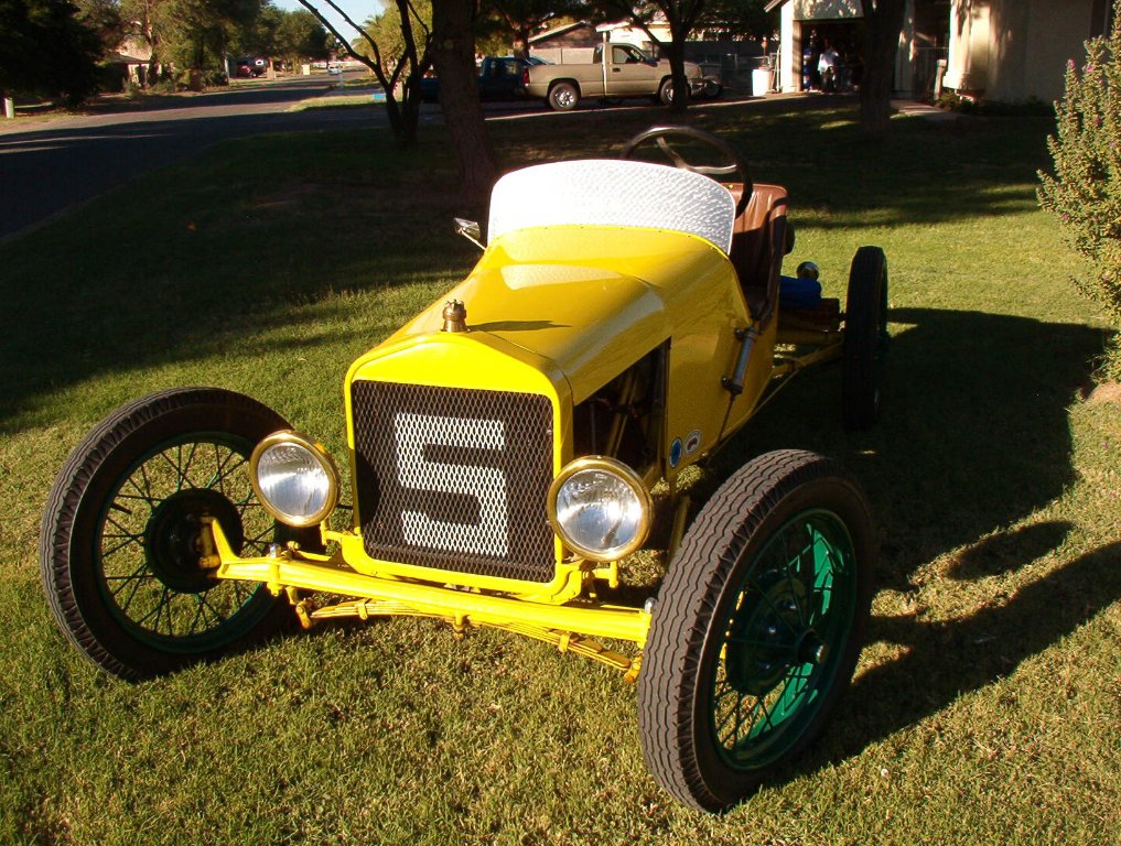

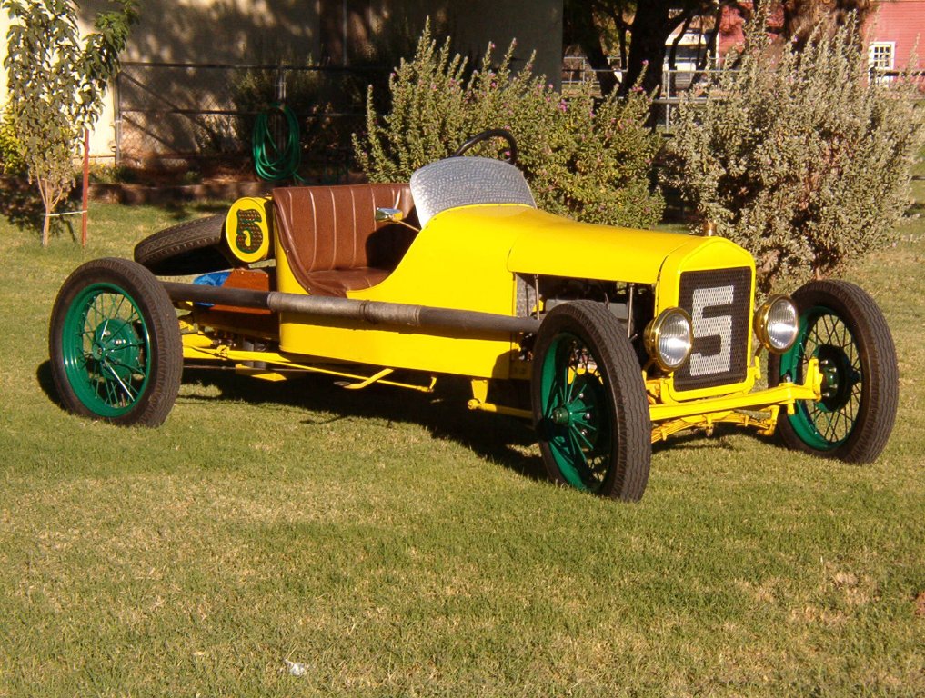

Post by Craig Leach » Thu Dec 30, 2021 1:14 pm

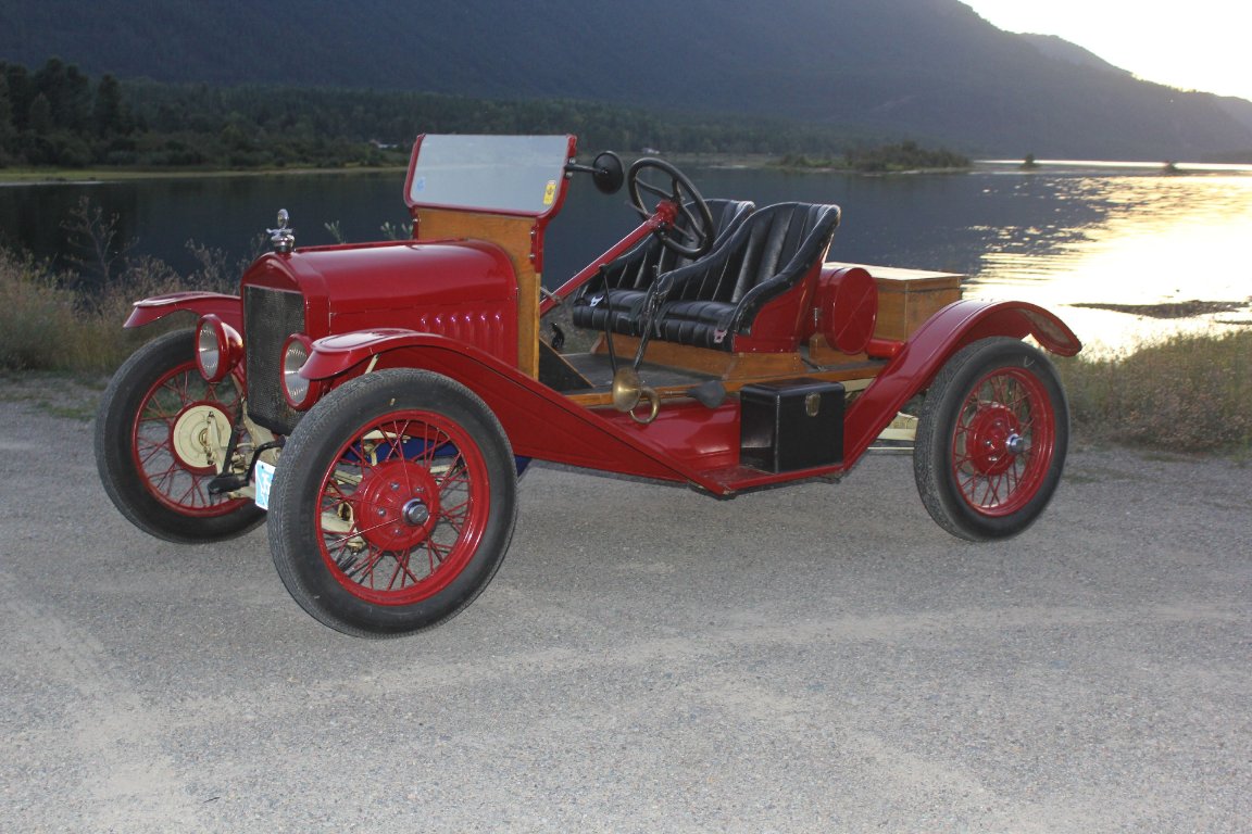

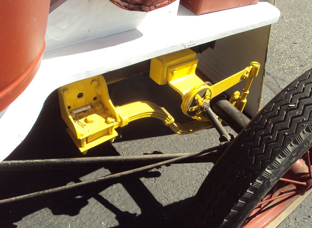

Hi Dean,

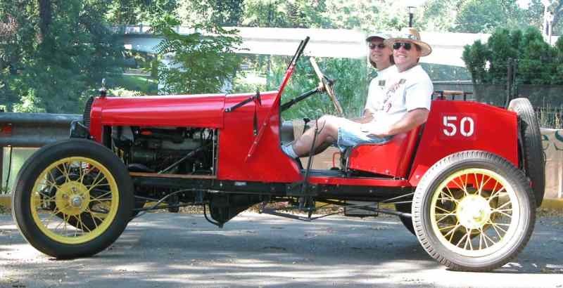

This has realy taken off has'nt it? Best as I can figure it's lowered 5 1/2" -6" in the rear & 6 1/2"-7" in the front.
Sorry not very clean but well lubed
Craig.

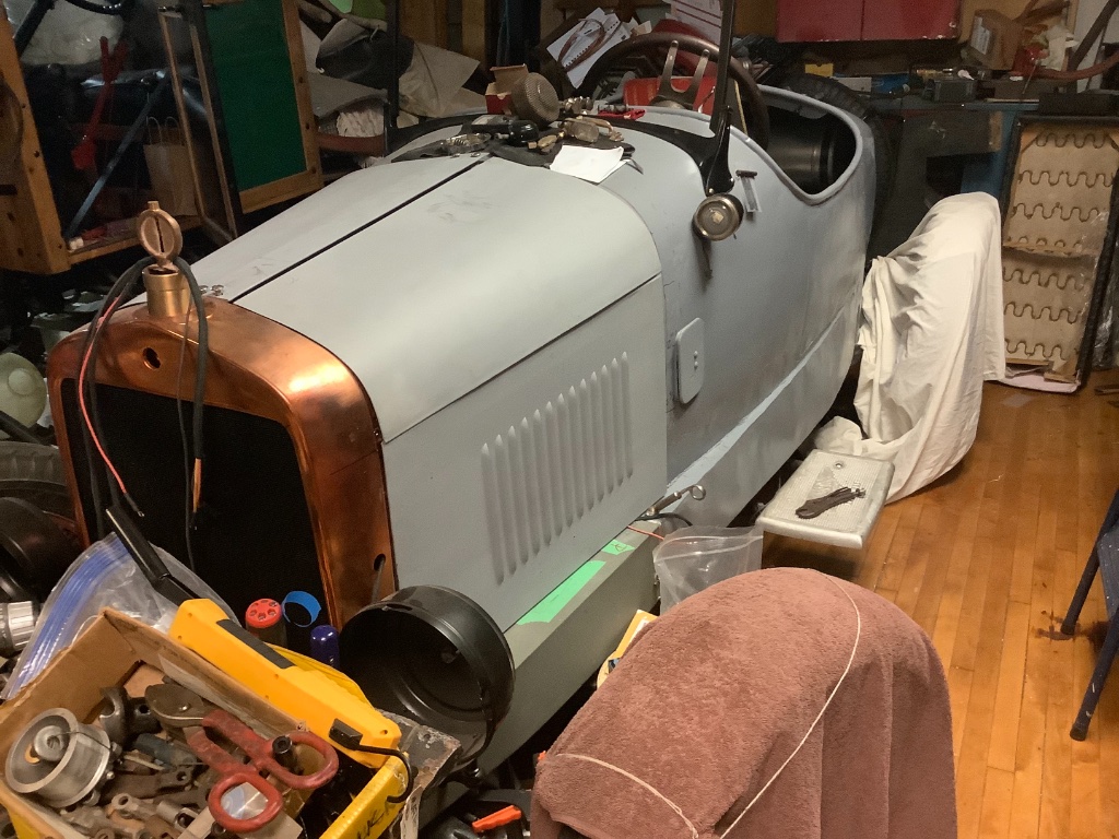

Mark Osterman wrote:
Thu Dec 30, 2021 10:20 am

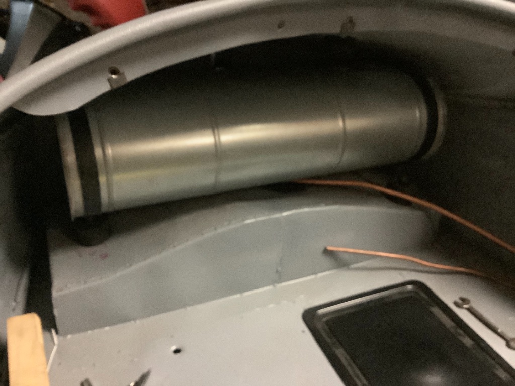

Thanks Mark,
Is/was the filler panel between what looks to be two firewalls (looks well done) a by product of setting back seating for leg room ?

I just went out and measured my speedster. I have 7” of clearance from the ground to the oil drain plug.
I had to flip the spindle arms for clearance also.

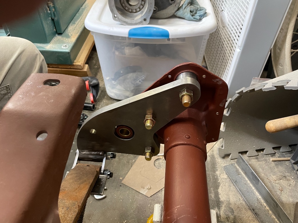

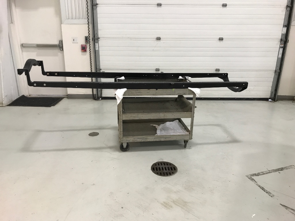

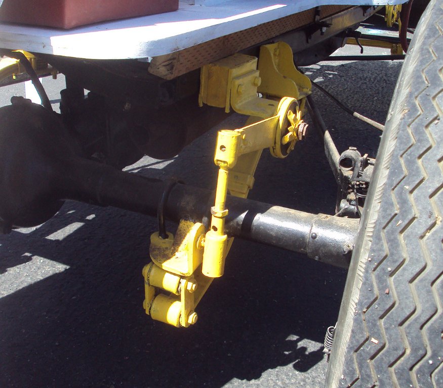

This is a work in progress, but here are the rear drop brackets I made for my 26. They move the axle behind the rear crossmember. They bolt to the radius rod holes and the hole for the original spring mount and serve a dual purpose, lowering the rear end and acting as the mount for outside brakes. There is a hole for the parking brake boss.
The hole for the outside brake pin is located so I can use current production Rocky Mountain Brake parts.
I have never seen this exact style before, but I have seen period plans for similar plates that moved the mount to the rear of the axle and there are multiple period designs that move the mount to the front of the axle in a similar location. I made them out of 5/8 1018 plate and welded the spring mount on. They are pretty beefy but it was not a part I wanted to flex or fail.
I did not want to “z” the frame and as I am using an auxiliary transmission, the extra wheelbase was not an issue (I had to cut down the torque tube and driveshaft anyway).

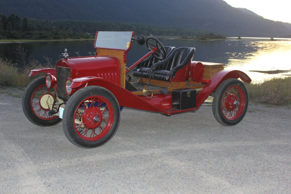

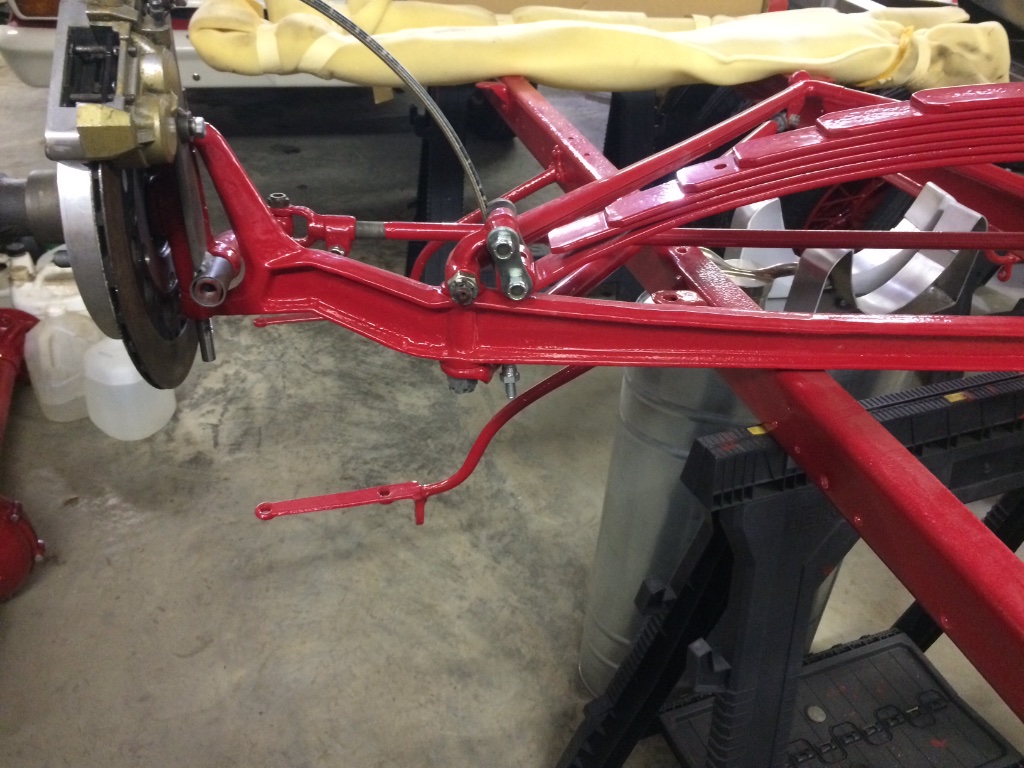

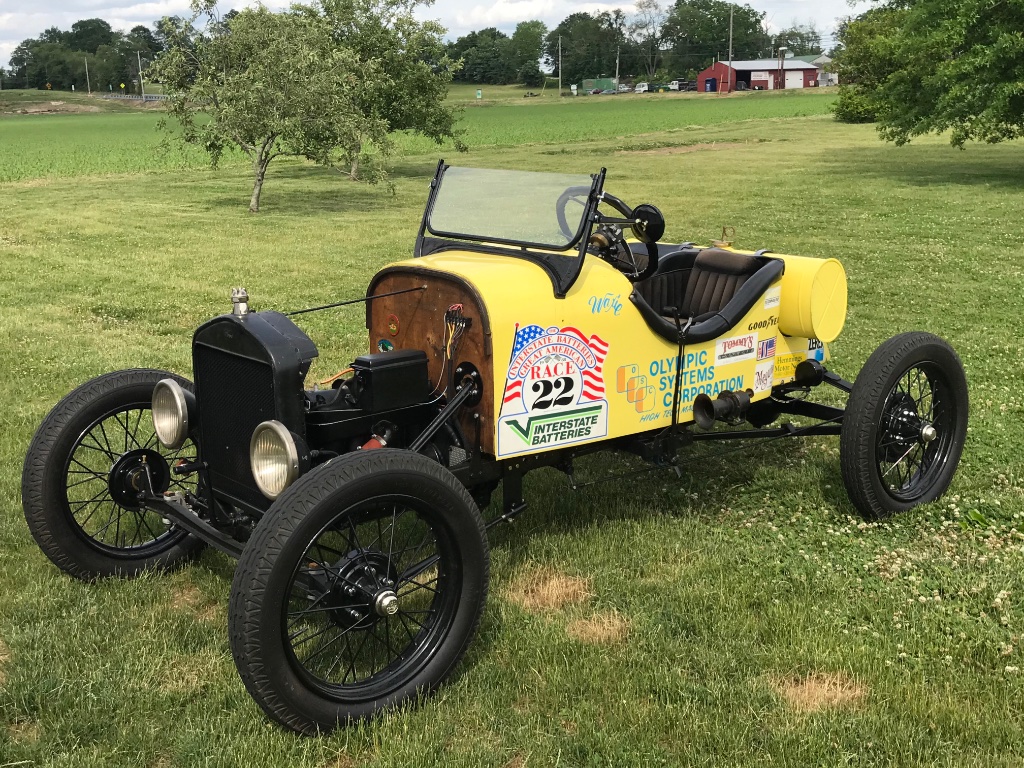

A picture of one I built in the ‘80’s. The front axle is moved ahead and lowered and the rear axle is also moved ahead (the spring behind the axle). It works great

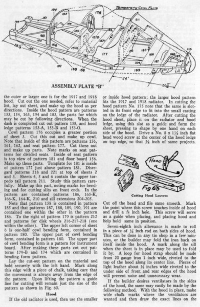

Caswell
Posts: 449
First Name: Dean
Last Name: Brevit
Re: Speedsters
Post by Caswell » Fri Dec 31, 2021 8:14 pm
I'm surprised that the body styles were this way as early as 1916

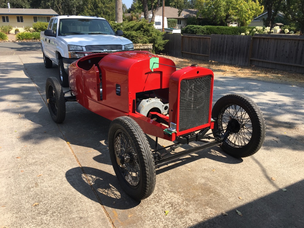

David Mazza
Posts: 229
Joined: Sun Jan 06, 2019 3:04 pm
First Name: David
Last Name: Mazza
* REQUIRED* Type and Year of Model Ts owned: 1925 t runabout
Location: North Adams ma
Re: Speedsters
Post by David Mazza » Sat Jan 01, 2022 8:45 am
Here’s my lowered roadster. The engine is off topic and I’m still working on connecting it to model t torque tube. I did make the model t hand crank completely functional with the updated engine though!

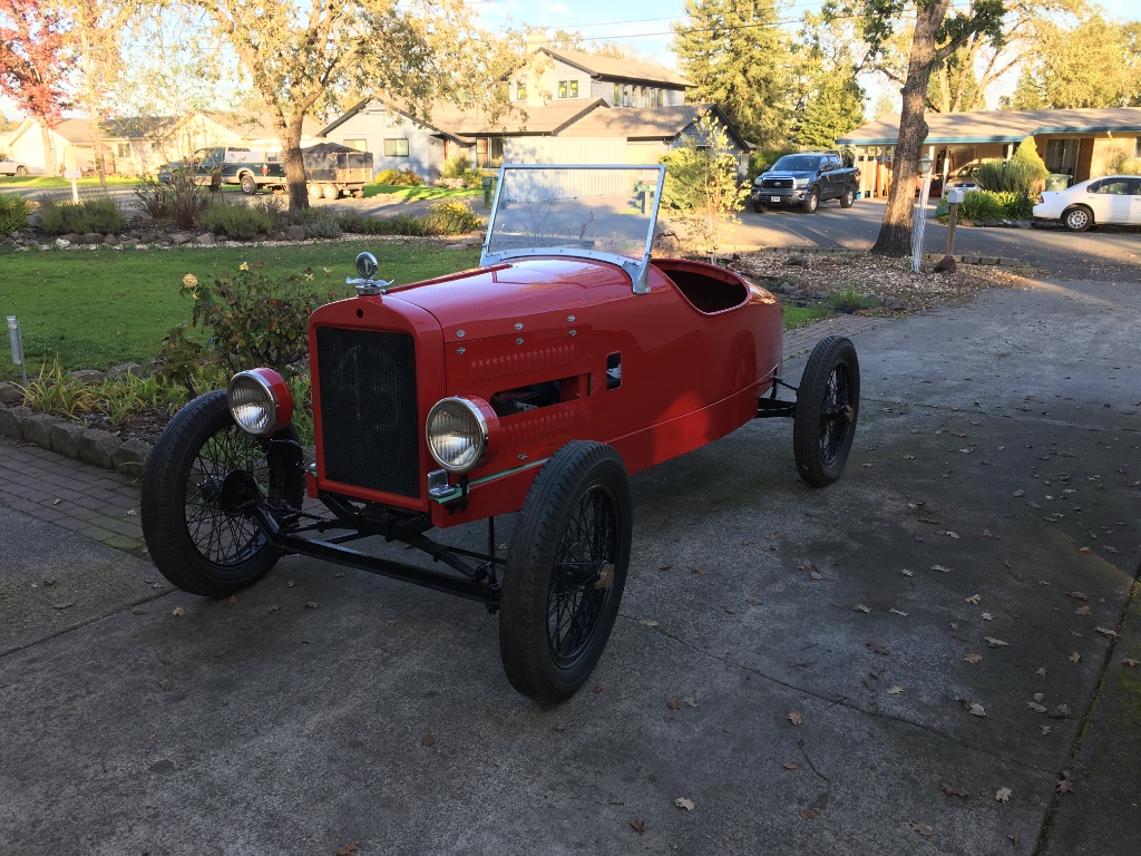

* REQUIRED* Type and Year of Model Ts owned: 1925 Model T Speedster, 1922 Model t Speedster project
Location: Hillsboro, OR
Re: Speedsters
Post by Tim Williams » Sun Jan 02, 2022 12:57 pm
Then when speedster events happen it is fun to see them in person and see all the different configurations people do with them and get ideas or just admire.

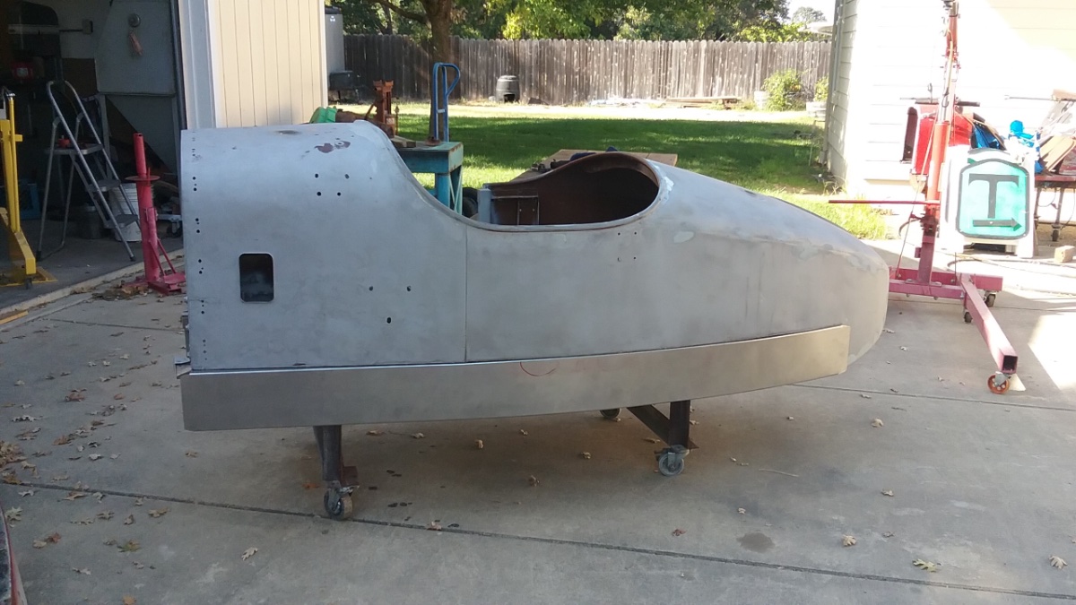

AndyClary
Posts: 909
First Name: Andrew
Last Name: Clary
Location: Usa
Re: Speedsters
Post by AndyClary » Sun Jan 02, 2022 5:28 pm
A little flashback. Had to make new skirts for my Mercury, instant 7 inch lowering.
Andy

Re: Speedsters
Post by Caswell » Sun Jan 02, 2022 8:55 pm
C322FDFB-1CA8-4F90-B0DE-E007A114EBBC.jpegA little flashback. Had to make new skirts for my Mercury, instant 7 inch lowering.
AndyE89C93A1-3071-42B5-AF58-A29B3B831520.jpeg4EA0199A-82FE-4198-BDB4-E7B7FCFAA02C.jpeg
Those are some heavy duty looking skirts, makes me wonder what it would look like on older style

Re: Speedsters
Post by AndyClary » Sun Jan 02, 2022 9:54 pm
The skirts are only 20 gauge, lighter than the body. The insides are coated with bed liner so it won’t pick up any dimples.
Andy

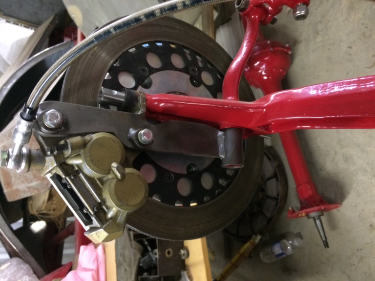

Les Schubert
Posts: 1364
First Name: Les
Last Name: Schubert
Location: Calgary
Re: Speedsters

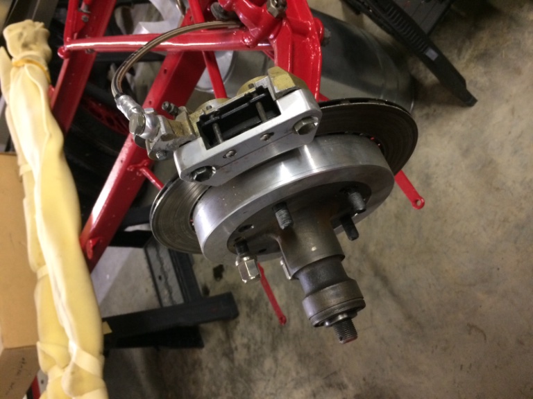

Post by Les Schubert » Tue Jan 04, 2022 2:04 pm

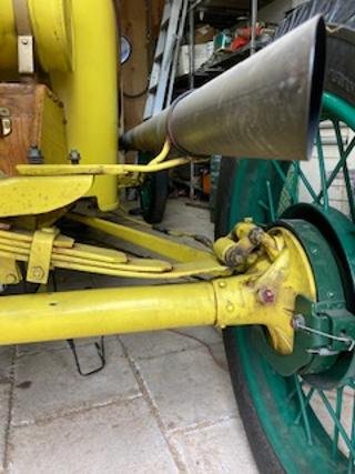

Some pictures of my lowered front axle and front brakes (motorcycle discs)

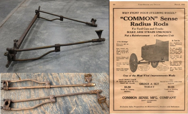

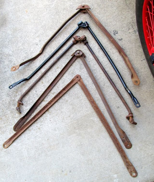

Post by TRDxB2 » Tue Jan 04, 2022 9:27 pm

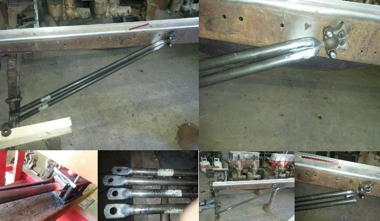

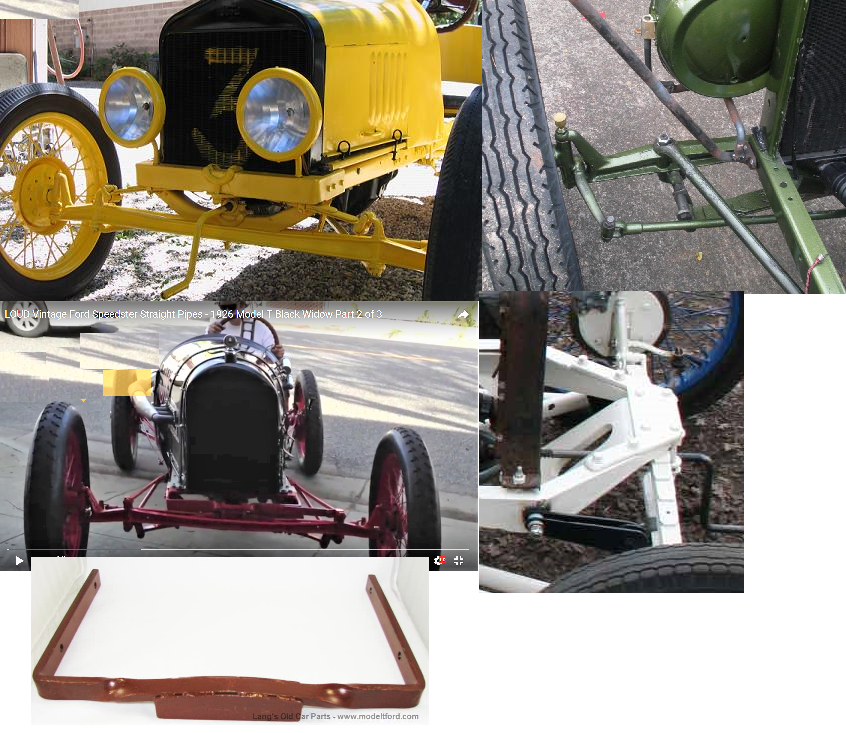

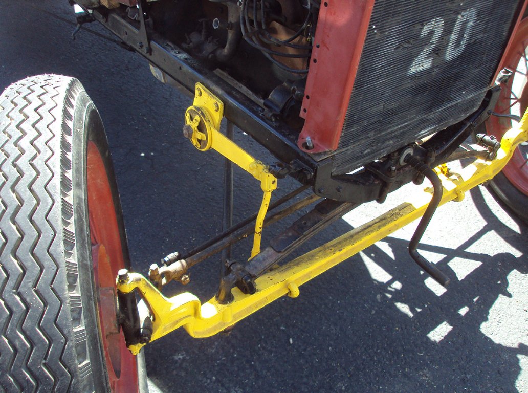

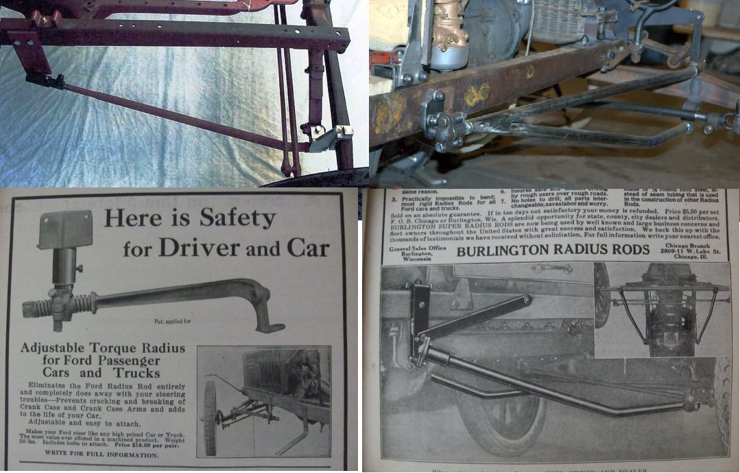

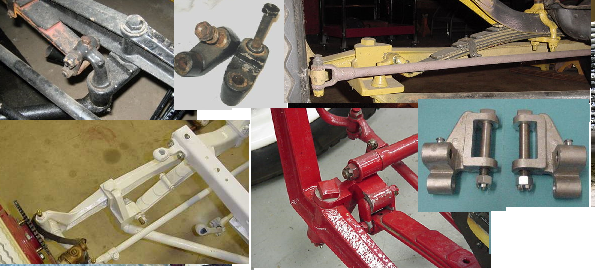

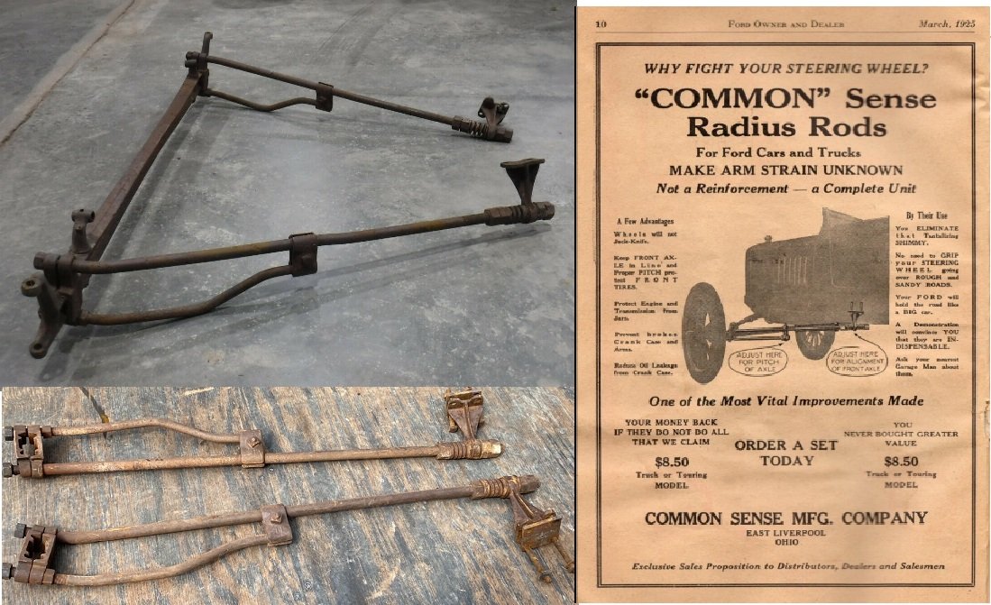

Thought I'd add some ideas for period correct looking radius rods and wishbone supports
HANK s.jpg (83.5 KiB) Viewed 27057 times
AndyClary
Posts: 909
First Name: Andrew
Last Name: Clary
Location: Usa
Re: Speedsters
Post by AndyClary » Tue Jan 04, 2022 10:47 pm
I really like the Common Sense radius rod set up. I’ve missed out on a couple sets but I keep my eyes open.
Andy

My dream Speedster

I found a nice set of those, Andy, and it was just so much weight I decided not to use them. It’s always hard to make that call when you finally find something.

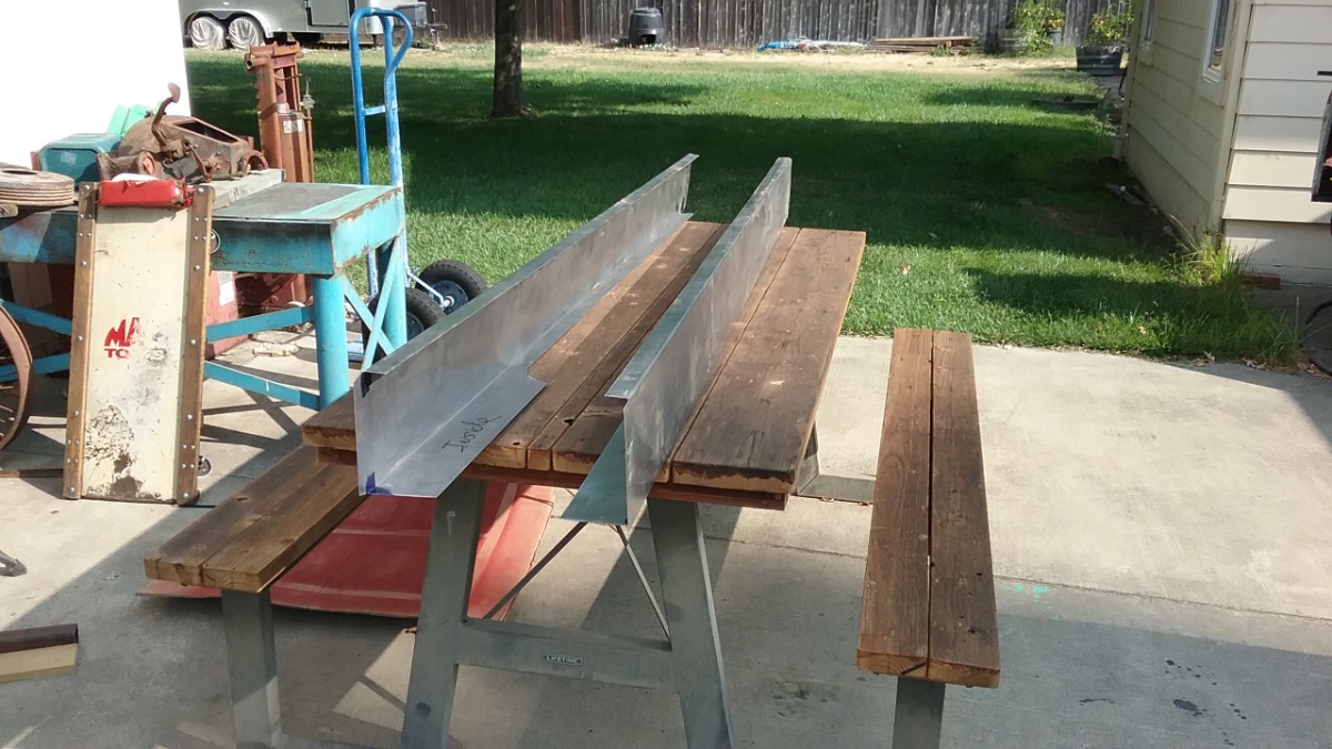

Post by henryford2 » Wed Jan 05, 2022 7:26 am

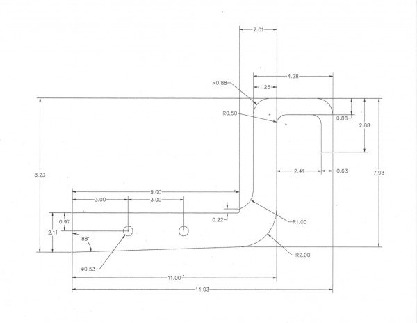

Find some one with a water jet or plasma table and cut them from 1" plate. You can relocate the mounting holes on the side to match the bumper bracket holes on a 26/27 (I think), but not meant to use the heavier 26/27 rear crossmember. It will give you a 5" drop and no need to shorten the driveshaft. No guarantees express or implied, do your home work first. Enjoy, stay safe.
5 in frame drop.jpg (18.18 KiB) Viewed 26953 times

Like Andy, I like the look of Common Sense rods, to offset weight gain the original radius rods are gone, get rid of starter and use an aluminum hogs head, to me the starter and hogs head should be standard for speedster :D .

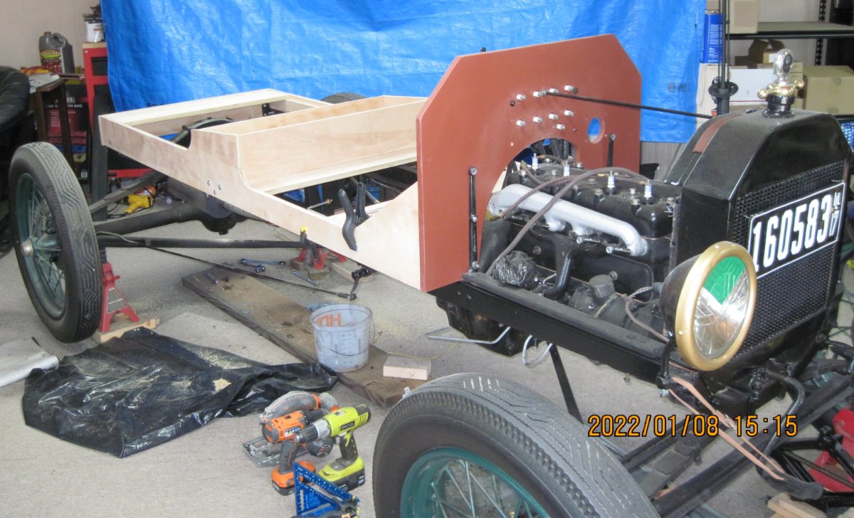

O.K. I'm looking at a lot of speedsters and in many cases I'm not seeing the battery hanging down in it's normal position, for me I will have to move it back to be just in front of the rear frame crossmember as the gas tank will be above the stock battery position, or put it in the tool box/trunk to be built at the rear. At this time I'm not going to Z cut the frame, I have a new set of brackets as pictured two posts above, I think I'll list them in the classified section to avoid temptation. Question is, battery location how and where.

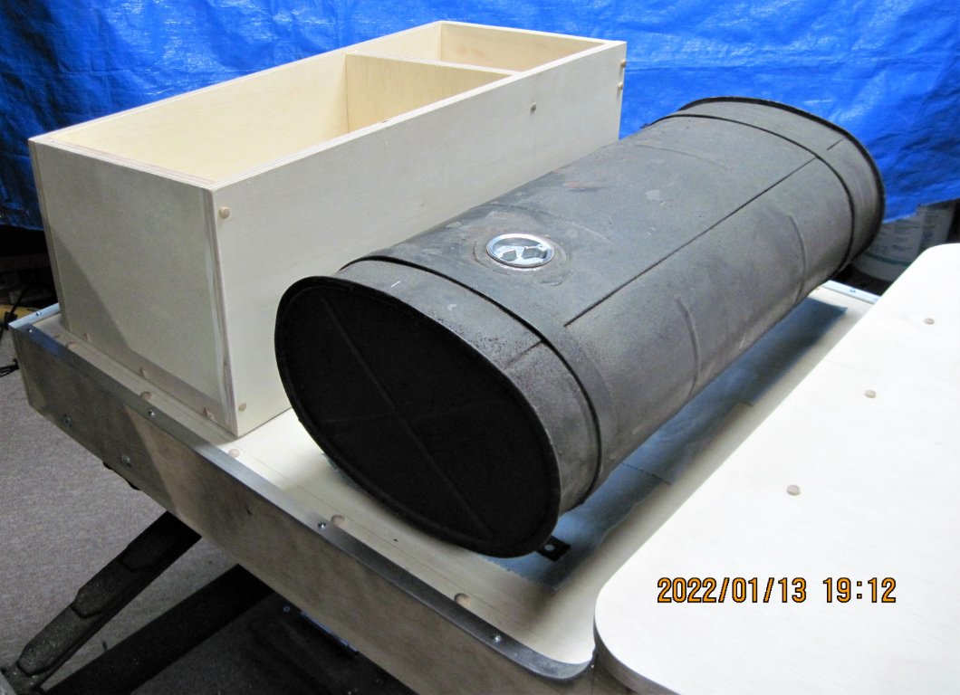

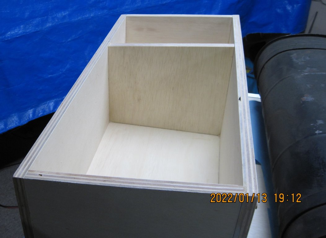

This is how I made a battery box. Two upright boards support the seat. The box extends below them a bit between the frame and the Warford. A standard size tractor battery fits into it.
I was give the optima and it's been working for about 19 years now. I wasn't a fan but hey....
That's horse hair around the minus terminal. :lol:

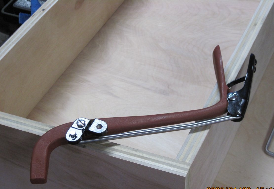

Yesterdays progress , going to get more wood in a bit. Finish dry fit, take it apart, glue and fasteners and reassemble, edge trim and the list goes on.
Replacement top half of hand brake also pictured.

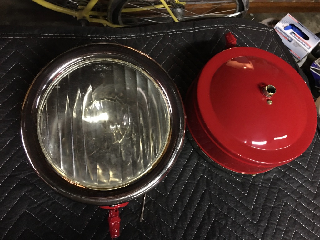

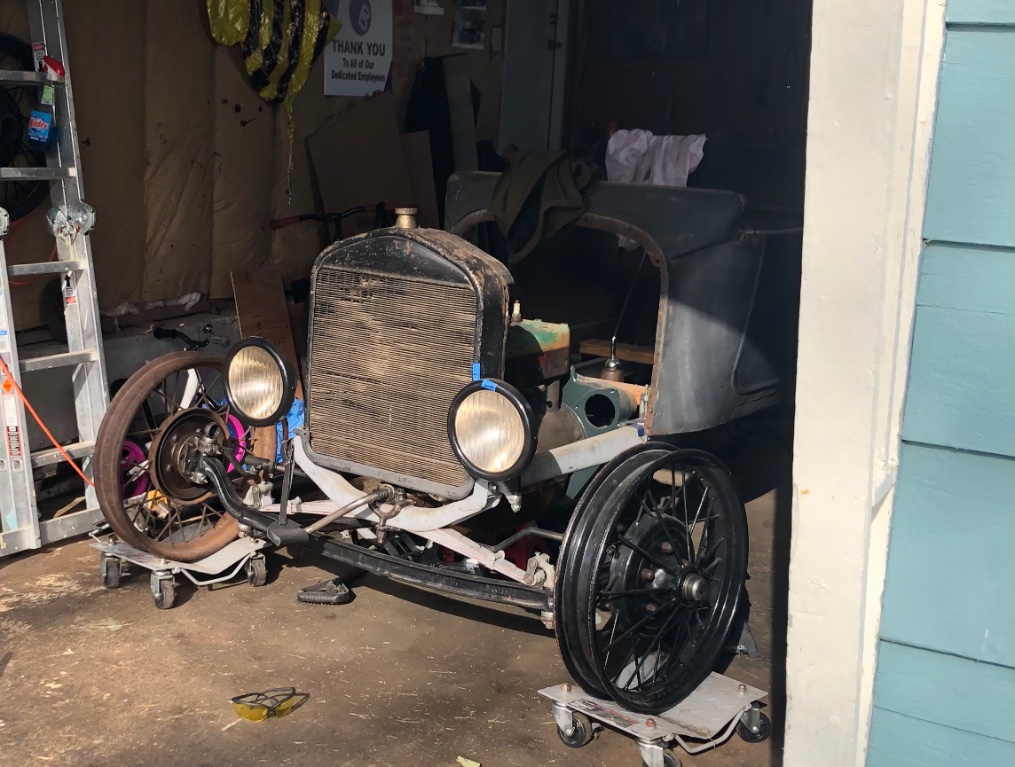

Gratuitous shot of my headlights to keep the thread going.
Andy

Very nice condition drum lights and a period correct accessory.
To expand on my first post, anyone please post speedster pictures, build progress pictures, period correct accessories being used.

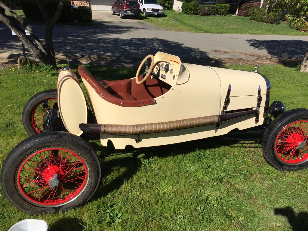

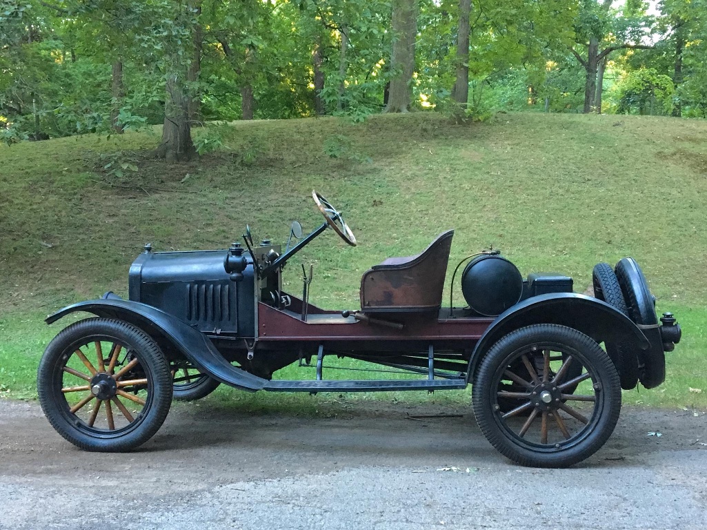

Since the original title talks about lowering, this is one of my favorites.
Re: 'Speedster - photos and thoughts of lowering your car'

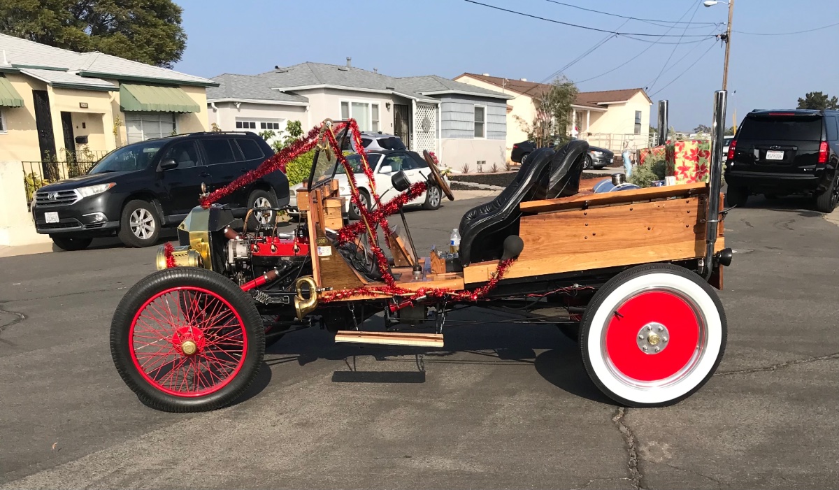

Post by Rich Eagle » Sat Jan 08, 2022 8:02 pm

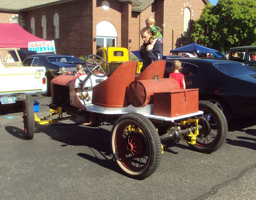

Wow! that's pretty. Here is a version I saw a couple years ago:

A dropped axle is easy though pricey. My car has the 4 inch drop Mercury axle and reversed front spring eyes. It was enough before but I could always use 26/27 spindles for another inch up front. The frame is simply kicked up in the rear and I have a reverse eye rear leaf if I want to drop it a little more. I’m not in favor of the heated/bent rear springs.
In this photo you can see the amount of drop in the front axle. The Mercury uses a stock tie rod, a dropped Ford axle usually requires shortening the tie rod.

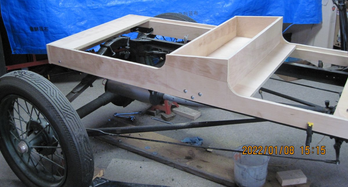

Dean, gluing and screwing sounds good, but may not be. The Ford frame will twist, quite substantially on uneven ground. The body needs to allow for this. If it is too rigid it will try to tear itself apart. The better built commercial bodies built back in the days were mortise and tenon jointed and then screwed. This allowed for flex.

It's a good job that I'm not going to be driving on the roads they had back then (or the lack of),lowering for open road would not be done back then ether, the moment you got to the edge of town the oil plug would be a foot under mud.
With tall cabs and long vertical runs the commercial bodies would be more susceptible to flex, Ford or not that's also the way carpenters did things, if the flex is excessive mortise and tenon will break .
I'm gluing the long side rails together as they are made of two lengths of 3/4" ply, any trim is mounted on one piece overlapping another so a seam is covered but trim can shift over it, I'll start another thread about building, "Speedster- building" :D

That is one of my favorites too. And will be on my next speedster. IIEGTI
Richard,
The hot rod I'm building has quarter eliptic springs. Do you have any idea what those are off of? Very neat.
Craig.

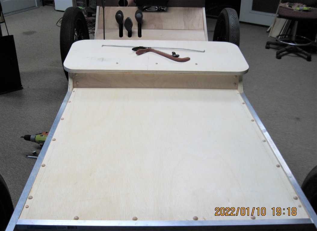

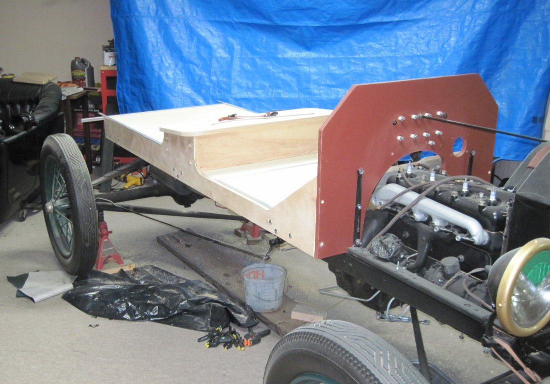

Build progress pictures, this afternoon rear deck, floor (not finished), all body brackets done, seat riser and hinged top, seats will be a week or two.

Looks good Dean. What color are you thinking?
Andy

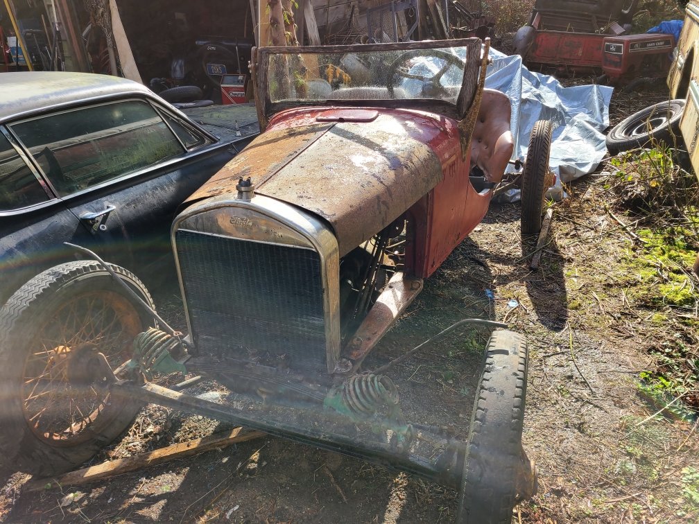

Post by Rich Eagle » Sun Jan 09, 2022 7:53 pm
I have no idea Craig, his car showed up at a 4th of July show and I haven't seen it before or since.
The fellow came form California and and I'm not sure where he is to ask more questions. It was a rather cool setup.

Thanks Andy, at this point I'm thinking light grey. Repaint the wheels black .

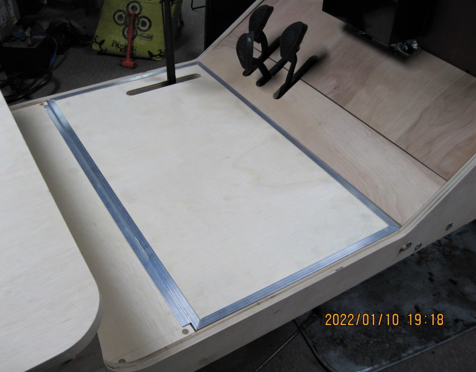

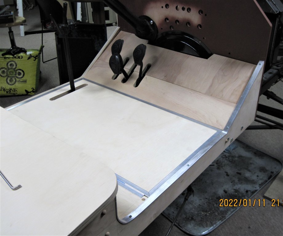

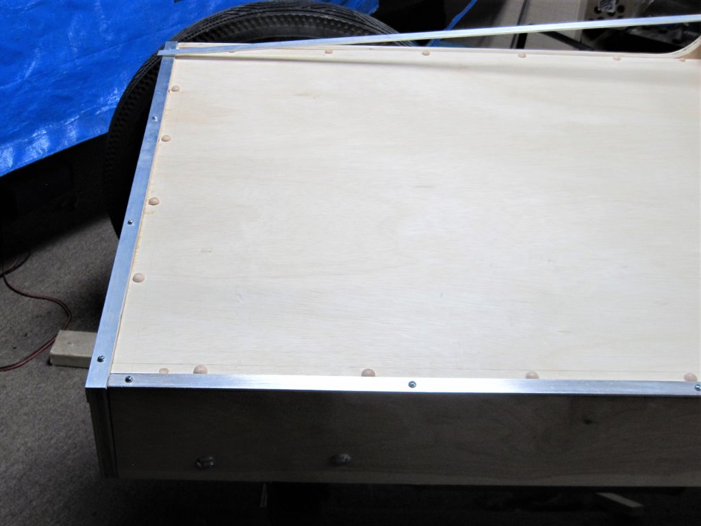

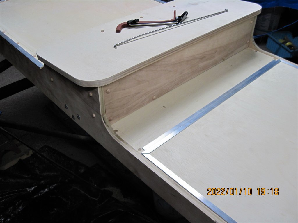

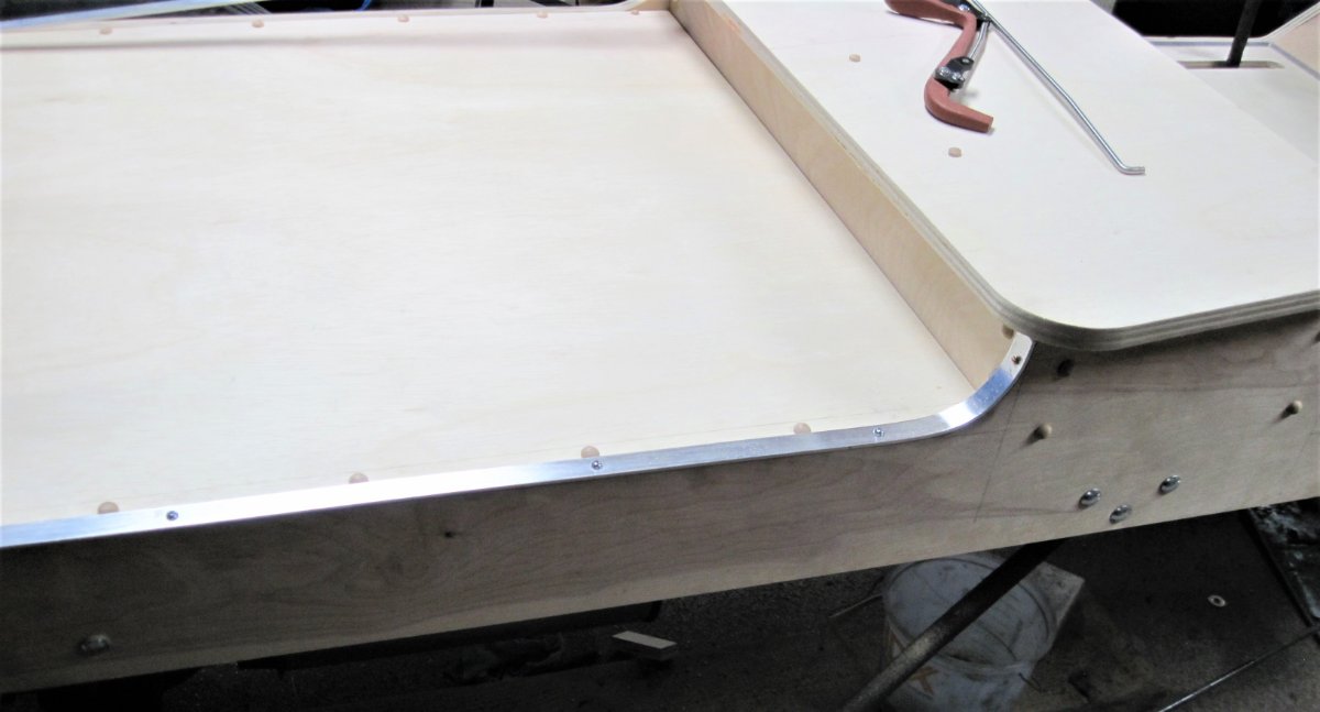

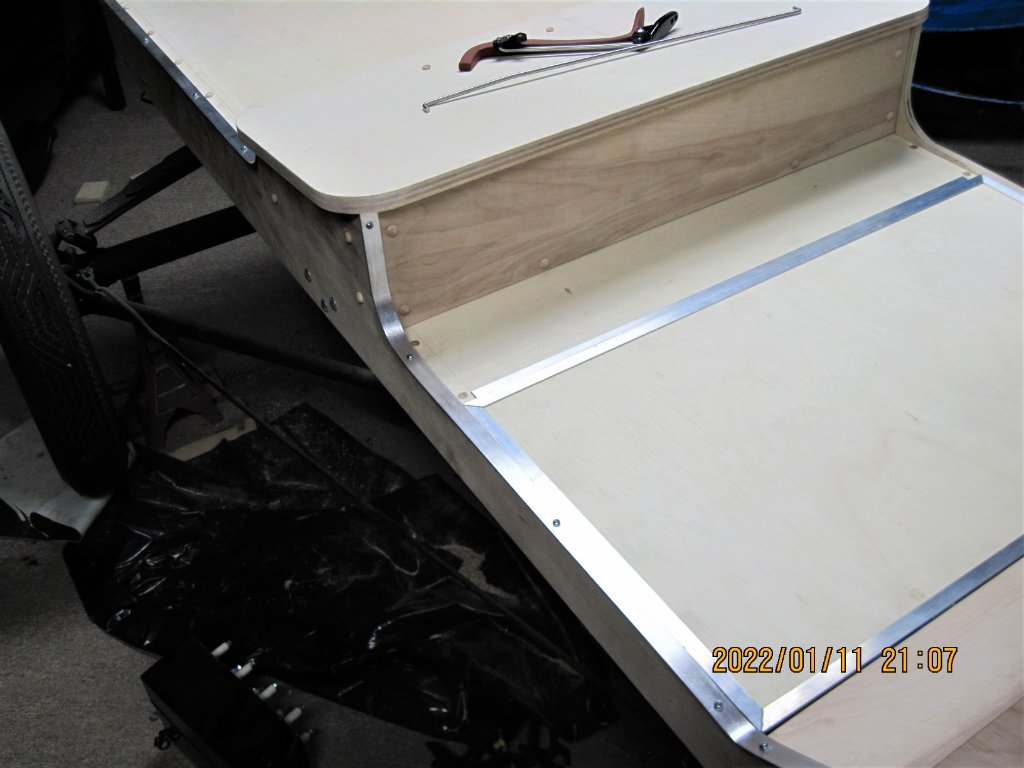

Started fitting the aluminum edge strip, flat bar stock on top edges to protect wood, center floor panel is U channel that adds a little support and protects edges, U channel permits hidden screws. Worked on firewall (dash) and put steering column in to see how much of a wedge I need to make for the 1 1/2" steering wheel drop. Have to chase down some slot cap screws for the trim (fitting with Philips) . Not looking forward to taking this apart to paint.
Craig Leach
Posts: 2034
First Name: craig
Last Name: leach
Location: Laveen Az
Re: 'Speedster - photos and thoughts on lowering or not
Post by Craig Leach » Tue Jan 11, 2022 12:17 am
Dean very nice work.

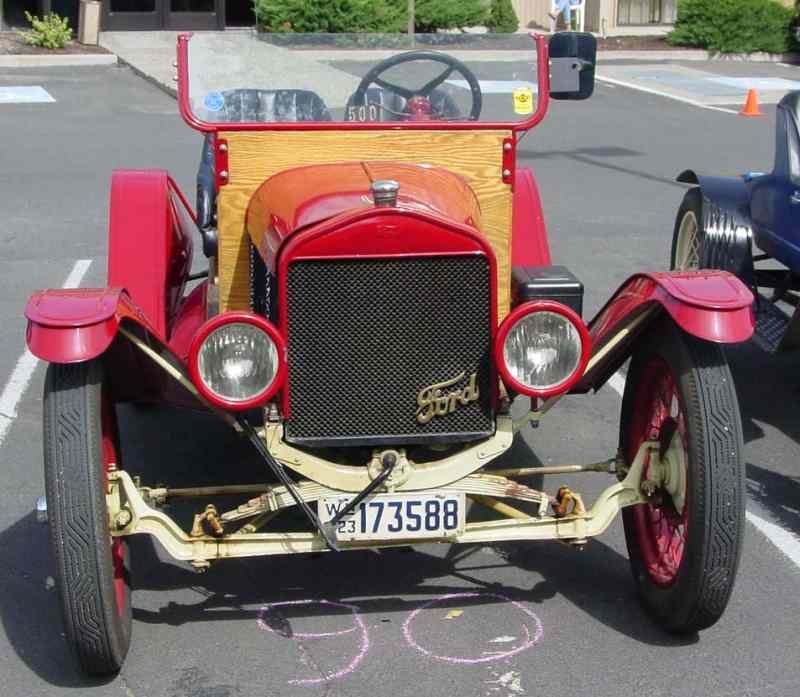

My youngest son and I have a lot of miles of father/son time in our speedster. We put over 10,000 miles on it the first year we had it with 30 miles here and 50 miles there about three to five times a week. If I would have known we would have had such a great time and learned so much during those trips, I would have bought a car 15 years ago.

Very nice, a small thing I like is the use of the hood latches (can't see if springs are on) to hold lower end of hood straps and if springs are still on even better.

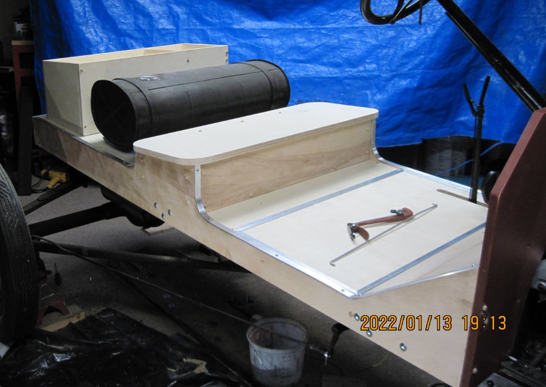

Made a trunk /tool box this afternoon, drivers side is a battery compartment (will coat with epoxy) fits full size or Optima, checking tank location and may make some risers for it (only to clear sediment bowl/shut off), aluminum top trim on drivers side done also. Have to make lid for the box, will make water resistant with a lip all around.
