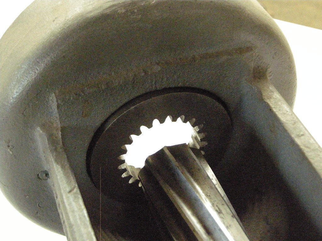

You might want to consider finding someone who has a Dearborn Model T ford transmission drum bushing reamer. and know how to use it. The benefit is the drums are indexed to the newly installed gear pitch circle to ream the new bushings. And if you think about what is going on insdie the transmission that way makes more sense than indexing to any other surface.

I think the idea of the reaming fixture is to ensure the bore is concentric (indexed) with the pitch circle of the gear teeth and parallel to the gear axis. Neat idea plus it holds the drum assembly secure while reaming. Although quality machining will achieve this and all surfaces will run true and straight. Dave’s parts will be spot on. If it was me, and it was a couple of times, I would rather bore them in a lathe. That way everything can be checked for runout. Especially if a person was using old worn gears.

Until someone shows me the fixture for reaming OR boring the new drum bushings on a lathe while indexing the cutting tools to the gear pitch circle I am not convinced.

You might want to consider finding someone who has a Dearborn Model T ford transmission drum bushing reamer. and know how to use it.DSCN2006.JPG The benefit is the drums are indexed to the newly installed gear pitch circle to ream the new bushings. And if you think about what is going on insdie the transmission that way makes more sense than indexing to any other surface.
Ron Patterson
That's a wonderful looking fixture. I must say however, that in manufacturing, it's very poor practice to modify/correct the location of a bore with a reamer. Reamers are notorious for following the bore they are enlarging. How well is the reamer supported by the fixture? How close a fit is the reamer shank to the fixture? Not trying to be contrary. Wish I had one of those!

this will answer all of your questions: http://www.mtfca.com/discus/messages/17 ... 1325030711

Yup, that's a great fixture and those reamers should indeed recenter the bore. Not your garden variety reamers to be sure!
