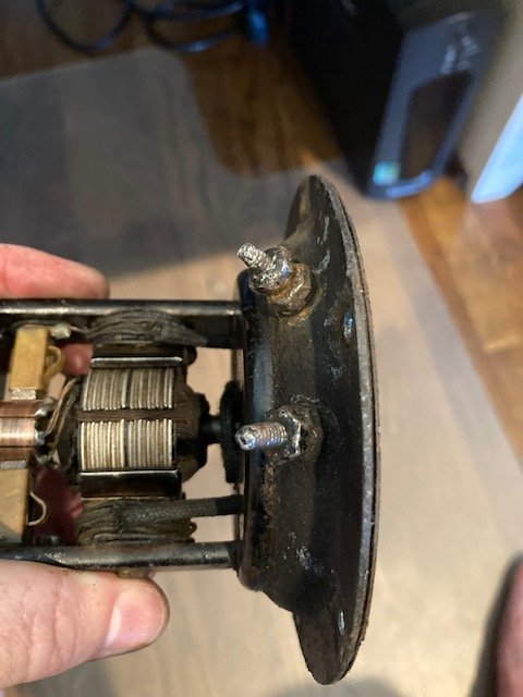

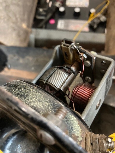

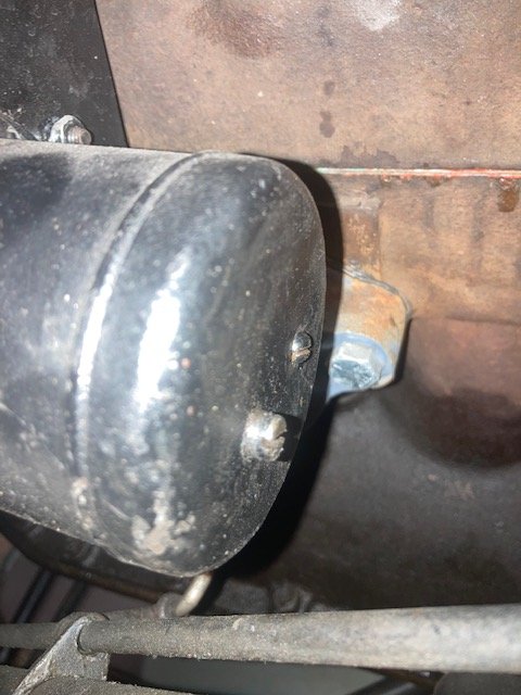

There are 2 screws at the back cover pictured. The smaller one towards the engine seems to hold on the cover and level out the back support in a see-saw type way and the other bigger one closest to the camera seems to adjust it, somehow?. If I put the cover screw on all the way tight and adjust the err bigger adjuster it kind of works. There is voltage drop when it doesn't work. No voltage drop when spinning. If I put the cover screw on loosely it spins well but doesn't make sound. Confusing.

The armature could use a cleaning as well as getting the junk out between the segments. Check that both brushes have free travel & spring tension.

If the bearings are worn and allowing the armature to drag, the horn will not work as it should. Be sure the shaft is not bent.

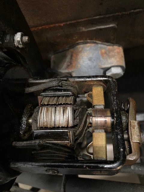

There appears to be gunk that is probably conductive bridging from segment to segment of the motor. This bridge is shorting the motor, causing a heavy current draw to overcome it.

Thank you, it looks delicate, how do I clean the armature and segments without damaging it?
Posts: 5587
Re: Ooga is Iffy.
Post by RajoRacer » Thu Jan 20, 2022 11:14 pm
Use fine sandpaper on the armature - hold a piece with your finger and hand turn it. Looks as though there is a flathead screw holding in each brush so carefully loosen it and watch so see if the brushes start to release - there's a spring behind each brush so try & keep the work area confined so as not to have pieces fly out. There is spray electrical cleaner available at the auto parts store so squirt each brush & holder & reassemble - it's not a tough job BUT if you're uneasy about the task you can send it off to me & I'll inspect and clean it at no cost !

One screw in the back holds the cover on, the other one adjusts the diaphragm. They are very sensitive and change dramatically with temperature. Oil the motor, clean the armature and it should sound fine.

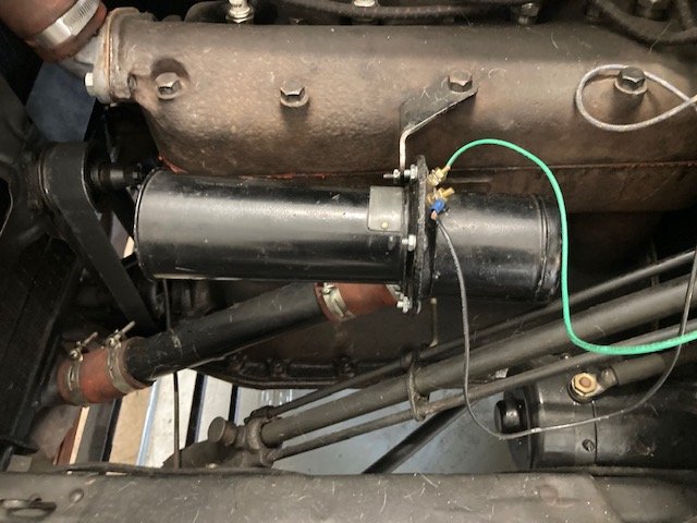

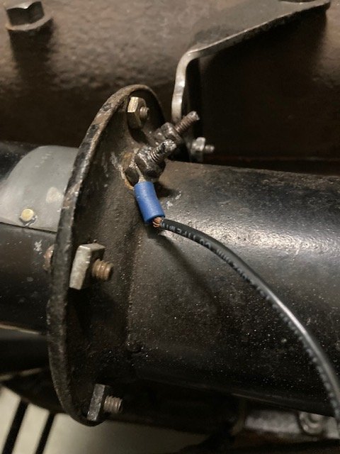

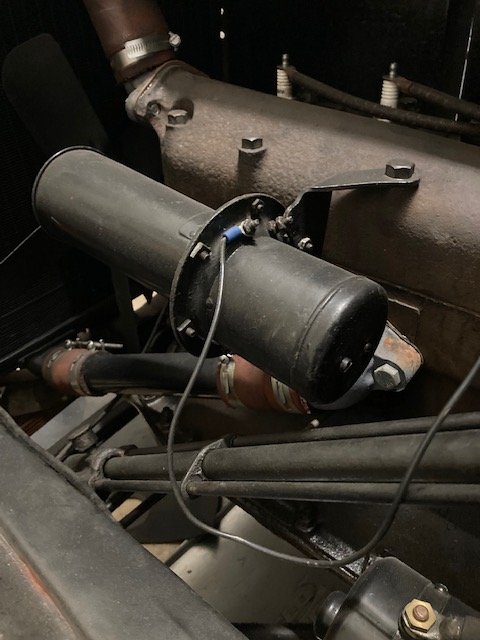

It worked great for a Sunday drive a week ago then this Sunday it is back to iffy. The post that the wire is on is probably the problem. I wiggled it and it temporarily worked again. If I tighten down the bottom nut so the post is not wiggly it sparks but does not work at all. If I back off the bottom nut and make the post wiggly then it sometimes works. What should I do? I would like to avoid taking it all apart again.

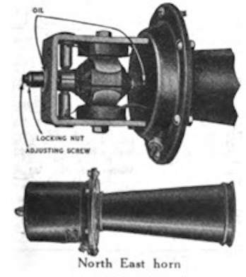

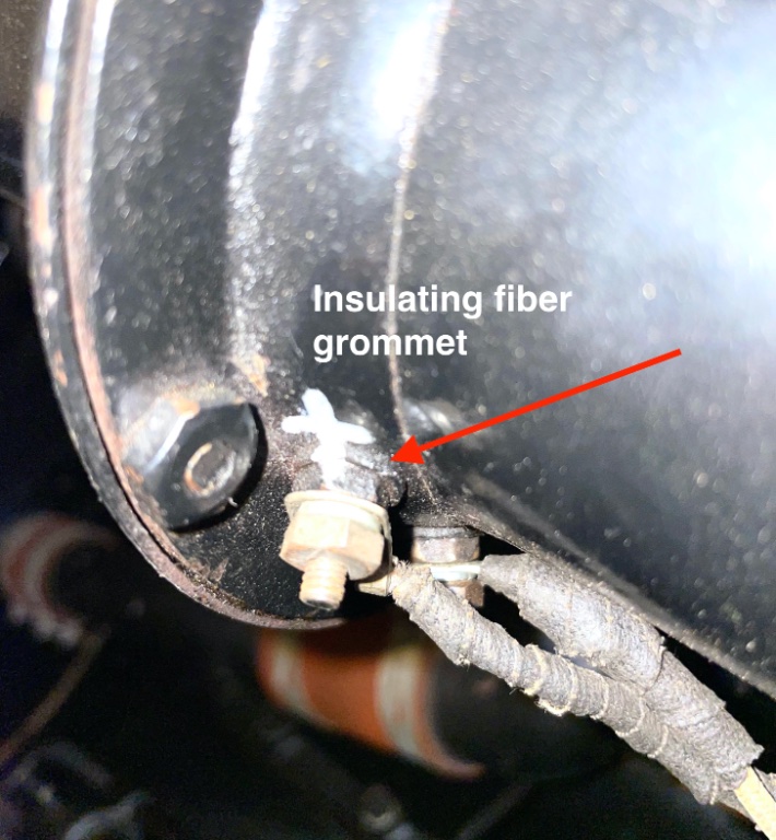

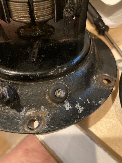

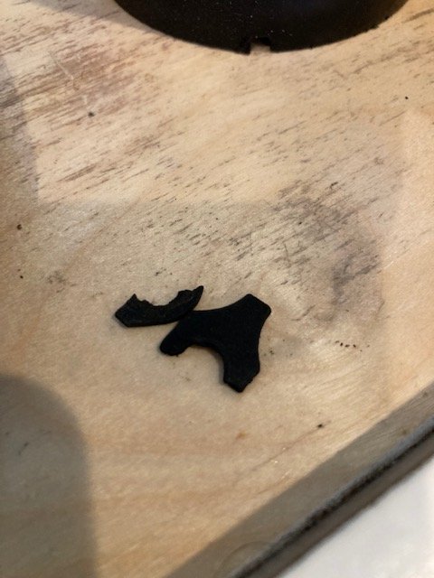

The cause is perhaps the insulating grommet at the positive terminal is frayed or gone now, so best to replace. The horn would have to be taken apart again. You could try to carefully remove the locking nut and try to stuff some string around it, but likely would just pull the terminal wire that is soldered inside away.
With electrical posts that have threaded terminals to attach leads, the first nut is the lock nut. That has to be held firm in position when you apply the lead wire, and when you apply the upper nut to secure the lead, otherwise the terminal can be separated.
BTW, your hot wire to that terminal using that plastic crimp lead has exposed wires, those could contact the horn cover and cause intermittent honks!
Yours seems to be a NorthEast horn.

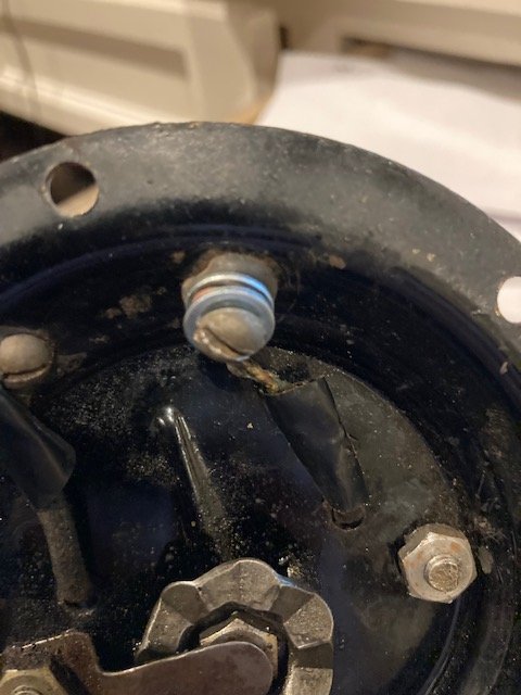

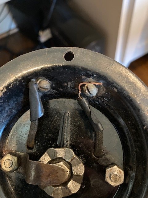

Thank you for the advice and help. I opened it up and crumbled insulator fell out. More than is shown in the last picture. Where might one obtain or create an insulator grommet for this?

I would head to your local ACE Hardware & check through the fiber washer assortment - you'll need 4 as they go on both sides.

Thanks, If using fiber washers what keeps the wire part going through the hole from possibly shorting on the rim?

Heat shrink tubing.

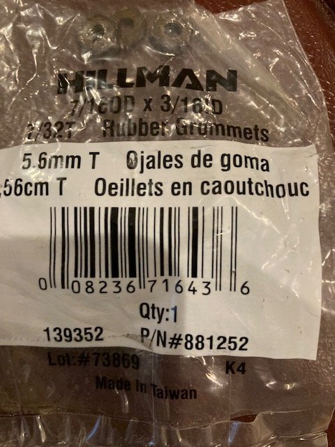

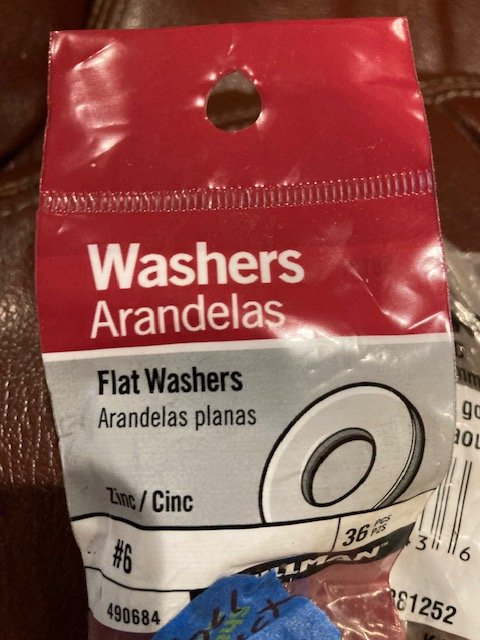

So I found a rubber grommet at lowes and some #6 washers so I hope it works. I couldn't find any composite or hard felt washers.

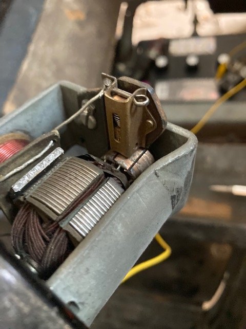

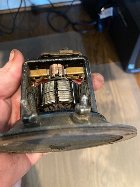

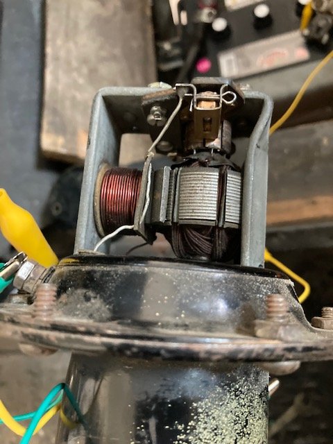

We've finally come to the conclusion that there is an intermittent short in the motor winding. It isn't obvious where the short is. Does anyone know how this can be fixed?

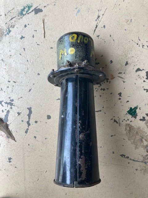

Steve was able to locate and fix the intermittent short as well as replace all the grommets. I also have it grounded properly with the green wire and used a cone wrench to keep the grommet from having an issue. Loud and proud again. Now I have another one that I bought at Chickasha 2 years ago. It says 'Loud' and '$25' on it. Nothing comes out. The inside doesn't look the same as the other. There is no label on it. I tried it on 6v and 12v nothing. It does not spin. What is this horn and perhaps what might be wrong?
Posts: 6789
Re: Ooga is Iffy.
Post by Scott_Conger » Sat Apr 16, 2022 9:32 pm
I don't know what brand it is, but I do know what's wrong with it...
Steve hasn't seen it yet
