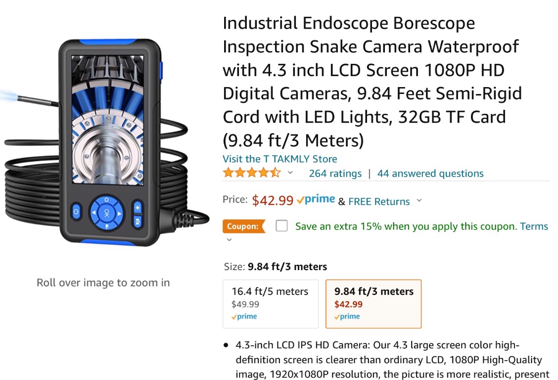

I bought a bore scope camera last year, it has an led light on the end of the cord wand, has attached screen. It is wonderful- I use it for all kinds of stuff. I inspected my hogshead, engine internals, rear end gears too. Technology is getting cheaper and cheaper. A bore camera is a must for any toolbox, especially when the cost under 60 bucks. Lots of different names, all made in China, but mine is an Lonevo brand.

The endoscope is on my wish list. It is something I hope I never have to use it, but in the very likely event I will will be needing it.

I bought a borescope with USB that merely plugs into your laptop computer, six foot cable for less than $20. It has an adjustable light on the end and you never have to worry about the electronics going bad. Plus you get a big screen.
