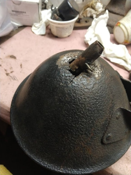

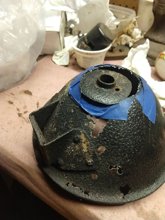

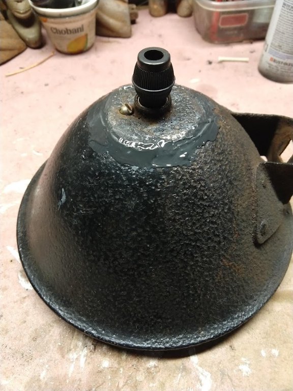

I have two poor condition headlight buckets. Both have lots of rust. One is like swiss cheese. So until I can replace them (Hershey?), I thought I'd do a "repair" just to get something working. Sorta like what they "might" have done waaay back in the day. I took the center piece out of one bucket and JB welded it to the other one. Not great looking, but until I can get to replace it, it works for me.... for now.

If that’s an early 26, I think I have a complete one here ( single) in pretty good shape. Tmorsher@icloud.com And yes, anything with JB weld is cheesy and temporary, at best. jMHO

That bucket needs to conduct electricity, you may need to run a ground wire to the focus screw.

Nice coat of paint and you would never notice it 8-) But as said only temporary, it wouldn't last another 100 years. :D Now if you put some flex seal on it :idea: JK good temp fix but you will need to ground it.
