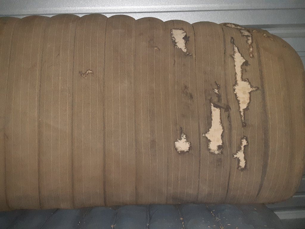

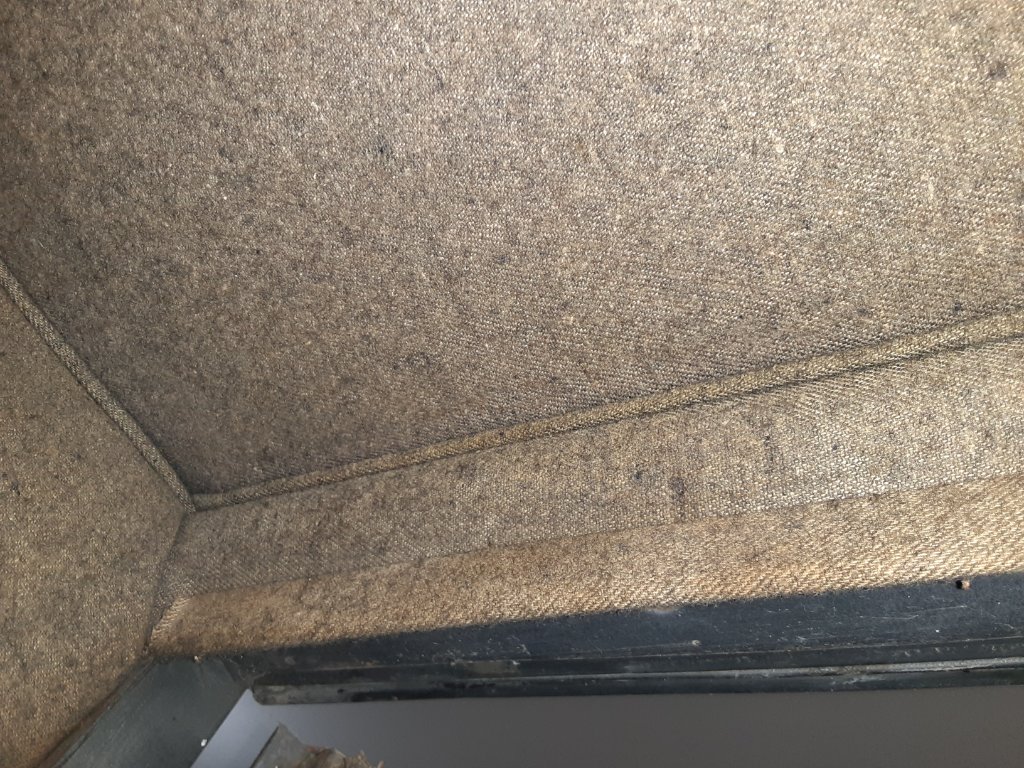

I recently had to pick one of the three options for the upper fabric for my 1927 coupe. I chose the one that has a small pattern because looking real close at my fabric I saw a pattern as shown in the attached photo. The top material in the photo does not seem to have the pattern. I think you have to pick one material for both the upper and headliner. I might be wrong, maybe you can pick one for the upper and another for the headliner. You might ask Mike.
I also picked the white stripe material for the seat because that is what my coupe had as shown in the other photo. My understand is that the green stripe was used on the 1926 green cars and red stripe for marron cars but then a white stripe came to be used for the 1927 cars so it would be compatible with any color car. This information is page 403 from Bruce McCalley's book,

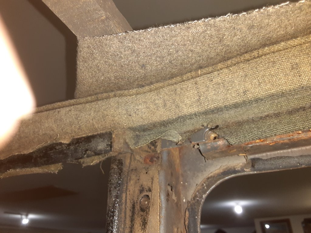

I have correction to make regarding the headliner in my earlier post. I just found a photo of the same location that shows it to be the same material as the material just above the door. Here is the photo.

Bruce, your pics are very helpful. It is neat to see there is still fuzz in the corner of the fabric that was hidden behind the window trim.
Scott, thanks for pointing us to the fabric sample pics. Based on your sample pics and Bruce's pics, I'm thinking the light or dark gray fabric might be the two to choose from. The third doesn't look close.
