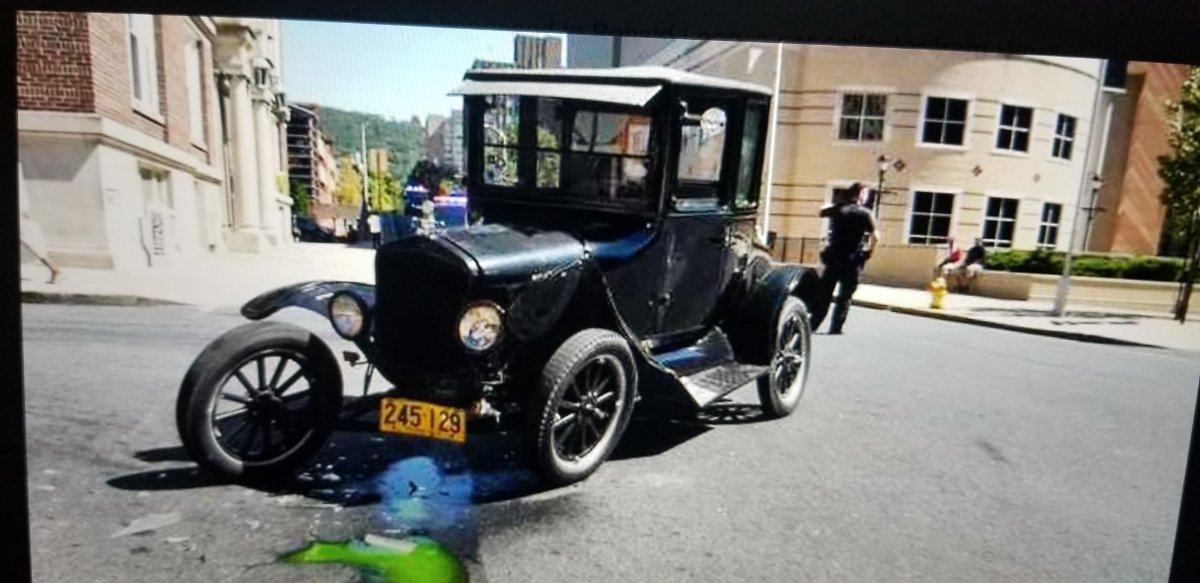

I’m looking to buy, borrow, or take some pans to a pan straightening jig near eastern Pa, Southern NJ or Delaware. Anybody know of one in my area? I bought that ‘24 Coupe that was involved in a crash, near Reading Pa, a few years ago. The frame is toast and I’m expecting that the pan also got tweaked in the accident.

Taking a few pans out to Kevin Prus may turn out to be my best option if I don’t come up a solution. Metal working is just something that I happen to do everyday, so I feel fairly confident that I could tickle this bugger back into spec if it is out.
