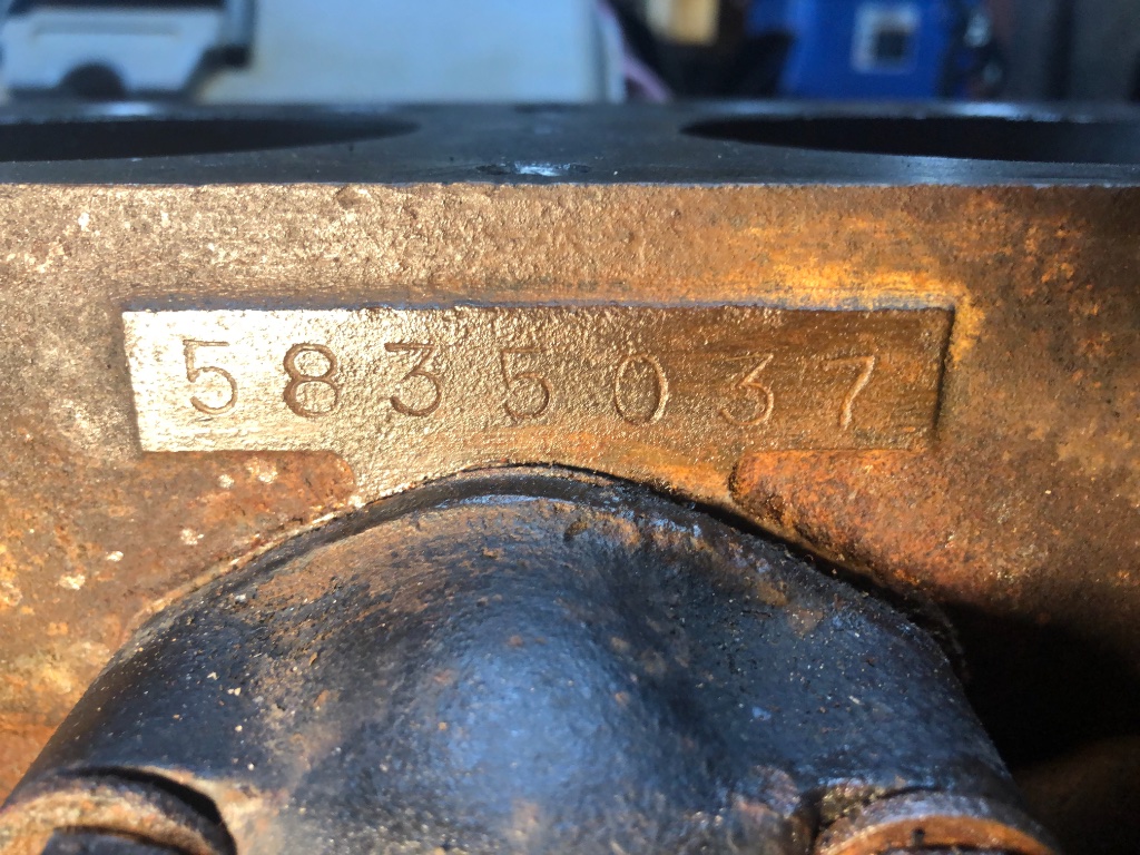

Recently I bought a 22 touring car which Tom Pilz, George Reamy and I have been working on. Today we are going to finish with the valve ‘job’ we’ve been working on and hopefully soon we’ll hear the engine humming again!
I know this car was manufactured in early to mid April according to the serial number on the engine which I have added to this post. We are pretty sure this is the original engine that came with the car.
Is there some way to find the exact date for the car’s birthday? I’d like to have a hundred year party for her and invite other T’s from across Long Island to join in the festivities. My TT will be there and I’ll bet Tom will bring his.
Here’s the engine pic

Post by Mark Gregush » Sun Jan 09, 2022 9:43 am
April 4, 1922

Post by DanTreace » Sun Jan 09, 2022 9:43 am
Bruce’s lists gets you there, your engine was finished and tested April 4, 1922 4,176 engines made that day.

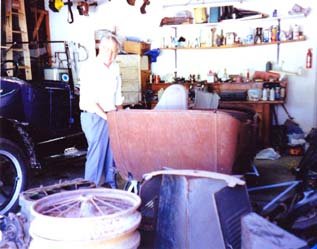

Post by Norman Kling » Sun Jan 09, 2022 3:50 pm
If you want the exact date the car was sold and first registered, you would need to find a car which has been in contact with someone who knew the original owner or the family and who has the documents available. Even so, many cars have had the engines changed with " rebuilt" engines or earlier with factory replacement engines. My grandfather drove from Los Angeles to Plymouth Rock and then back through Ontario Canada and finally back to Los Angeles He did this in 1926. Somewhere along the way they broke the crankshaft and was towed into a Ford Dealer, who replaced it and next day continued on with the trip. I doubt very much that the crankshaft was replaced in the same engine that fast. Most likely a replacement engine was installed.
And so, unless you have documented history, you will likely never know the exact date. Here is a pile of parts which became a 1926 Ford in my garage. Most of the parts are 1926 or compatible with 1926, but unlikely originated in the same car.
