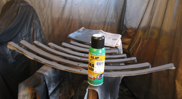

Perhaps for springs on the car, but not the method for springs that are off the car and taken apart. Best lube during restoration is to coat with slip plate available from farm stores to the wear surfaces of the spring leafs, let dry, assemble the springs, then paint with black. Lasts for years. A bit too much lubrication for the first couple hours driving and rides like a bucking bronco at first, but settles down nice and smooth, and stays that way. Oil or grease however, stops working rather soon, then starts rusting and squeeking.

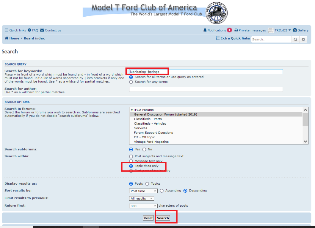

GOOGLE lubricating springs MTFCA

Searching via MTFCA Advanced Search https://mtfca.com/phpBB3/viewtopic.php? ... gs#p201723

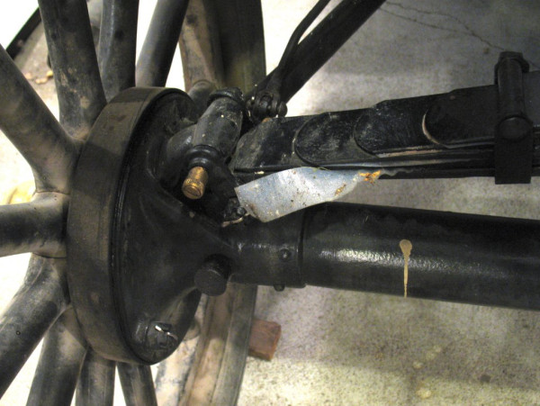

Reading on the forum about UHMW tape I thought it sounded wonderful, and used it.
This was the disappointing result.
For the next spring I assembled I used Slip Plate graphite. No problems so far.
