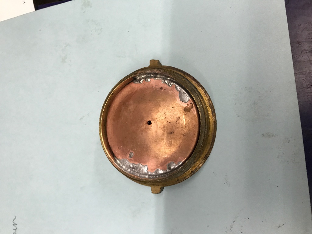

I have been working through systems hoping for drama free starting, took out gas tank to clean and re position-- the filler tank had rotated so the seat tin covered the filler cap 1/2 way, in looking closely the gas cap has no vent, what was used for vent ?

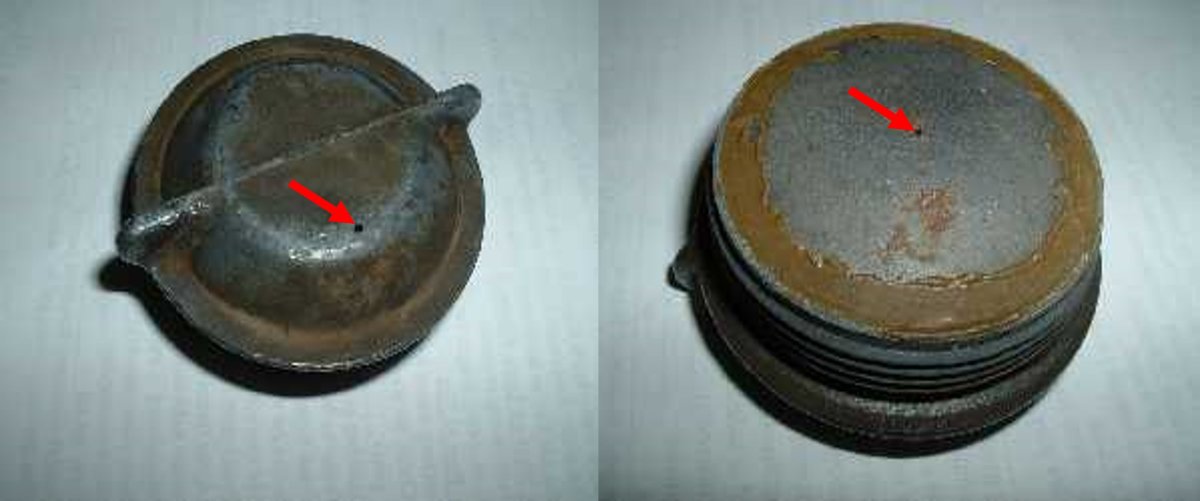

My 1924 has a gas cap like that, there is a small hole in the top casting and a small hole in the bottom splash shield. The holes are intentionally out of alignment to reduce the chances of gas splashing out of the cap on bumps.
The holes looked too small for my taste, so I drilled them out to the next size up.

There's no baffle inside mine, got some roofing copper, I'll solder it in and make a baffle is what I am thinking---

The hole on those caps was on the small flat side of the butterfly grip and then at 90 degrees on the inside, no baffle on the inside, common on Canadian T's.

It's brass, and yes English Ford, I remember now, had a 48 prefect with that cap.
I made a baffle, drilled both ears at angle into top, formed piece of copper roof flashing and soldered it in --- going to be good enough
I think in the 60s it was being sold as replacements, the coils have 1963 dates, I figured this car got a "60s" type restoration, mostly paint on decent body

If it were me, I would get it nice and hot and flow more solder in to fill the gap a full 360 degrees around the circumfrence.
- Posts: 7131
Re: Gas cap
Without soddering all round, there is hardly a need for the vent hole in the baffle.

I had a reasonable press fit, but didn't want to ever find it over the feed, as I was soldering the thought came to me that with 2 vent paths the chances of total loss of venting became a lot less--- being it's a stock 17 I have to think of any problems the starter might have.

Excellent! Didn't look at all like brass in the first photo.Kurt in NJ wrote: ↑Fri Jan 07, 2022 4:40 pmIt's brass, and yes English Ford, I remember now, had a 48 prefect with that cap.
