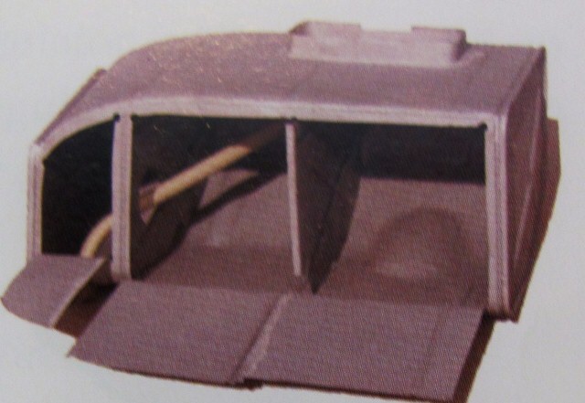

Be aware that there are baffles in the 1926-‘27 cowl fuel tank that may inhibit the the introduction and removal of screws or pebbles meant to agitate the rust out from the right and left most compartments through which the only access are holes. These baffles were designed to prevent sloshing of the gas on the rough roads of the time. That is why I used Muriatic acid to clean out mine. With all due respect, I feel acid does a much more thorough job. By the time the acid does its’ job the interior walls appear to be white blasted. Jim Patrick
