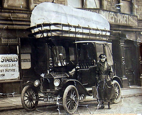

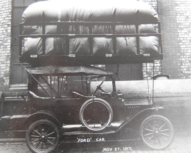

Apparently they an on Coal Gas too ( coal gas contains calorific gases like methane (35%), hydrogen (50%), and carbon-monoxide (10%), along with other volatile unsaturated hydrocarbons formed by the destructive distillation of coal.).
http://www.mtfca.com/discus/messages/25 ... 1349027889
