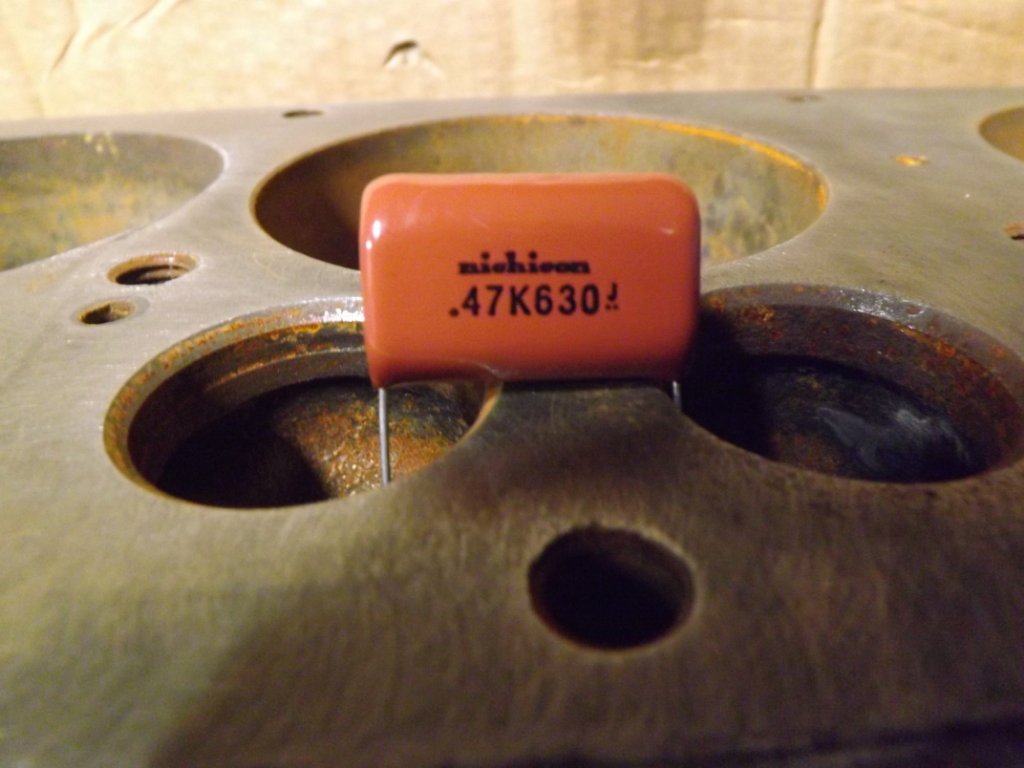

The Model T Ford Coil Capacitors available now were designed and produced by a very competent electrical engineer with many successful products.
It was specifically designed to fit in the coil box space and still allow the partition to remain in place!
Competent - having the necessary ability, knowledge, or skill to do something successfully!

I hope you are not saying the so call Orange Drop type we have been using for years (that do need the divider removed) are not up to snuff?
As it is, seems to be a stock shortage at some suppliers. The new type, when I checked a little over a month ago at Lang's, was out of stock, and Chaffin's was still working on getting setup to sell them from the main supplier. Snyder's does not list them online, the last ones we got into the shop were still the Orange Drop type, but that was a while back.
If that is still current information, re supplier chain, where can we get the new type?

Mark, there is another serious capacitor specification, the working voltage and it has to be 600 Volts for use in a Model T Coil.
They were being used in radio and television sets in 1960, when I first got involved with them.
They worked fine for Model T coils, but they don't seem to be available.
They were replaced by a reddish brown smaller thinner capacitor that may not be available now.
Transistors lowered the required working voltage to 200 volts.
I just did an Internet search and found lots of those.

The mfd specification for the Model T Ford capacitor changed slightly over the years over the years of Model T production. .
A Ford archive reference (Circa 1926) can be found in the "encyclopedia". The capacitor value is stated as .4-4.5 mfd.
I have three Circa 1915-18 (“Red Brass”) top coils that were found in a Vermont Ford dealer’s stocks in the 1950’s. They are like new and apparently never been installed in a Model T car. These capacitors have infinite DC resistance and measure .60-.62 mfd Capacitance
The part sourced today and recommended for replacement of Ford coil capacitors are .47mfd (high dV/dT) which is the closest value commonly available without having to have them custom made.
When measuring capacitors, they should be removed from the coil circuit as the capacitance checker readings can be affected by the coil windings.
Finally, beware of Metalized Mylar type construction capacitors as they won't last long the the Model T Ford ignition coil circuit. I say this because I am suspicious the Michicon capacitor pictured above is Metalized Mylar?
