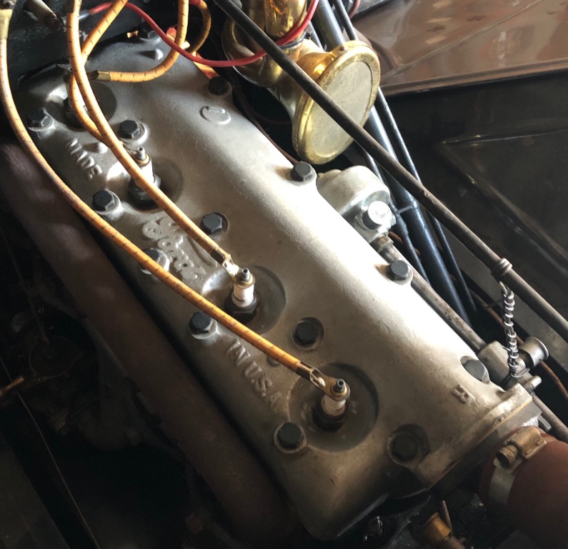

Hello Everyone,
My name is Brian. I am a new member.
I bought a 1915 touring car last year that has an after market aluminum head on it. It has the Ford Script on top as well as the “made in the usa” and also a letter “R” right in front of the coolant outlet. I am trying to figure out which head this is but don’t see it in any of my catalogs.
Does anyone know what head this is? (who makes it? compression ratio? discontinued product? what the “R” means? etc.)

can’t figure out how to paste a photo yet in this forum. I’ll keep trying.

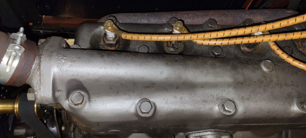

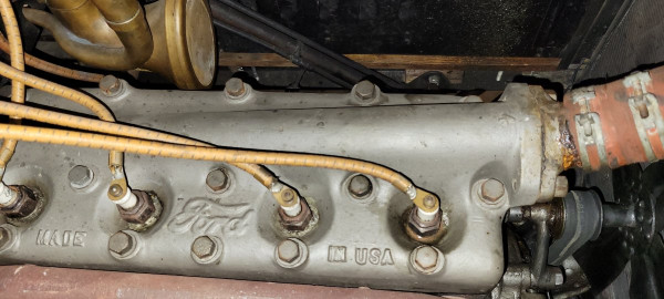

Yea! I figured out how to upload photo. (There was too many pixels tall and wide from iphone photo and had to be cropped to upload). So now with photo, what do you think?

you can see (maybe not in photo) where someone modified tge dashboard to accommodate this high head because the original car had a low head.

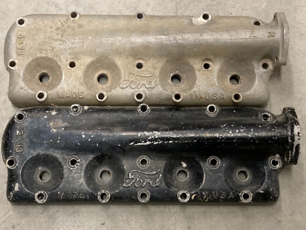

Each of my Reeder heads also have a 4 cast into the water outlet.
- Posts: 7279
Re: Aluminum Head Identification
Keith, your photo confirms my memory of the lack of Ford script on Reeder heads. The casting sprew mentioned earlier is there too.

Early production Reeder low heads had Ford script. I have 4 of them. Reeder dropped the script after Ford found out and wanted money/royalties

Both my Reeder heads have the Ford Script.
Ditto what Jeff said.

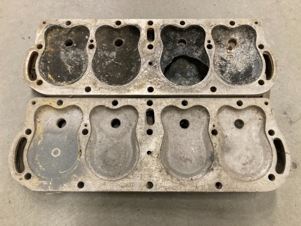

Kevin, Is the photo of the alloy head in the photo a Brown or Reader head? Is its combustion chamber shape the same as the head with a #2 on the neck in the photo below which appears a recent head offered by an unknown maker? Does anyone have a photo of the combustion chamber of one of these heads?Kevin Pharis wrote: ↑Sun Jan 09, 2022 8:46 pmYears ago, Ron Brown here in califunny produced high compression aluminum low heads. They also had an “R” at the water neck. His heads were really light, and his earliest production version was even know to leak a touch of water after a bit of use...
The reason for asking is I'm looking around for a head with a shallow combustion chamber to modify for use on a sleeved-down 4.437" bore 122 CI flathead racing engine which was either built with Green Engineering pieces or built by Green. I'm aiming to end up with something with a combustion chamber close to that used on a Green racing head 2nd photo below.
If you haven't seen the engine check here @ viewtopic.php?f=2&t=26805

Since the Green pistons are flat (or nearly flat), the Green head must have had a heart shaped combustion chamber similar to that of a Model A. The standard T pistons have a 3/8 flat top dome, and so all will have a cavernous hole in the head to clear. I would imagine that an aluminum head would require a couple pounds of filler rod to close up the combustion chambers enough to accomplish the desired compression ratio.
Seems like a new casting might be effort better spent...

- Posts: 4085
David
Here's the adv. page on the Green racing head.
Also, here is info from 1917 on the first write up on that style. Note the article calls it "Hudson" head, but the mfg. is Green Engineering.

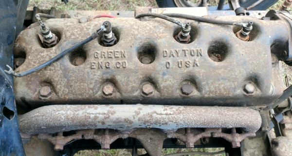

And here's a photo of one on a T engine, friend had this car at his shop, but the owner wouldn't part with it.

Kevin, Thanks, I was thinking of a different approach than filling combustion chambers with weld and then machining them afterward.
Some of the low head HC alloy chamber photos I've looked at recently appear to be fairly low over the piston. What I've been thinking of is CNC milling the chambers over the piston until they are smooth. Machine a round squish pad insert to fit it and then cut off to the same width as the Green squish pad on the left hand side of the chamber and weld it to the head after pre-heating both and keeping them hot. If that is a success, then mill off whatever is safe to from the bottom of the head to further raise the compression ratio.
