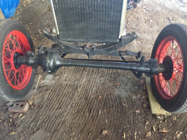

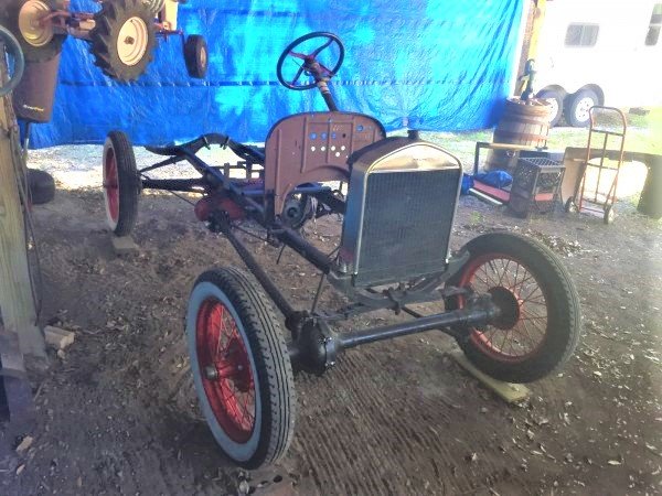

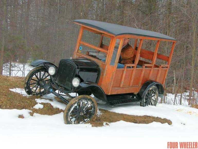

I drove that one pictured a couple hundred feet to the street and back. Got out and told the seller that there was something really seriously wrong with it. He fluffed me off, got in and proceeded to get it stuck in his yard. My elderly father and I pushed him back onto solid ground and both walked away soaking wet.
Perhaps I just drove a lemon, but that took care of my desire for one, forever.
Dropacent
Posts: 3384
Last Name: Morsher
Location: Norwalk Ohio
Re: Livingood 4x4 conversion for Model T
Post by Dropacent » Sun Jan 09, 2022 6:02 pm
And by the way, that pretty body is white pine assembled with drywall screws. It’s a hundred footer, for sure!

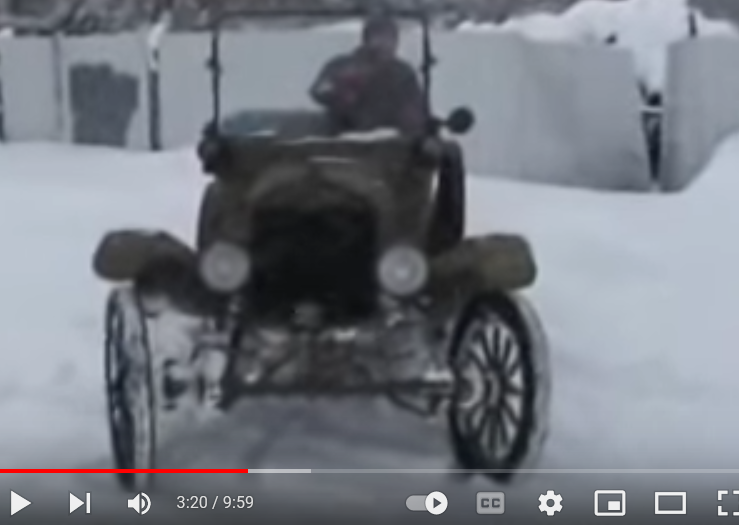

This has probably been posted before, but it is a good video showing one in action.
https://www.youtube.com/watch?v=fmHoUKq0sC8

After that video I’m convinced I drove a very poor example. It would not have handled 2” of snow.

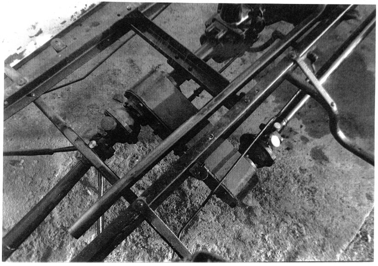

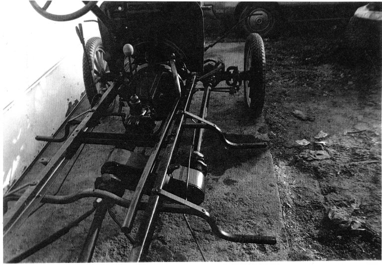

The speedster Livingood I drove was nice, I would think if one did not know it was 4 wheel drive you wouldn't have known it.
I drove it through 2"deep snow on grass up and down a fair slope no problem. These pictures were in my files of one being put together for those interested.

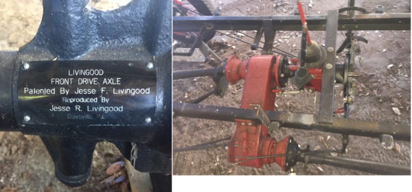

I'm very curious, is the transfer case belt driven? And is it full time four wheel, or can you disengage it? Thanks

John, Depending which series Livingood 4 wheel unit it is depends on whether 2 wheel drive can be selected.
The transfer case is chain driven. The later version which had a Warford box installed behind the motor is constant 4 wheel drive.

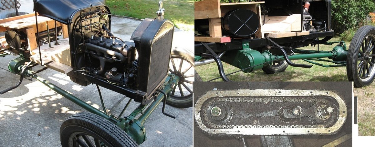

One sold on the Forum in 2019 viewtopic.php?t=4257
A bit of history https://www.motortrend.com/how-to/129-0 ... dster-4wd/
Gotta see this YouTube video of one driving in snow

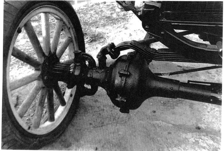

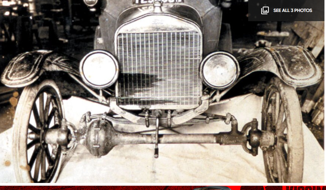

Post by TXGOAT2 » Sat Jan 15, 2022 9:49 am
The reshaped front spring looks problematic to me. Ford steering might be a handful with 4X4 engaged.

Are there any good pictures of the steering set up?
One390
Posts: 35
Joined: Mon Jan 07, 2019 10:02 am
* REQUIRED* Type and Year of Model Ts owned: 25 TT
Location: Oviedo
Post by One390 » Sun Jan 16, 2022 6:34 am

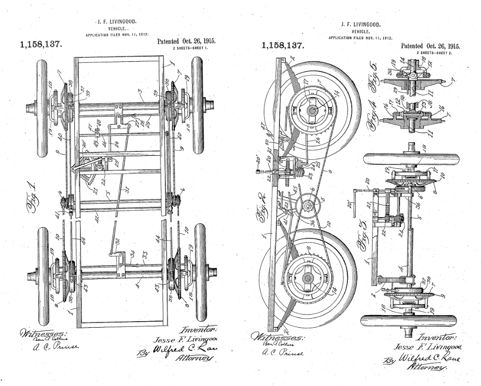

The patents are out there if you want to get a feel for what Jessie Sr did. The steering is same as he T it in terms of connections/tie rod. He used all model to parts. There are original advertisement out there as well. As someone said the transfer cases are chain driven with simple engagement. Like anything else if it is set up as intended it works fine. If you have something not right you have to fight a second driveline. Trying to compare it to a modern 4x4 is tough at a functional level just like trying to comparison a T engine to a modern 4cylinder. They are very cool with a very neat history and a hard to come by. He used to make them but unless the 3rd generation picks it up there won’t be anymore made.

More Pictures
