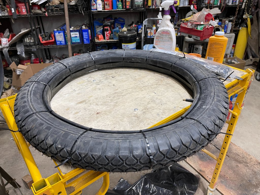

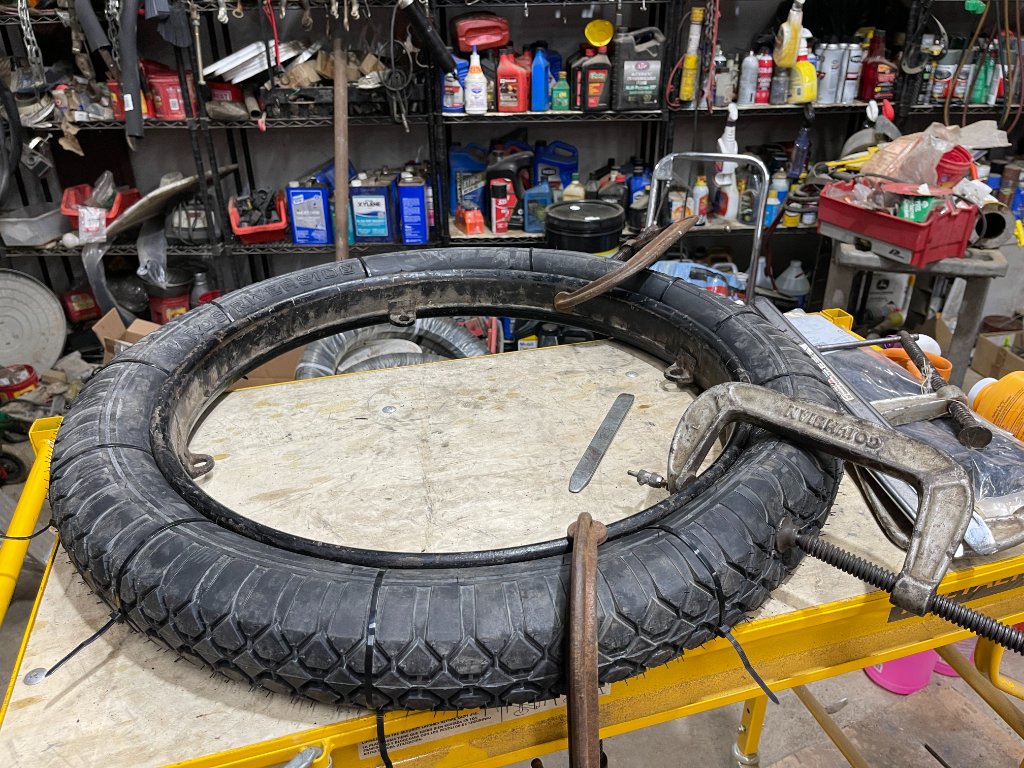

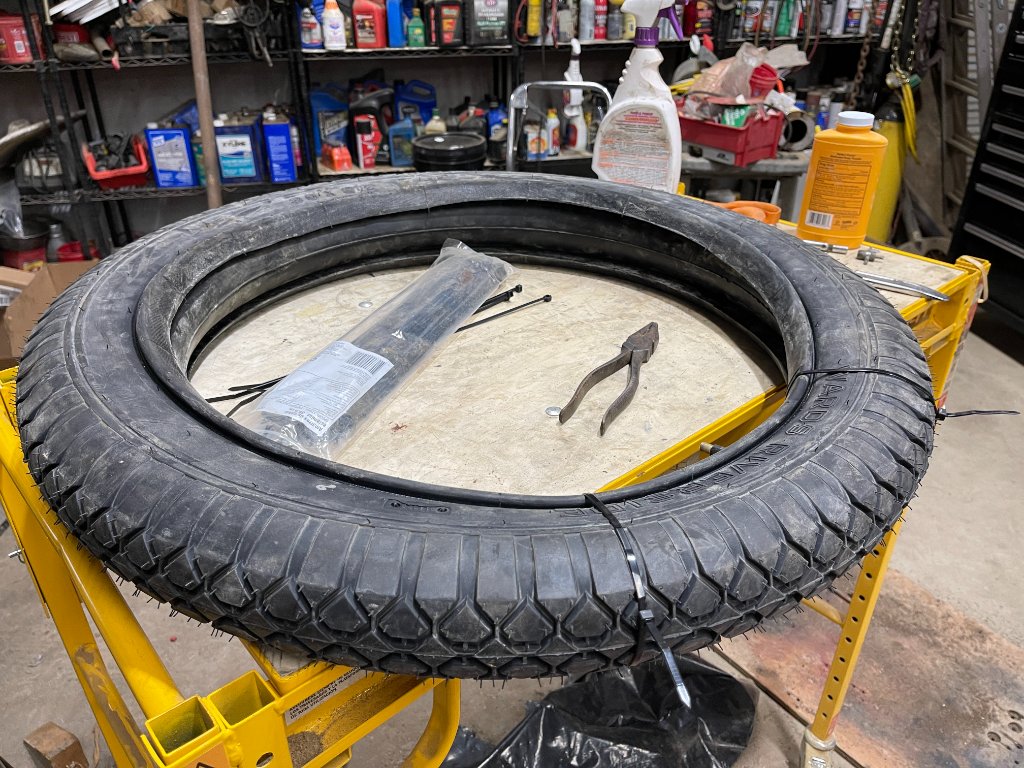

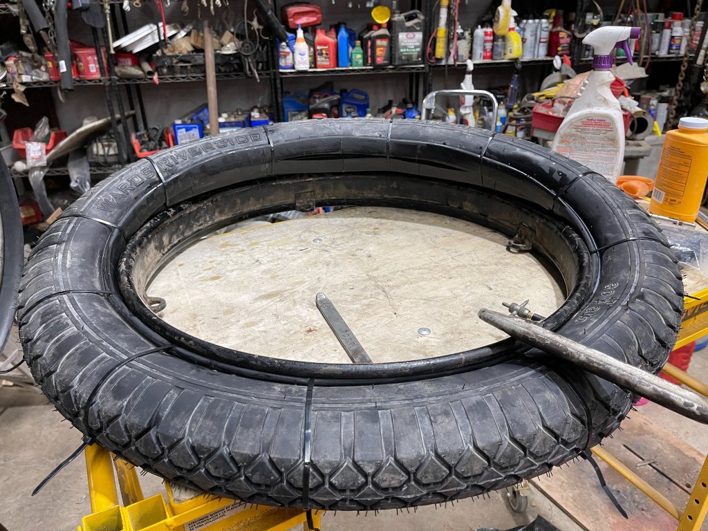

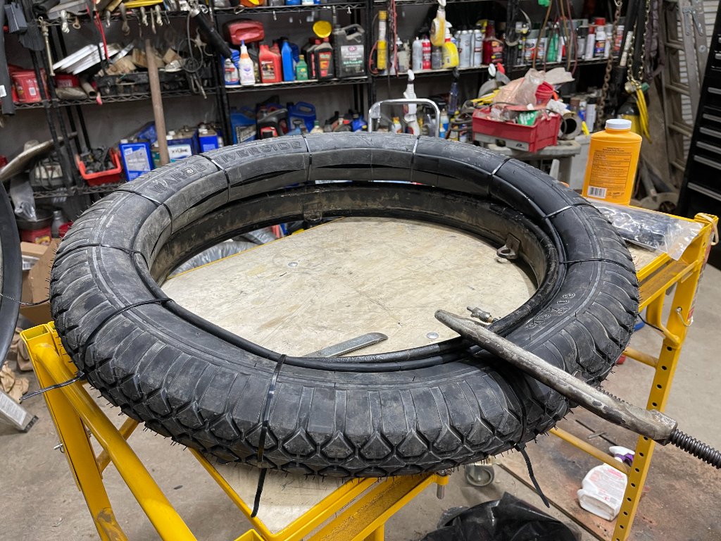

I just had my first experience replacing the tires on my '23 T. It reminded me a little of what wrestling a bear must be like. The tires were old and the rims were rusted so removal was challenging. I wire brushed the insides of the rims and treated them with rust converter and prepared to install the new tires, tubes and flaps I purchased. I had no idea how much challenge my choice to use flaps would add to the adventure. After many failed attempts to mount the tire, tube and flap assembly as a unit and then trying to add the tube and flap after mounting one bead of the tire, I stopped and regrouped.
The photos below are what I came up with and it worked perfectly. By zip tying the tire, tube and flap assembly together and them working it onto the rim everything stayed where it was supposed to. Admittedly the zip ties were a little tricky to pull out but pressing on the beads and pulling slowly worked like a champ.

Congrats on your idea. I like it. Next tire job Ill try it.
I believe , from the first pix, you may have had a bigger fight from too much air in the tube.

I did use lots of baby powder and the tube did not have the shrader valve in it. The issue was the circumference of the flap. It kept coming out of the tire as I started the mounting process. By holding the assembly closed it had no choice but to stretch!

Ok, thats a flap I saw. Brilliant solution. Without a flap, your idea should still prevent pinched tubes.

Nice job Mike, This is exactly the technique I finally began to use with my last tire replacement. I even used a big C clamp and 11 ties just like you did. You're comparison to bear wrestling is very accurate. Removing the ties is a little tough because they break. I found if you remove what you can on one side then the other you can fully remove the them.
the wheel over.
