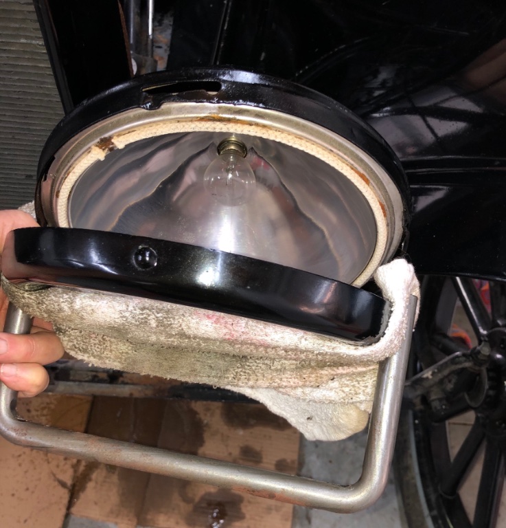

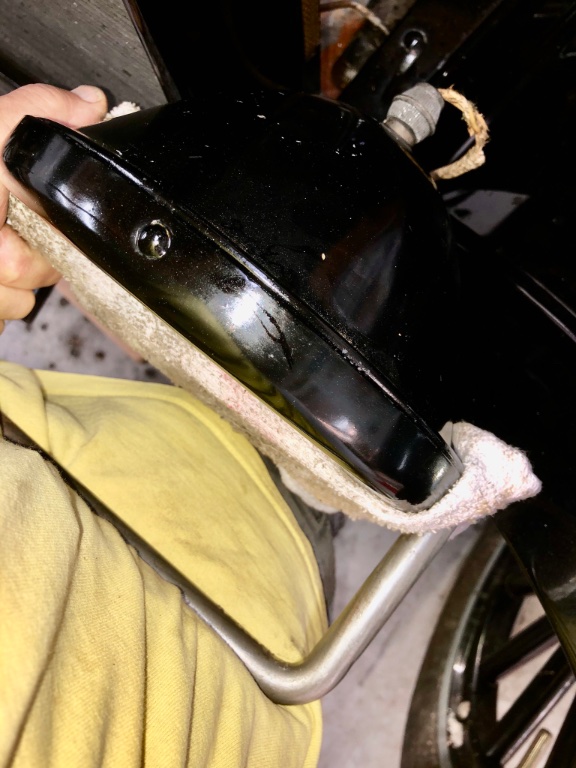

I had great hopes when I bought the tool but had mixed results on 4 Model T’s even after working on the buckets and rims. I get the rims off better with my bare hands. Though the tool is uber stiff it slips off the rivet heads for me.
- Posts: 4090
Re: Head Lamp Rim Removal Tool
The tool works for me on stubborn rims. Lots of penetrating oil first, then pad the arms with rag. The rag gives more grip and won’t scratch and works to wedge the tool snug.
Like the leverage the tool gives, plus can push a hip into the tool bar to get the reflector spring compressed , while twisting the tool bar with both hands.
