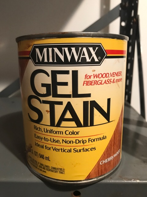

I used Epifanes on my wheels when I had them respoked about 10 years ago. I first used Minwax Cherry Wood Gel Stain since I wanted the wood a darker color. Then I applied several coats of Epifanes High Gloss Clear Varnish and then applied a final coat of Epifanes Woodfinish Matte.
The Matte is designed to be applied over the High Gloss Varnish.

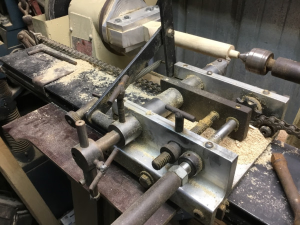

I removed the front wheel spokes from the wheel. Didn’t remove the rear spokes from the wheel. Hand scraped all black off, light sand, stain w/golden oak, then coated with West System Marine Epoxy w/ slow activator.To keep the epoxy off the mating surface and the tips of the spokes, put Play Doe on those areas, after everything dries, scrap off the hardened Play Doe.

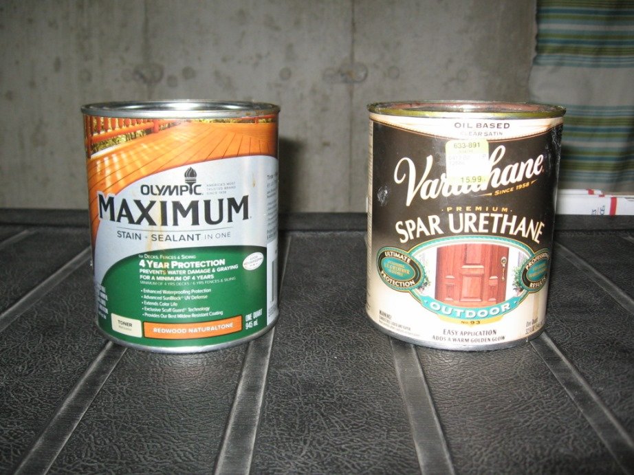

Here are the products I used on my spokes:

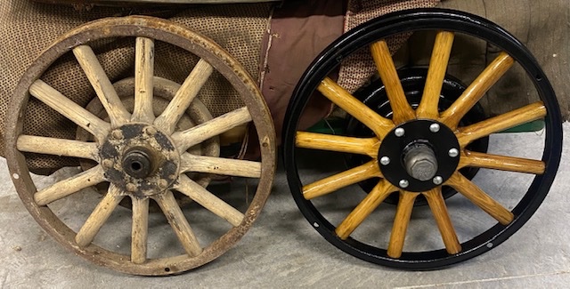

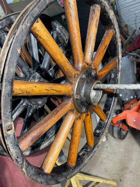

I have just had new spokes put into the wheels of my rusty old T. Naturally they stick out like a sore thumb. I have found that watering them every couple of days causes them to Grey and look much more like the rest of the car. Think about the fence around your yard. Where the sprinklers hit the wood that wood has turned grey.

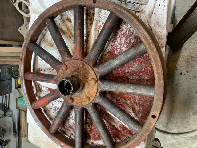

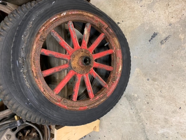

When I got my first T back 40 some years ago, the spokes were safety yellow...a very,very, thick coat...and peeling away. So I did the scrape with a broken chunk of glass as everyone said...took forever, but do-able, for a while, got old after the first wheel! I then had them dipped AND neutralized and they came home needing very minor 200 grit sanding with the metal fellow now bare and ready for prime.
Yes, tedious tape off with little pieces overlapping but that done, fellow and hubs primed with no bleed through on spokes. Let that primer dry for a week or so.
Tedious tape in the opposite direction. Left the spoke on while applying fellow mask, then took spoke part off, wanted a perfect butt of the tape and got it.
The spokes were done in a WATER-LOX exterior coating. Guys on here don't use the stuff. The wife had recommended it as she had lots of experience with it restoring old furniture and sealing things for exterior use. Brush on with just about any brush and it will flow on its own to be glass smooth was the claim. Yup...the claim was true. Patience is a virtue as this stuff is linseed oil based. Let it dry for a month!
Back to the butted masking tape exchange, again, then did all the metal with something maybe hard to get today. A mixture of Rustoleum gloss black, and Rustoleum clear at 50/50. At the time in the mid-70's before all this fancy coating stuff, this is what guys in the local club had been mixing for years for running gear work. (I'm not sure Clear is available today in the low VOC stuff).
The magic part? I've never sold any T I have ever bought. 40+ years...NO peel, NO bubbles, NO checks...all it takes is a wipe down with a wet cloth and good to go...no worries either when washing the car...and it looks like refinished yesterday.
That said, there is a part 2...
My cars after that came black wheels in decent shape, until a 2010 'buy'...it came with some sloppy varnish job that was like peeling Saran Wrap on red metal fellows and hub. Thought long and hard about doing it like the original '25. Then just decided too much work, too long a time frame, and now in my 70's a month is a long time (that does go by in 2 seconds). I sanded them down to get through the failed varnish, they were demountable so finished it all with rattle can black. Good enough for now!
Stuff to think about. Good luck.

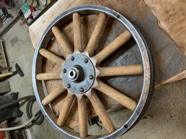

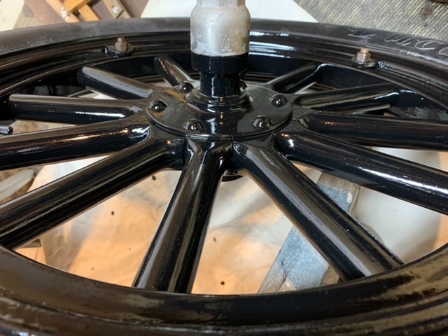

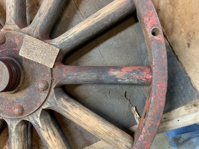

I prefer the natural look and just finished this wheel today. The picture is a before and after of the rear wheels from a 26 chassis that was turned into a farm wagon. We rescued the chassis from a barn and it was sunk in the mud for decades I’m guessing. The spokes were surprisingly sound but very dry. I took the wheel apart and sanded them to get down to the “fresh” wood and applied two coats of thinned Spar Urethane (to allow it to soak in) proceeded with about 8 coats full strength. Metal was painted with gloss Rustoleum (rattle can variety).
Kind Regards
John
