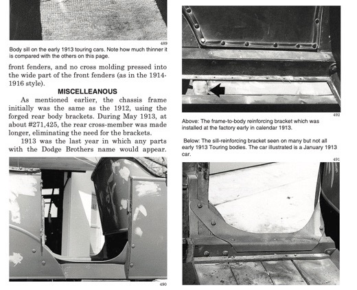

Posts: 4103
Re: 1913 body braces
Post by DanTreace » Thu Jan 20, 2022 9:14 am

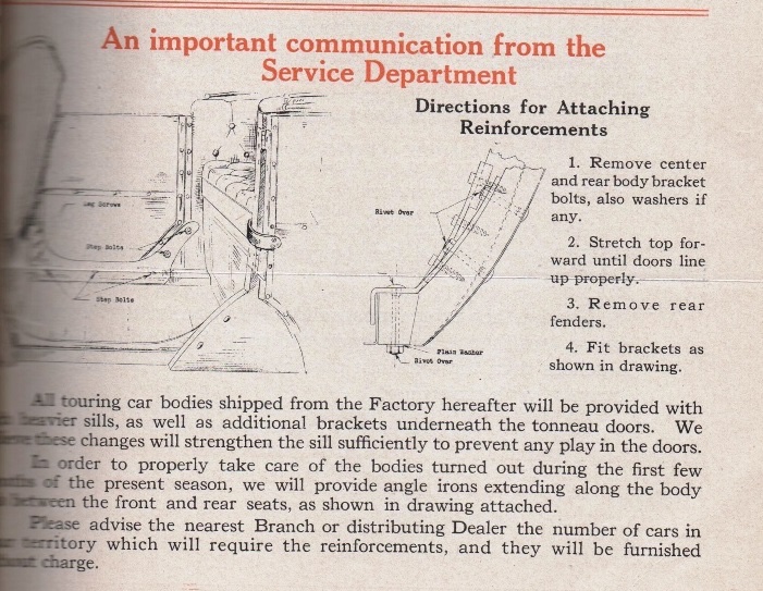

Don't have copy of those part #s, but Bruce's C-D Ency. (another reason to buy this $50 super C-D) has picture of the frame bracket and the reinforcement body bracket installed on a body. And attached is copy of Ford instructions for install.

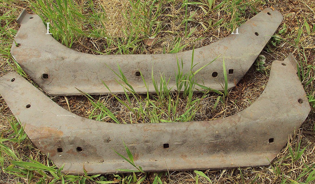

Post by Rich Eagle » Thu Jan 20, 2022 4:59 pm
I sold these a few years ago. This shows common wear and abuse and possibly some detail.

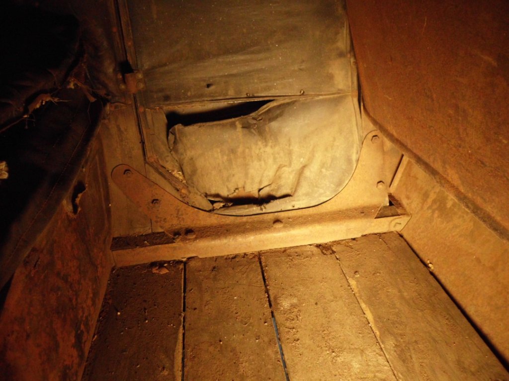

Post by Scott_Conger » Thu Jan 20, 2022 10:17 pm
FWIW, My Jan 2, '13 car sports a set of these, and I believe them to be original to the car

Scott, The "Ford Sales Bulletin", dated May 1913 states that these braces are now available to dealers. My January 1913 touring has the frame brackets that are bolted to the frame. There is no doubt that Ford knew there was a problem with the weakness of the sills and these braces were retrofitted to earlier (pre-May 1913) cars. I hope this helps. Russ Furstnow

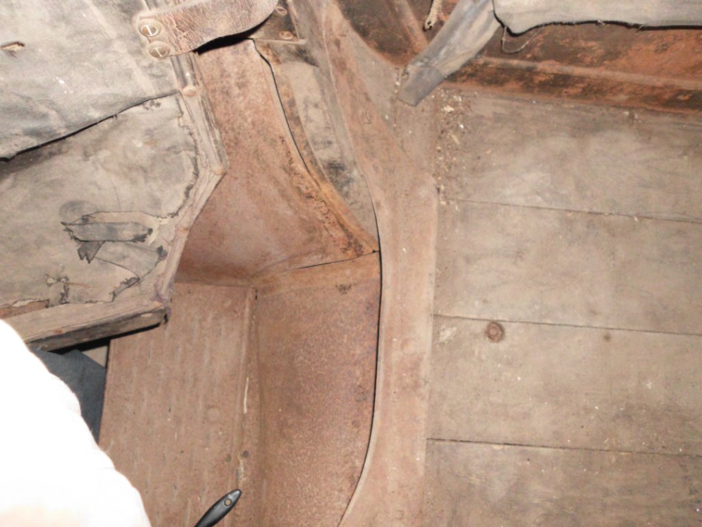

January 1913 touring.
