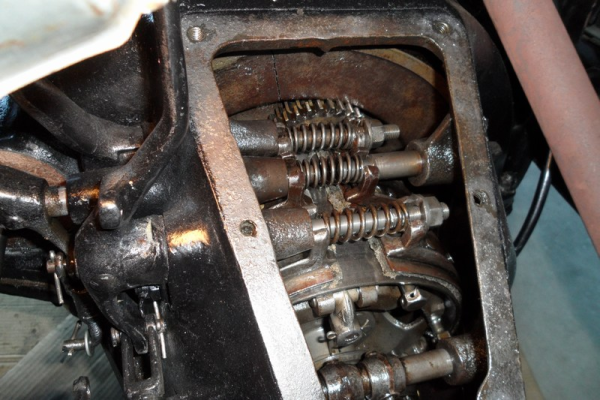

I just removed my bands to have them relined, I was wondering why the removable ear should be on the drivers side. It seems that if it rolled out on the other side there isn't any interference removing the bands while on the driver side you have the pedals and other items you have to work around. Any thoughts? Thanks

We installed mine on the driver side. We were told later that that is a mistake. We will have to remove the hogshead to replace them. Maybe others have a different opinion.

According to the Ford manual, detachable ear bands are to be installed with the removable ear on the peddle side (driver's side for us Americans) so as one simply drops the opposite ear into the abyss to gain ample room to remove the one that comes off then fish out the attached ear and bring it out and around.
If the ears are placed on the right (pass. side for us Americans) there isn't enough room to remove the detachable ear UNLESS you bring each band back to the clutch spring area to have enough room.

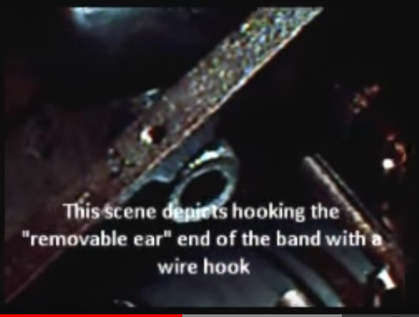

This appears to be an old video and pictures are dark, but the bands are pulled through to the pedal side where the ear is attached
https://www.youtube.com/watch?v=CwVydOu-QJQ --
The quick change bands were designed so the bands could be removed replaced through the transmission cover. So doesn't it make sense that the removable ear side be on the pedal side to clear the various pedal supports using the "band tool". No comments on the band tool please.

The video got me to scratch my head. Its a right hand drive T.
Still the removable ears are installed on the correct left side.
