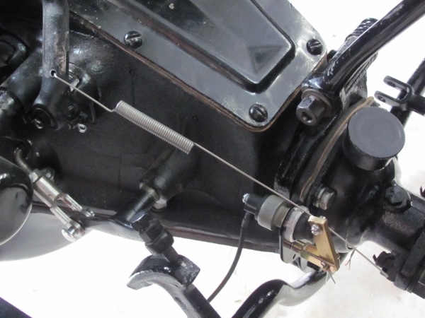

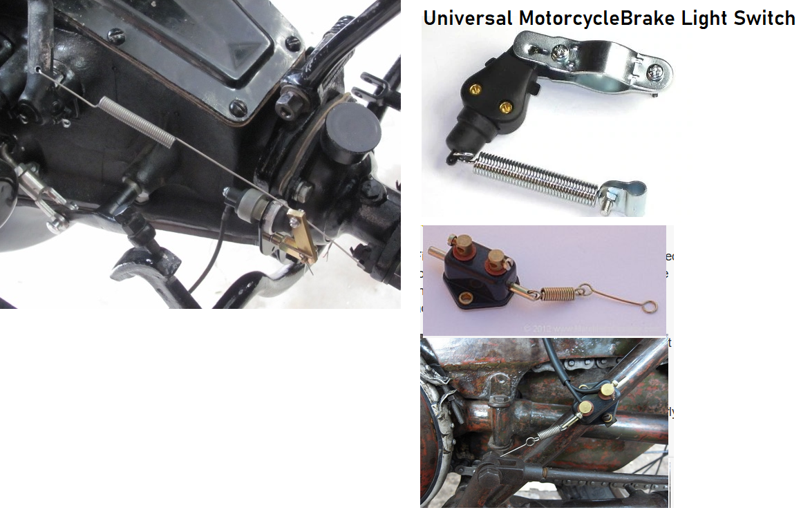

I use a motorcycle brake light switch on all my Ts and work very well. Easy bracket to make even I can do it!
- Posts: 3743
- Last Name: Wrenn
Re: Looking For Stop Light Switch Instructions
Dan...is there any info and/or pics you could post? Seems like the venerable "fun projects switch" will be no more. I keep hearing from certain people "oh its being made" but never seems to surface. Luckily I found an un-needed couple of F.P. switches to finish my fleet so at least I'm good. But others may be interested in your design.
- Posts: 6592
Would like to see what has been done too. These look they could be used very easily

Google "Starter Button Switch".
A large number of booted switches will come up.
Most under $10.
