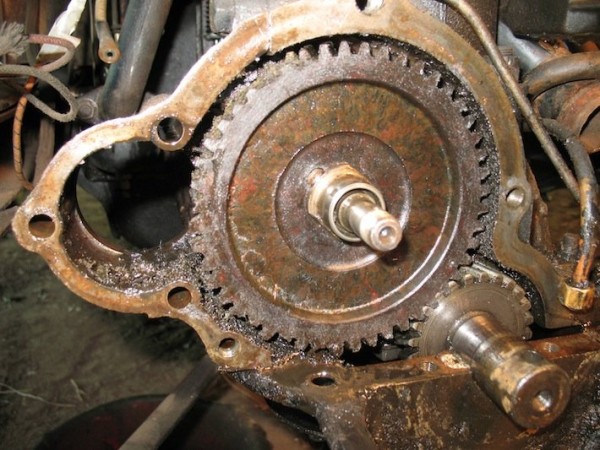

Post by Steve Jelf » Tue Apr 02, 2019 10:23 pm
If the timer doesn't turn, I wonder...
But if the gear is OK, perhaps the pin has fallen out of the timer as David suggested.

Post by infotfordnl » Wed Apr 03, 2019 11:32 am
ha all,
at the end I found the problem, the 2 pins were out of the valve shaft, I have this fiber gear in the car, the theets looks good but I think the center is a bit to fat so the centre bold doesnt pusch the pins down and regarding the lenght of the pins the can come out without losing the center bold.
I think thats happend.
I can see they were a time out of there position, and I found the motor also a bit weak, afterwarts because of the wrong timing of the valves, I sugested.
Toon Boer suggested also, it is the best to change this gear because of the bad experiance of fiber gears, in combination with a dynamo.
so I will do that
thanks all for all the nice input,
Bert

Post by Scott_Conger » Wed Apr 03, 2019 11:45 am
Bert
that's is a surprising finding! Those pins are not supposed to be loose at all. You may wish to consider using a retaining loctite compound to reset them into the cam shaft to ensure this never happens again.
