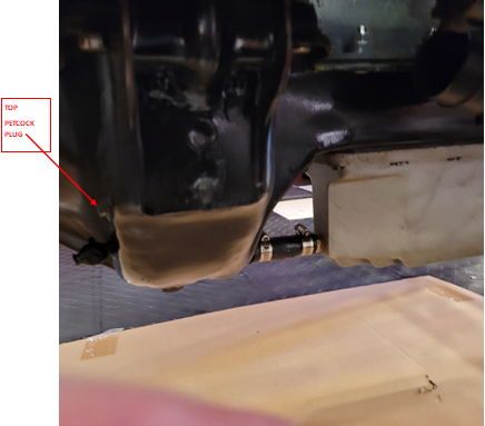

The 5 racer has arrived and I have mild issue:
This engine has a Model “A” crank installed along with a deeper oil pan. The upper petcock was removed and a plug installed. The question is, normally you would fill tell the oil ran out of the top petcock. So is the procedure changed to fill only to the bottom petcock? I’m assuming that this may be the case due to the additional oil in the deeper pan? Or do I need to replace the plug with another petcock?

This engine has a Model “A” crank installed along with a deeper oil pan. The upper petcock was removed and a plug installed. The question is, normally you would fill tell the oil ran out of the top petcock. So is the procedure changed to fill only to the bottom petcock? I’m assuming that this may be the case due to the additional oil in the deeper pan? Or do I need to replace the plug with another petcock? petcock.png
The oil level is supposed to be BETWEEN the 2 petcocks. Filling to the top petcock is too much. The tricky thing about checking the oil, is to have a feel for how much oil is flowing out the bottom valve without a sight gauge to determine the oil level..

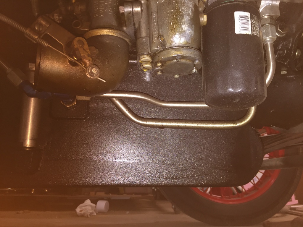

One thing you need to know is what kind of oiling system you have. Model A had a splash system similar to a T however,it used an oil pump to lift the oil into the valve chamber from where it ran into the dips in the crankcase. Or you could have a pressurized crankshaft similar to a modern car. So you really need to find from someone who is familiar with this engine to be sure how much oil it needs. Then you can devise a system to check the oil. Also do you have the original transmission or has it been fitted with something else? All these things need to be known in order to answer this question.

The deep sump typlcaly holds 4 qts and the T sump up to the upper spickiot holds 4 qts, for a total of 8 quarts of oil, a oil filter system would hold more oil. The hose between the deep sump and the T sump is needed to equalize the oil level even with a splash oiled system. Make sure there is always oil over the oil pickup in a pressure system, sucking air is bad news.

I would remove the top plug, put a petcock in the hole, and keep the oil level between the two. Just because it has a sump, the oil level should be no different than a regular engine- Not sure even with an oil pump, that you would do anything different. Having an A crank changes nothing regarding lubrication for the bearings and transmission. If it had an oil pump, there would most likely be some evidence of additional external oil lines, a filter etc. , but you have made no mention of these details.
