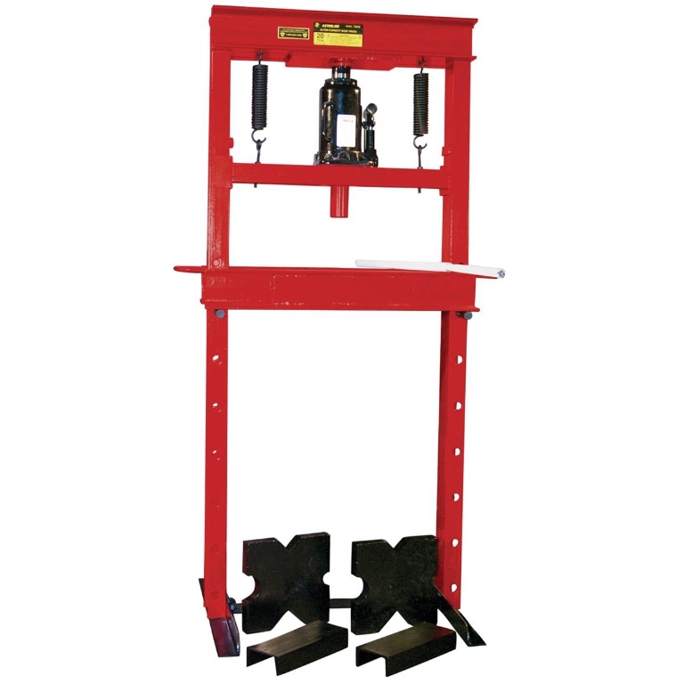

A powerful hydraulic press and a large steel plate might work better to control the load as well as transfer the load over a wider area. You might want to take it to a machine shop and ask them if you can borrow their press or ask them to do it for you as you closely watch. Jim Patrick
