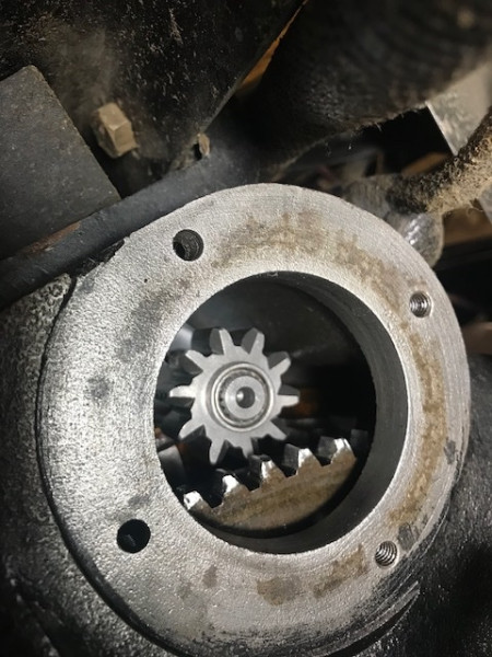

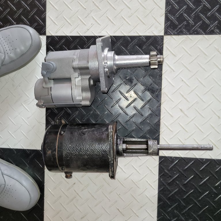

Is anyone using this 12v starter? How do you like it? I'm assuming you just cap off the bendix hole?

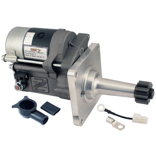

The WOSP starter was designed by folks in England who love and cherish Model T's as much as we do. It meets several needs. 12 volt - no bendix issues - geared so it turns the engine over very well.
I had a rebuilt original starter on my car when I started out. For the most part it worked OK although I experienced a few instances when the engine was hot that it would not turn the engine past compression (I have a Z head). I'd have to get out and turn it past compression with the crank and give it another go. After this happened in a busy intersection with cars honking at me I started looking at other options.
I was running 12 volts but had not converted the original starter from 6. I took it to a well-respected, old time, local automotive electrical shop and asked them about converting it.... they looked it over and flat-out refused to do it.
Investigating the WOSP, I liked what I saw. It is designed well and of excellent quality. Best of all, my car starts on the first turn of the key. Doesn't matter whether it is hot or cold. I usually start on mag and may add a little choke in the winter. Does it sound like a Model T starter? No.
Price - in a previous thread I reported that if you purchased directly from one of the two US WOSP distributors the price is about $100 less than what the vendors are charging, a statement for which I got flamed and may get flamed again. So be it. That puts the WOSP on par with a 100 year old starter if you are purchasing outright. Me, I bought the WOSP and sold my 6 volt starter and spare bendix and bendix parts and recovered 90% of my cost. I bought mine from a vendor so I could have saved more had I known to go direct.

Thanks all for the replys. can anyone attach a photo of the "new" starter as it is installed? I really like the idea of this starter, but as issue I may have is this car (a 1915 Speedster) has a Franklin steering box and the clearance between it and the stock starter in minimal. The "Snyder" starter appears to be off set from the mounting plate, moving the starter itself closer to the engine. If this is actually true, it might work with the Franklin box?

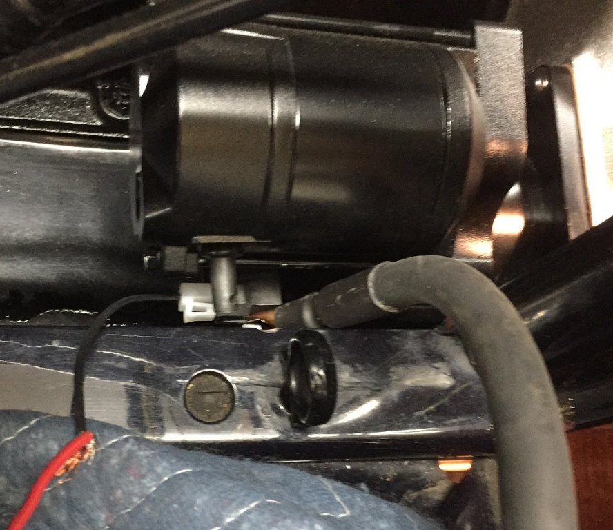

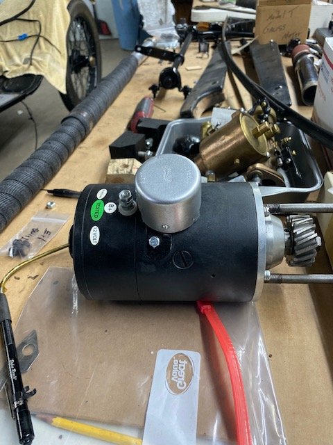

This is one that was hot wired for a quick test and worked fine.

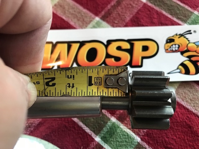

"Does the gear on the starter gear stay engaged all the time?"
No - that is one of the misconceptions about these starters. The starter gear is specially cut to allow it to easily engage the ring gear. It's a two-stap process, first the gear engages, then the starter rotates, releasing the gear when the starter switch/button is released. Being geared, it turns the engine over quickly, allowing me to easily start on mag.
The starter motor has been around a long time. To use on a Model T the distinctive nose had to be designed. Here is a link to the folks in England responsible for the design. <https://www.modeltford.co.uk/>

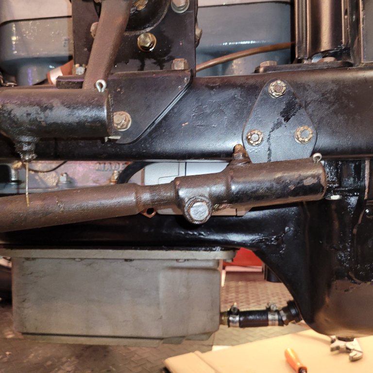

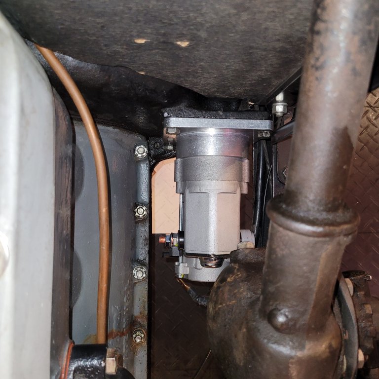

I received the Modern starter this afternoon, it fits but is tight up against the block. I understand that it can be rotated 360 degrees on its axis, but how? It didn't come with any instructions and what is on Snyders site doesn't cover rotation!
anyone have the proceedure?
Rod
Rod
1965 Shelby Cobra (Factory Five repo)
1957 Ford Thunderbird
1941 Ford PU
Loftbed
Topic author - Posts: 251
- Joined: Sat Jan 12, 2019 6:16 pm
- First Name: Rod
- Last Name: Letcher
- * REQUIRED* Type and Year of Model Ts owned: 1915 Speedster
- Location: Eugene OR
Re: Snyders modern 12v starter
OK, forget the last questiob!Loftbed wrote: ↑Thu Feb 03, 2022 7:29 pmI received the Modern starter this afternoon, it fits but is tight up against the block. I understand that it can be rotated 360 degrees on its axis, but how? It didn't come with any instructions and what is on Snyders site doesn't cover rotation!![]()
Rod
I tried rotating the whole unit 180 degrees now it is upside down with the motor on the bottom (photos to come) it will bolt up in this configuration and the only issue i see would be it getting wet from water splashing up on it, but I don't drive in the rain so....
It is a real nice fit like this, nothing touching anywhere except the bolt up point.

Is there room to install the engine splash pans (-as originally equipped??Loftbed wrote: ↑Thu Feb 03, 2022 7:47 pm....the only issue i see would be it getting wet from water splashing up on it, but I don't drive in the rain so....Loftbed wrote: ↑Thu Feb 03, 2022 7:29 pmI received the Modern starter this afternoon, it fits but is tight up against the block. I understand that it can be rotated 360 degrees on its axis, but how? It didn't come with any instructions and what is on Snyders site doesn't cover rotation!![]()
Rod

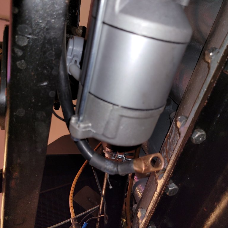

Here is a photo comparison of old and new as well as some installed photos, I've still got to wire it up. above I stated that I rotated it 180 degrees, actually on 90 degrees.
Rod

Rod, your phot appears to show what I always suspected, that small gear is always in contact with the ring gear and the connection happens inside the starter case.
- Posts: 4479
No, it's not in constant mesh with the ring gear. How could that possibly work? Read the posts above...
- Posts: 8664
If that's the case, that poor little gear is going to be revving about 20,000 RPM when the car is going 30 MPH.

Sorry But it is not in contact with the ring gear, the photo is misleading. I could actually reach in an move the gear on the starter.
Rod

Also if you look real close, you will see one of the ring gear teeth is overlapping one of the starter teeth.

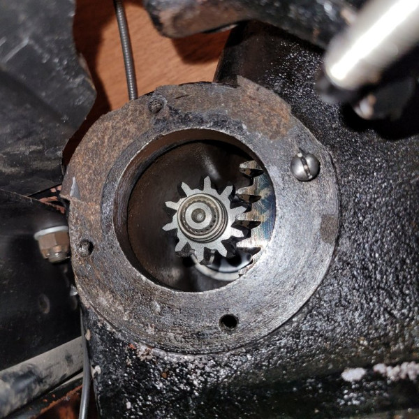

Please try not to be rude. We are all in this together. Here is a better view.
- Posts: 7300

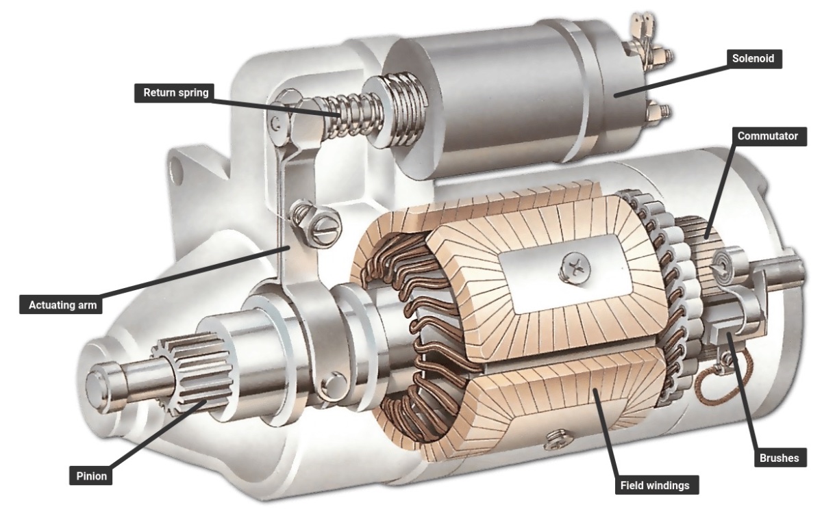

What makes the gear move in and out of mesh with the flywheel when the starter is used?
Bryant
- Posts: 1229
- First Name: Bryant
- Last Name: Shafer
I would assume that it is like any modern starter. It just has a longer “snout”

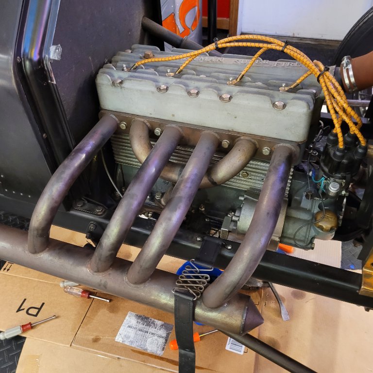

As the OP on this thread, I'd like to ask the critics if they still think that adding this starter to this car has changed its originality (see below)? Also I bought it in this configuration and broke the Bendix thereby necessitating some kind of change! I seriously doubt that keeping the original starter on this car would have added to its originality!!
SPECS:
• 1915 engine produced in Sept engine # 900633.
• Early Scat Crankshaft*
• “Wildly” modified Model “A” Camshaft*
• Larger exhaust and intake valves*
• New old stock Sherman “super fire” 8:1 Aluminum Head*
• Carter BB1 carburetor*
• Model A rods.
• Custom pistons*
• Bosch front plate.
• VW 009 Distributor with special drive.
• Wood transmission bands
• Custom Exhaust & Intake.
• 12v conversion.
*Indicates information supplied by Larry Blair (LOCO LARRY) Engine builder
• Fairground racing chassis and seat. **by “Pete Eastwood”
• Franklin Steering.**
• Tapered front and rear springs.**
• Front axel spindles.**
• Split wishbone**
• Body number plate**
• Tail light**
• Special brake cross shafts**
• Rear radius rods**
• New Axels**
• Shortened drive shaft with sealed pinion bearings**
• Torpedo hood without sides**
• Chevy finned drums**
• Four restored Buffalo wheels**
• New Monochi Hubs and nut, bearings and seals**
• New tires and tubes
• New 13-14 flat tube “Brassworks brass radiator**
** indicates work performed by Pete Eastwood (PWOOD)
SPECS:
• Model A rods.
• Custom pistons*
• 12v conversion.
• Split wishbone**
• Tail light**
• New Axels**
Bryant,Bryant wrote: ↑Sun Feb 06, 2022 3:02 pmI agree with the nonsense part. The original question was has anyone used the starter and what they thought of it. So now the author has purchased and installed the starter I would like to know what he thinks about how it works. Later anyone interested in it can wade through the nonsense this topic has birthed and come up with their own conclusion on if it’s right for there application. Maybe history will reveal the starter to be on the list of the many accessories the Model T has Inspired.
Yes I have it installed and it turns the engine over just fine, I can't speak to how well it starts the engine as I am awaiting a rebuild of the Carter carburetor. Soon we will know! I will make a video once I have all the pieces in order.
Rod

That header pipe is a work of art! Going to need one for my project...

maybe a topic drift but looks like wosp also makes a 12v dynamo. Part# LMDMODT001. Maybe it’s really about the look? If they made the starters/alternator’s to look the part would you use it? If you go 12v that is.
Well I finally got the carburetor back and installed and was able to try out the new "Wosp" starter. Wowsers folks it is indeed as advertised and as promised weeks ago here is a video of it starting the 1915 super hopped up Racer/Speedster. https://youtu.be/oJxL2G7hvSU
I've got a little dialing in to do although I suspect some of the "rough running" is due to the custom grind of the Cam. I did manage a short run up the street in this bad boy and let me tell you "Wild Horses" comes to mind. Not sure if I have the kahonies for all that it wants to deliver.
Rod
[image][/image]
Rod
[image][/image]
