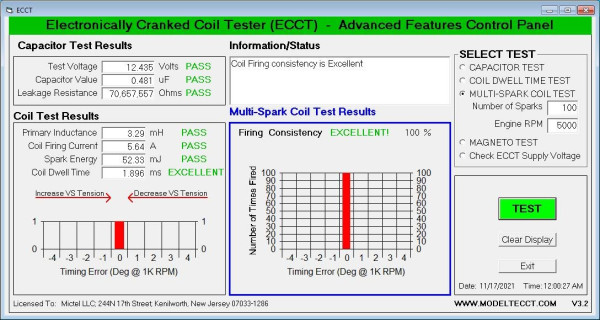

I've been studying Heinze coil operation and performance using the ECCT and have come to a very surprising conclusion. The Heinze coil is actually a superior coil design compared to the K-W coil.
The Heinze coil is significantly easier to adjust and consistently out performs the K-W Coil. Coil firing consistency is typically better than 90% and is maintained to firing rates well above 3000 RPM. I believe the Heinze coil got it's notoriously bad reputation for being difficult to adjust for good engine performance due to the limitations of the coil test tools and method back in the day; not the Heinze coil or it's 2 element point design. The HCCT or other coil test tools that measure coil current as an indirect approximation of firing time are simply incapable of measuring the coil dwell time to fire the first spark. The displayed coil current is the average of ALL the sparks fired (including any double sparks) which makes average coil current a poor coil adjustment metric and typically results in poor engine performance.
Yes, the Heinze coil 2 element point design is vulnerable to double sparking but if the first spark occurs at the proper time, of the proper energy and does so consistently, does it really matter if there is a 2nd spark? NO! Ever hear of Multiple Spark Discharge (MSD)? I believe the Heinze coil will be vindicated as a superior coil design as more folks experience engine performance with their Heinze coils properly adjusted for equal and consistent firing Time rather than equal coil current.

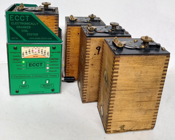

Special Heinze Edition of the ECCT specifically designed to test and adjust Heinze coils:
Heinze coil firing time is very easy to adjust; simply turn the vibrator spring adjusting knob! Heinze coil firing consistency remains Excellent at firing rates well above 3000 RPM and often of up to 5000 RPM as shown below without having to fiddle with a Cushion spring tension; trying to find its sweet spot.

Some questions: will the ECCT function okay with both coils that retain their original windings as well as ones that have been replaced with the regular windings the vendors currently sell or original windings out of regular style later coils? I remember RV Anderson saying the point current draw on originals and the replicas he built was 0.8 amps as opposed to 1.3 on the regular windings. I find I set my rebuilt coils at 1.0 amps for optimum sparks with my Strobospark. I realize your tester works different so I humbly admit my electrical knowledge is just enough to make me dangerous! Lol! Looking forward to trying out an ECCT for these in the future! Thanks!
Posts: 6815
Re: Heinze Coils - An Inferior Design; OR Did History Get it Wrong!
Post by Scott_Conger » Tue Feb 01, 2022 4:31 pm
Darren, they draw .8A because that is what they are set to draw. There are differences between original and new windings, but those differences are not fundamental to the .8A setting. This setting is consistent with the original spec'd setting of these or these earlier type of coils (no cushion spring). Very low amperage draw leads to easier successful starts when cranking by hand. The higher amperage draw setting, the fiercer the pull must be on the hand crank to achieve rotational speed to create a spark when starting on magneto.

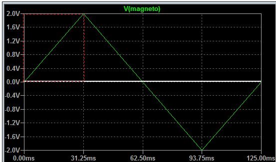

2. What coil current can we generate via brisk hand crank? The magneto voltage output is a triangular wave (not sine wave as is another common misconception). The resulting coil current rises exponentially with the linearly rising triangular magneto voltage as the crank is pulled swiftly. The coil current can be calculated by the formula:
Where L is the coil primary inductance, Vcoil is the stimulus voltage applied to the coil and dt is the change in time.
So to calculate the value of coil current, we need to know have fast the applied coil voltage rises with time (VL dt) term. Lets assume we can pull the crank a 1/4 turn in ~30ms (That's equivalent to completing 1 full rotation in 1 second or 60 in 1 minute; 60 RPM. Thus, 8 magneto voltage cycles produced per in 1 second revolution or 1/8 = 0.125 seconds to complete 1 complete magneto voltage cycle that of two voltage pulses (one positive and one negative) and lets say the voltage pulse is a relatively weak 2Volts cranked that slow. Here is what that would look like in time
Magneto Voltage 1 cycle at 60 RPM.JPG (40.22 KiB) Viewed 5061 times
so the time it takes to produce a single magneto voltage pulse to rise 0 to 2V takes 1/4 of that time (1/4 crank pull) or 0.125/4 = 0.03125 seconds for the magneto to produce a weak 2V voltage pulse (see dashed red box) . So then the magneto voltage (VL) rises from 0V to 2V in 0.03125s so the linear slope (m) of that line is 2/0.03125 = 64. The voltage applied to the coil can be written as:
Where m is the slope (rate of rise) and t is time.
Plugging that back into our equation for coil current equation and solving:
9.47A is more than enough coil current to pull open the coil points to fire spark. A properly adjusted Model T coil firing current is about 6A on the ECCT so should have no problem starting an engine via hand crank.

Darren, the Heinze version does have different Pass/Fail criteria due to the Heinze coil properties being different from the KW coil parameters. I just started to accumulate feed back from a few folks who I have been working with. So far, the feedback has been excellent providing motivation to proceed with making a separate tester specifically designed for Heinze coils. Time will tell if my suspensions about the Heinze coil are accurate as more folks experience engine performance with their coils adjusted for equal and consistent firing time as opposed to average coil current.
