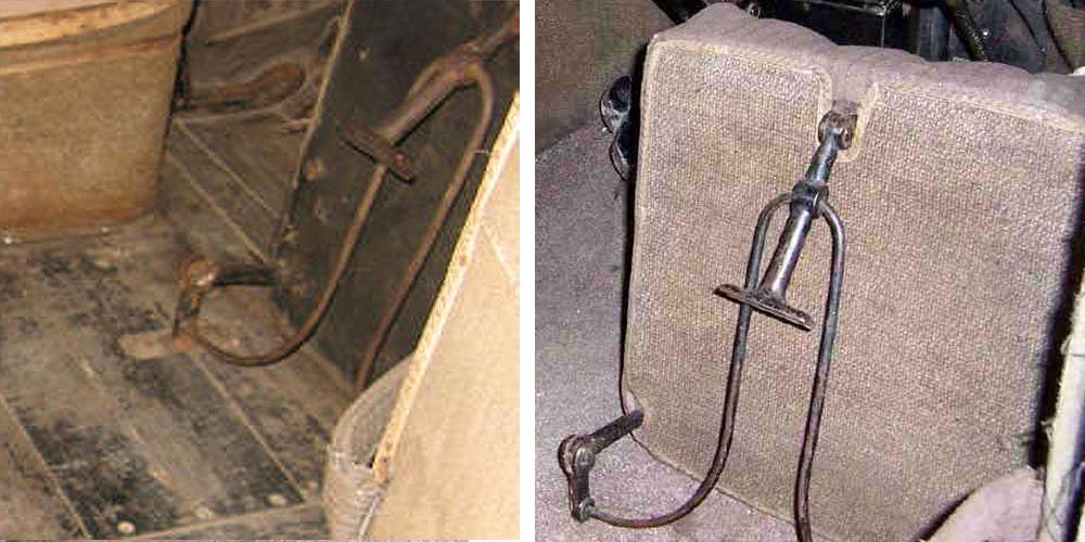

Center door seat hinges use a 5/16 pin retained with a cotter pin to act as the pivot point. The part that mounts to the floor has 2 ears and the seatpart has 1.

I hope these photos help. My Ford body book lists the numbers as 9664BX etc. But who knows.

Hello & THANK you both it sure looks like the right seat bracket to me from the explanation & photos cheers Warwick.

My 22 seat is exactly like that
