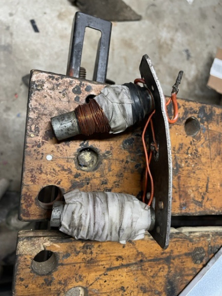

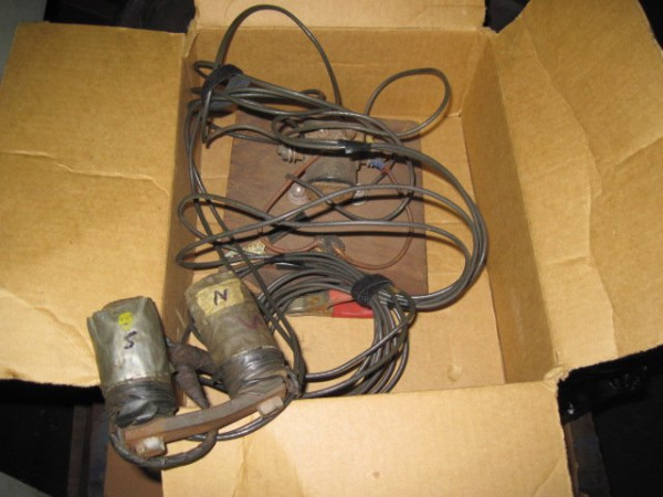

This is the one that was in the earlier MTFCA Electrical Systems Book. Part of the details and story is still there.
J1MGolden
Posts: 1323
Last Name: Golden
Location: Bowie, MD
Re: Magnet Charger Details
Post by J1MGolden » Tue Jan 25, 2022 6:34 pm
Bob, part of my repair required me to unwrap the wire on each coil, as the inside connection was bad.
The wire was good and reused, seems like it was 100 inches long, but the other details on the core size is lost.
That would charge a magnet to pick up very close to 4 pounds with a 6 Volt battery for a power source.
The present owner has not found it and he claimed it quit working again.
I would like to build another one!

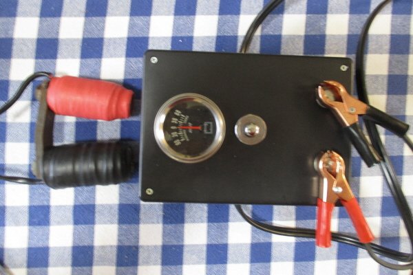

FOUND IT.
I built mine according to Ted Aschman's tinkering tips. Tan cover.(coils only) The cores suggested are 1" .
2 delco starter solenoids. Use the heavier wire, all of each solenoid per coil.
This unit is a bit inferior to my final unit. More to come. Probably a new post.

I found my magneto charger. The copper wire is 0.028” diameter with lots of turns😊
Magneto charger
Magneto charger
And no, I’m not going to pull it apart to see how many turns on each leg. 😊😊
