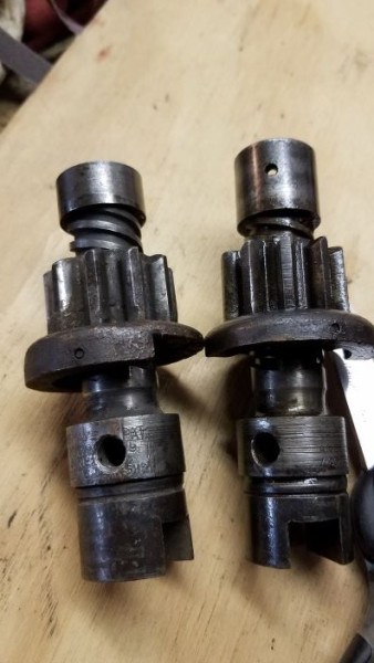

Are short nose ones earlier than the long nose ones or the other way around?

Believe the one on the left is Model A.

Post by speedytinc » Thu Feb 03, 2022 8:32 am
The one on the right is correct for all. The left is a close replacement. Better then not, but not quite right. Cant speak to model A usage.

Post by Plankhill » Thu Feb 03, 2022 8:45 am
Not Model A Came off a Model T .

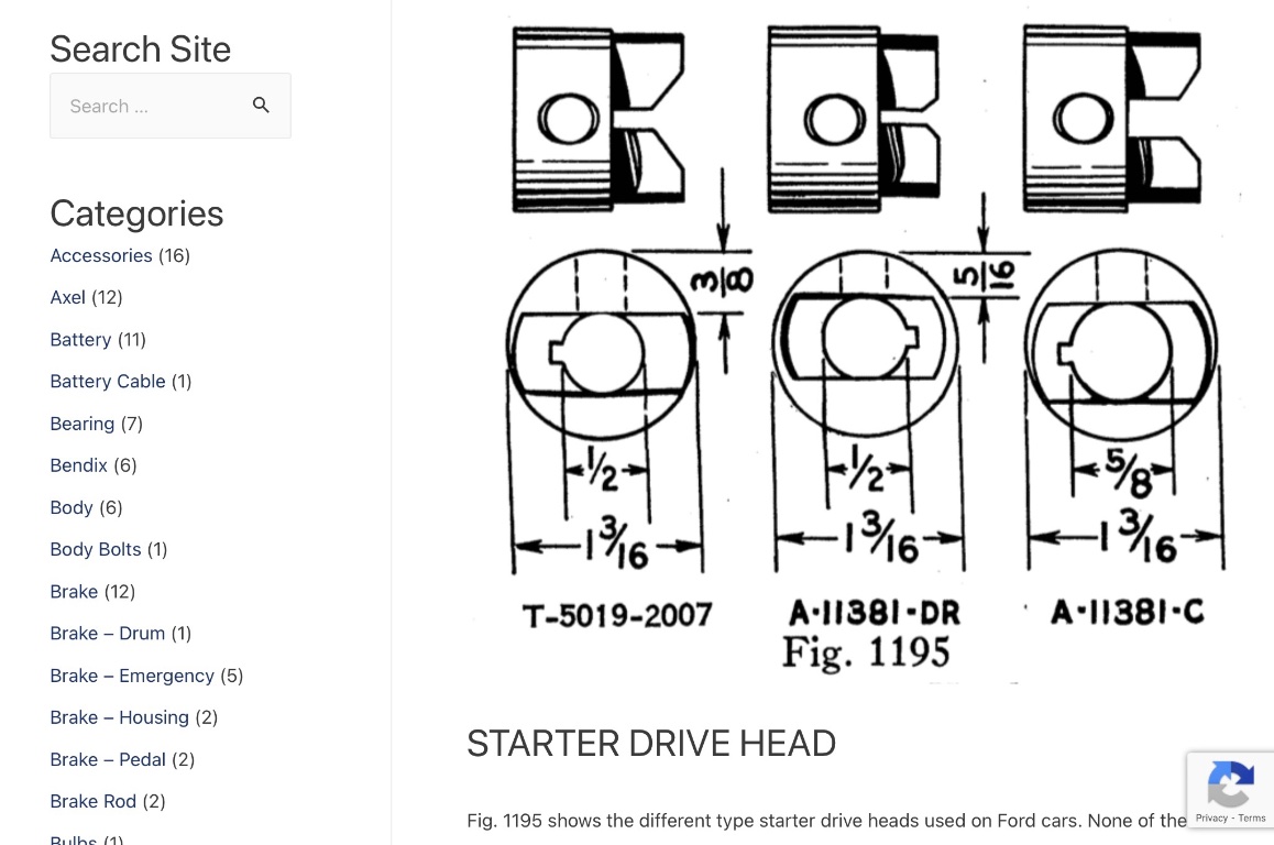

Re: Starter Bendix Question
Post by Kevin Pharis » Thu Feb 03, 2022 11:12 am
Model A starter shafts are larger diameter than a T. Seems to me T is 1/2”, and A is 5/8”...

Post by BobD » Thu Feb 03, 2022 11:38 am
Early Model A's with the Abell starter drive had 1/2" shaft. From Oct. 1928 on, the 5/8" Bendix to end of production.

Post by Scott_Conger » Thu Feb 03, 2022 11:42 am
Kevin and BobD
you are right and I was completely wrong. So wrong, that I revised my post to the extent that I could

Post by DanTreace » Thu Feb 03, 2022 2:18 pm
The Bendix drive head for the one on the left is a bit longer than T and uses a different lock bolt depth too, still think one on left is early Model A.

Post by BobD » Thu Feb 03, 2022 4:04 pm
Early Model A Abell starter drive.
