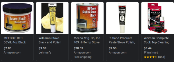

Post by TRDxB2 » Tue May 24, 2022 8:43 pm
I would "paint" it rather used Stove Black polish.
If you paint it you need to let it natural cure for at least a week (ignore what the directions say). I have used Rustoleum High Heat (2000 degrees) not to be confused with ULTRA High Heat (1200 degrees).
So compare the ads aon what they claim.
Rust-Oleum® HIGH HEAT is a tough protective enamel that renews and protects surfaces subject to heat up to 2000°F (1093° C).
POR-15 High Temp Heat-Resistant Paint is capable of withstanding extreme temperatures up to 1200°F
Eastwood's 2K Aerospray High Temp Engine Paints Temperature resistant up to 650 degrees F
Eastwood Factory Gray Hi-Temp Coating Replicate the look of cast iron on manifolds, headers; protects to 1400°F

Stove black works about as well as anything else, but requires frequent re-application and isn't all that glossy.
