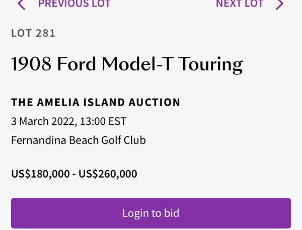

I'm assuming this is the Don Hess car (of disputed provenance) that I saw in Scotland a few years ago.
Re: T #2
Thanks for posting this Stephan. Bonham's does a fantastic job with their photographs. There is a wealth of information there.
What an opportunity to see them.
- Posts: 3743
- Last Name: Wrenn
Re: T #2
Beautiful car. No doubt pull in 6 figures. Too rich for me, ha ha! Oddly if not ironically, the horn bulb bracket sure looks like one of those chintzy $25 re-pop brackets that snap off the minute an over exuberant kid grabs that bulb and starts squeezing it like crazy!

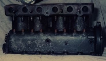

I’d really like more pictures of the motor as after a long conversation with Charlie Shaffer (RIP) I know what he did to convert a 1914 motor into an early (lower than 1000) look a like. He did most of the changes in lead and with a small pocket knife, you can determine the real provenience in a matter of minutes.

Apparently the auction folks are unaware that there are no 1908 Model T's, and never have been. The ones first sold in October 1908 were designated as 1909 models. It's gorgeous, but apparently inauthentic. From what I've read, #2 has been pretty thoroughly debunked. But I confess I've not read the details of the debunking.

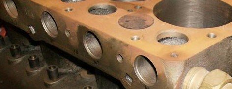

This is right where the serial number would be for one made in 1908.

Has anyone noticed..FWIW, the "serial number" 2 on the auction car is embossed, whereas #220 is STAMPED? Me thinks they woulda been stamped from the get-go but then who am I to say? As far as the engine goes, open it up and then you will know if its the real deal or not. As I understand there was a few internal changes in the blocks for strengthening purposes early on. Like I said earlier, yes it's a gorgeous car as it sits. Just how authentic it REALLY is, well, is any man's guess. It'll still pull in a hefty bid I think. I could be wrong.

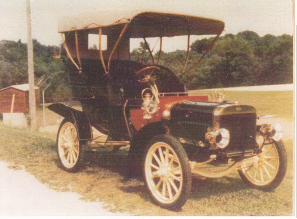

There was a thread on this car a few years ago. I believe it was started by Don Hess's son. It pretty much tell all one needs to know about this particular car. I think Rob is trying to find it. According to Ford, it's a1909 model year car.

Tony B, to replicate a block in the pre 2500 from a 14 block in lead would be no more than a piece of art, functional I doubt very much

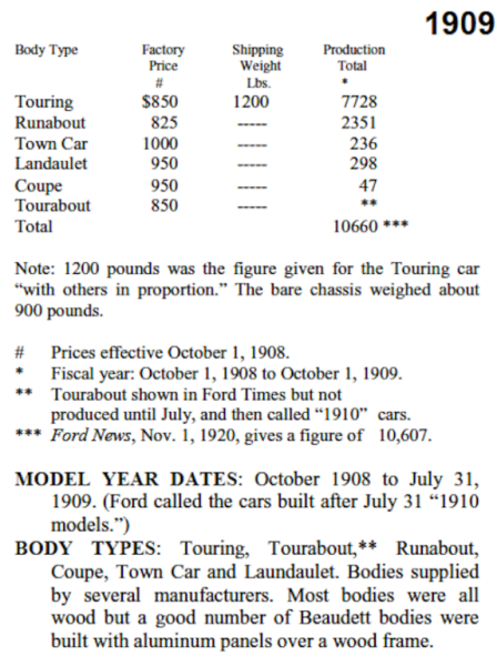

So does that mean that 10660 1909s were built?

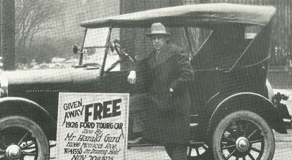

Re: T #2
Burger
Yep, agree, best to just roll with the car company determination of the model year of their car, regardless of the calendar year of mfg.
Here is adv by a dealer of the Improved Car, 1926, it's called out on the sign as a 1926, yet the date of the winning drawing at the base of the sign (partially cut off) reads Nov. 1925, of course that 1926 touring was built in '25!
Plus Ford's series of small adv. placed in periodicals during the early years, always referenced the model year, like today, the buyer would rather drive the newest!

It appears that #2 and #220 both have had the manifold surfaces machined. The threaded plugs they used in the water jackets were never ground smooth at the factory. They used these plugs well into 1913. What I'm driving at is if the surface was ground, how could the 2 and the 220 be so clear?

I’m not sure the numbers are the same shape plus I don’t understand the super imposed raised number 2. Even if you look closely at the 2 stamped under the raised 2 it appears different especially the upper arch of the stamped 2 compared to the other 09 stamping. I don’t see the little round part at the start of the 2, the latter set of 2’s are different. All that said I’ve seen later cars with different stamped numbers so I doubt if that’s a consequence enough to say it’s not genuine, still a really nice looking Early T that I wish I had the means to buy.

The number "2" is not raised. The superimposed stamping is caused by a double strike. The weaker of the 2 strikes is where the hammer bounced off the stamp and re-struck while the stamp moved slightly off location. Not an uncommon thing to happen.JTT3 wrote: ↑Sun Feb 06, 2022 4:04 pmI’m not sure the numbers are the same shape plus I don’t understand the super imposed raised number 2. Even if you look closely at the 2 stamped under the raised 2 it appears different especially the upper arch of the stamped 2 compared to the other 09 stamping. I don’t see the little round part at the start of the 2, the latter set of 2’s are different. All that said still a really nice looking Early T.

The auction hasn't happened yet. The Bonham's website seems very straight forward and simple to me. This is at the top of the page in very big letters:Steve Jelf wrote: ↑Sun Feb 06, 2022 4:07 pmI couldn't even find out when the auction was supposed to be. The car doesn't show up in either Auctions or Results. Bonhams website is user unfriendly and uninformative.
The Amelia Island Auction
March 3, 2022
Fernandina Beach Golf Club
You got plenty of time to register and bid!!!!!!!!!

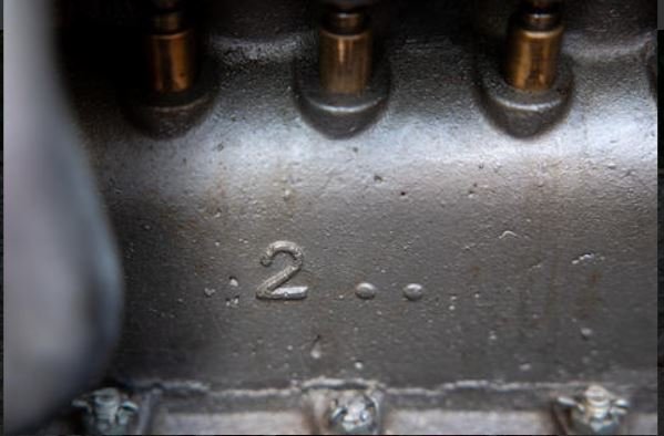

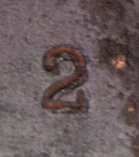

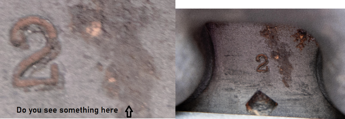

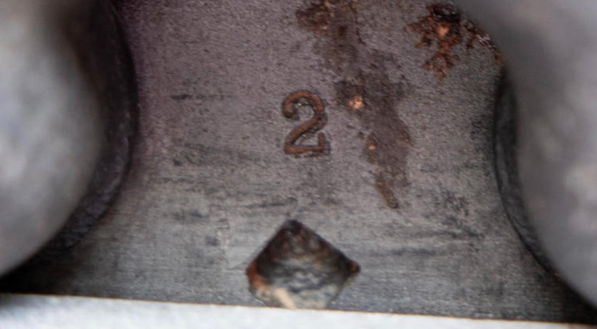

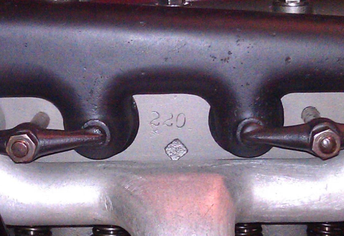

It is possible both #2 and #220 have had the manifold surfaces machined. The core plugs appear to be machined even with the manifold surface, which Ford may have done in 1909. However, by 1913 the core plugs were put in later, and are not flush with the manifold surface.

I believe that Sandy McTavish of Milverton Ontario had several reproduction water pump T engine blocks.

This block 614?? hard to read but has the core plugs machined flush.

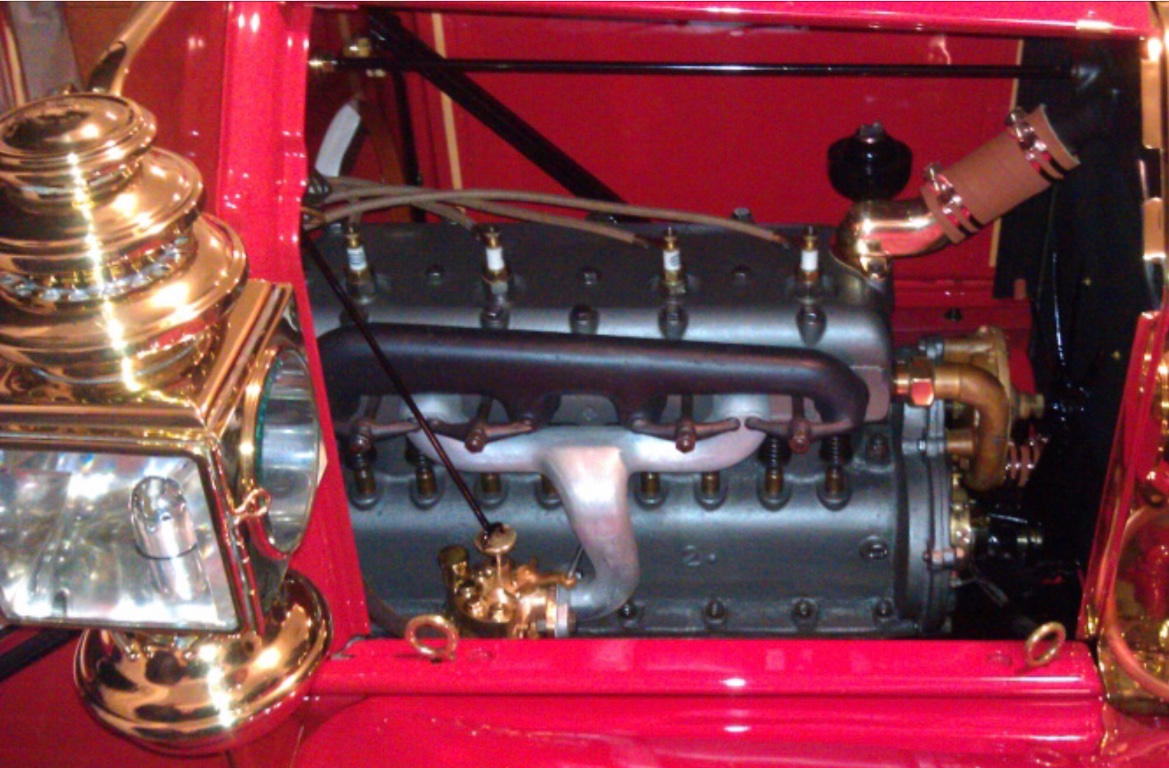

I looked at the photos. One thing that I did notice is in this photo:
That line above the nuts on the bolts joining the block to the oil pan. Wasn't there a discussion about that line in the not-too-distant past? (Last couple of years.) I think Kim Dobbins stated that that was a characteristic of the early blocks. Would a fake actually have that much detail?

The reason for my post was if the manifold surfaces were machined after the core plugs were installed, chances are the engine numbers would have been machined off too. My photo above clearly shows the core plugs were put in afterwards, however, my block is a '13, so perhaps the sequence of operations changed during that period?

Original Smith , the numbers were likely stamped after the engines were assembled !

Please remember these many first thousands of cars were not machined like all the other millions. I would not be surprised if each block laid out by hand on a plate, or stamped with metal templates and drilled one at a time. These cars were assembled on sawhorses, one at a time. To compare these early ones to later machining , doesn’t fly, IMHO
- Posts: 4464
Re: T #2
Pete,pete eastwood wrote: ↑Tue Feb 08, 2022 1:39 pmOriginal Smith , the numbers were likely stamped after the engines were assembled !
I believe he's trying to say that the blocks may have been milled by rebuilders at some point in the car's past, as evidenced by the flush milled plugs that we see. Meaning that any stamping seen today would be re-stamps, in order to get the numbers back. Thereby possibly explaining why we may be seeing inconsistancies in stamped serial numbers today. However, as Original admits, this is only a valid theory if blocks & plugs were not milled flush when first manufactured.

My block pictured above was never rebuilt, it still had its original standard pistons rods and crank etc. In my opinion it was surfaced at Ford in the original machining process. The serial number would have been one of the last steps.

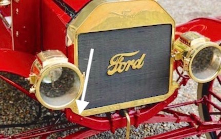

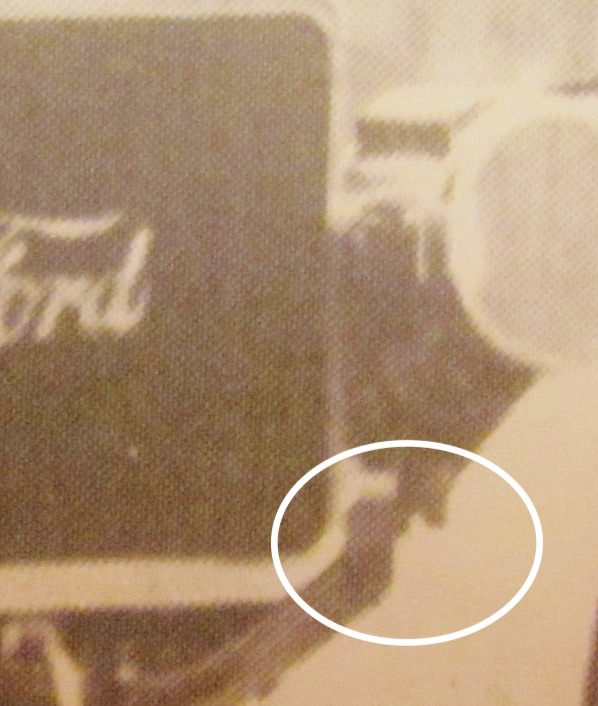

I assume if the car is really #2, it would have been too early for the fish plates? Also, if Don would have known, he could have reconfigured the front frame brackets to look like the first design.

Good point, Larry. I wonder how many cars were made before they started to add the fishplates to the too-weak frames. Trent?

Keith,
I think 2500 is the accepted number. I believe Bruce McCalley (RIP) wrote that portion of the MTFCA encyclopedia (chassis) and indicated 2500. Included in chassis description is the following:
“ I have checked through all of my pictures showing the front cross members of 2500 era cars and ALL of them show the later T-319-B front end spacer EXCEPT one. That is the picture of a Model T at the Piquette plant after its return from a trip with Henry Ford in late September and early October 1908. ”
He also wrote that the first frames were also 1/8” thickness.

Here is some information on the early Model T frames that I have gathered during my research at the Benson Ford Research Center.
The parts for the Model T frame were first drawn on December 10, 1907. Frames were specified to be made of 1/8” steel. This was the same gauge of steel used on NRS frames, which are notoriously weak, especially at the front and rear cross members.
The manufacturer of Model T frames is not known with certainty, but the account payable records of the Ford Motor Company indicate that they were doing a great deal of business with Parish & Bingham of Cleveland, OH during the NRS time period and later. It is known that Parish & Bingham produced Model T frames throughout the production run.
The frames for the first 2500 Model Ts were produced and delivered to the Ford Motor Company’s Piquette Avenue plant by July 1908. In a July 1908 issue of the Ford Times several photographs from around the factor were published. One of the photos shows 2500 frames stacked in the yard at Piquette.
As I mentioned before, the frames of the first 2500 cars were made from 1/8” steel, which was not really suitable for the heavier Model T. The Ford engineers seem to have figured this out only around the middle of September 1908. In order to salvage the first 2500 frames, the Ford engineers designed T-350 Frame Side Member Reinforcement Plate, generally referred to as the “fish plate” today. Two T-350 plates were required for each car, and they were riveted to the inside of the frame rails. The T-350 drawing is dated September 21, 1908, a mere 10 days before the official start of Model T production.
The Frame Side Member Reinforcement Plate was intended only for use on the first 2500 cars. This is indicated by a note in the releases for T-350 calling for only 5000 to be produced (two per frame). Additionally, the drawing for the Side Member Reinforcement is marked “Obsolete on December 4, 1908.
Frames used on cars produced after #2500 used thicker 3/16” steel.
The modifications to the first 2500 frames did not end with the addition of the Frame Side Member Reinforcement. When the frame front end caps T-318 & T319 were redesigned in December 1908, the front end caps of the remaining frames were changed as well. Finally, when the early two-lever control system was abandoned and replaced with the familiar three-pedal control system sometime after car #750, the Controller Quadrant (hand brake ratchet) was also replaced by the more familiar Controller Quadrant used until 1925.

Thank you so very much Trent B for the clarifications! I was really hoping that you would chime in here with that.
I had read it all before (previously posted by you), but lost my bookmarks a few years ago. I considered posting from memory, but sometimes memory is not enough.

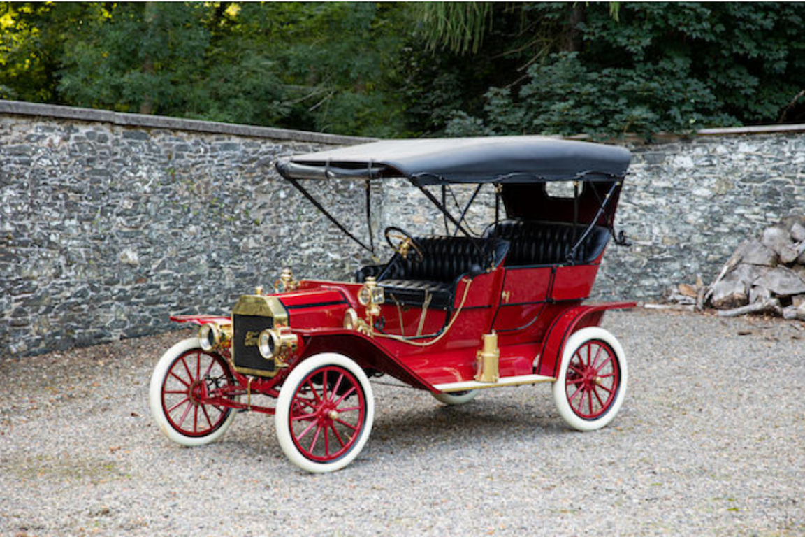

I think Bonham's gave an honest and accurate description of what the car is or isn't. They make no claims that is it truly #2 if you read through the hyperbole.
THE MOTORCAR OFFERED
The car we offer here – stamped with serial number '2' - may well be one of the oldest Model T's in existence. It is a so-called 'two-lever' car, meaning it has two levers on the left floorboard, two pedals on the floor and another two levers (for ignition and throttle) mounted on the steering column. This arrangement was soon superseded by the Model T's famous three-pedal/one-lever layout, with some records noting the change being introduced after the first 500 cars and others the first 800.
In 1908, it is understood chassis numbers '2' to '9' were shipped to the UK for the London Motor Show where many orders were taken. An article in Model T Times describes how a car with serial number 2 was discovered in the 1950s in upper Michigan, USA by the late Richard Teague, which is how the late Donald B Hess got to hear of it.
Donald Hess had a passion for antique automobiles and it is understood restored six in his lifetime. A member of the Antique Automobile Club of America and the Model T Club of America, he purchased this Model T, sight unseen, for $400 in the fall of 1958. The Model T was shipped by rail to Donald Hess's home in Pennsylvania where it was completely dismantled and stored for the next 40 years. Restoration commenced in 1995, much of the car had not survived the years but fortunately Donald Hess had spent many years accumulating a treasure trove of parts and spares for the very earliest Model T Fords. This meant that throughout the exacting restoration, correct and original parts could be used and after six years the finished car was displayed at Hershey in 2001, winning a 1st Prize in the Junior Award category. A scanned copy of Mr Hess's illustrated article on this Model T, published in Model T Times' March/April 2002 edition and showing its numerous interesting early features, is on file. The next owner, a UK based collector, bought the car directly from Donald Hess and brought the car to the United Kingdom where it remained on static display in his collection, the car is now offered directly from his estate.
As with many Motor Cars of this era, time has blurred the story of the car, and many of those who can recount complete histories are no longer with us. This is an incredibly correct early Model T, restored with huge attention to detail, and although it cannot documentarily be proved to have a continuous history as number '2' it is undoubtedly one of the most significant early Fords to come to market. The car is sold on a bill of sale, as it was never registered in the UK. Presented in incredibly correct condition, this Hershey Prize winning Model T would grace any significant collection or museum.
READ LESS

Knowingly Misrepresented
My Manner Is Direct …
Is there any Living Educated Authority
on The Early Model T who will confirm
that this is - without a doubt - # 2 ?
Absent That - Based Upon The Catalog
Summary & Estimated Valuation ….
This car is being knowingly misrepresented
in my slightly educated opinion …
FJ
FJ

Did you read the Bonham's excerpt above your posting? Looks honest to me...FreighTer Jim wrote: ↑Thu Feb 17, 2022 7:05 pmMy Manner Is Direct …

From the auction blurb, it seems the 1909 car #"2" will remain in the UK and prospective buyers won't have I chance to inspect it. Id have a real hard time shelling out that kind of money for a car only represented in pictures. When I saw the car at Hershey in 2001, if was in very nice condition and very well restored. I didn't hear or see the car run. As with any auction purchase, buyer beware, there is ample information out there to make an informed decision.

#220 is pretty original. It has a known history supported by original pictures. There is a couple supporting articles in old Vintage Ford magazines.

However the existence of No. 2 has a red flag for me. The car was extensively restored. I have a problem with anything that is extensively restored. What guarantee does one have that it was No 2. in the beginning.
I guess one has to have faith --- "Ran when parked 50 years ago.", means that after fifty years it still runs.

There are numerous old discussions about #2 & #220 in MTFCA just search for them. What confuses me is why is the #2 colorized somehow and what is the vertical dark smudge to its right. Look at the attached photo and what do you see
Why is there some brass looking splatter too?

That's rust.TRDxB2 wrote: ↑Thu Mar 03, 2022 2:10 pmThere are numerous old discussions about #2 & #220 in MTFCA just search for them. What confuses me is why is the #2 colorized somehow and what is the vertical dark smudge to its right. Look at the attached photo and what do you seeWhy is there some brass looking splatter too?

This discussion heading is about Model T #2 .Herb Iffrig wrote: ↑Thu Mar 03, 2022 3:42 pmOne other thing that I remember that Ed Hausgen told me was that the car was found by his uncle somewhere in Illinois, perhaps at a dealership. I could be wrong about the dealership part. He and his brother bought the car. Ben Snider found out that they had the car and wanted to buy it. Perhaps it was by seeing the article in the magazine I found? Ed's brother wanted to sell the car; Ed did not want to sell it. What Ed told me was that it was a substantial amount at that time, and he relented and let the car go to Mr. Snider. And now we are talking about it 66 years later.
Donald Hess' Father was the owner of Model T #2 to which there has been much speculation . However, documentation details exist about its restoration http://www.mtfca.com/discus/messages/82 ... 1545253902.
Edward Haugen was the owner of Model T #220 being discussed in another discussion. It is the one that Ben Snyder purchased.

Will somebody please explain to me how the hell that cast #2 is supposed to be taken as the engine # ?

If you’re going to create something like this, why not go for the gold and stamp it #1? It would be just as believable.
