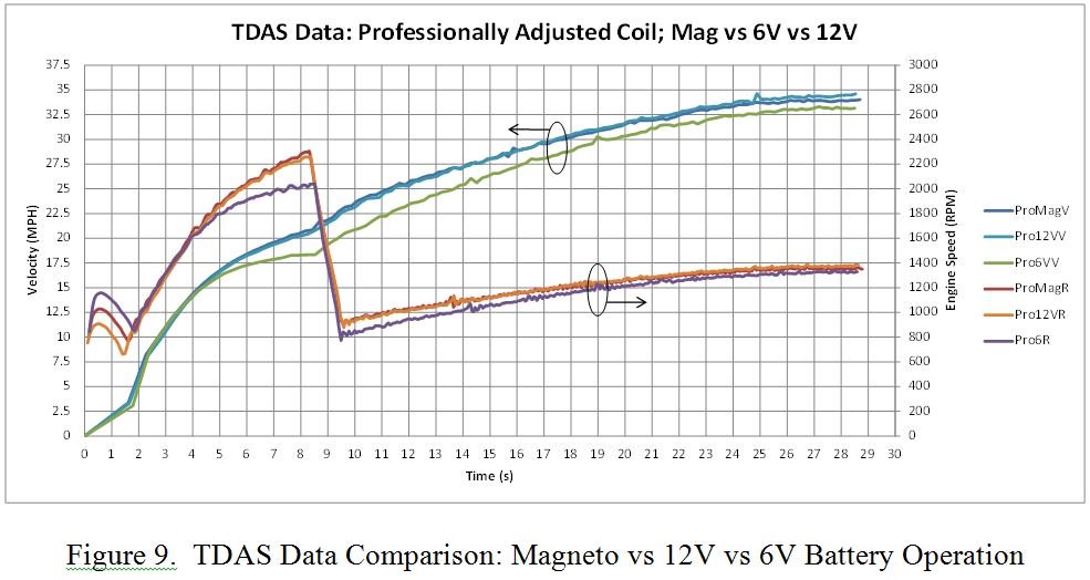

Kevin, I have looked at the firing process on an oscilloscope and have done so rather extensively. Not sure what you mean by efficiency changing between "magneto vs points". The magneto is a source of power and the points are the means by which the magnetic field collapses. The speed in which the coil fires spark (i.e. dwell time to fire spark) will be faster if operated from magneto versus 6V battery. The faster the coil fires spark, the less rotational travel of the engine crank shaft and hence the sooner the spark fires relative to piston position; that is the definition of ignition timing advance. That is what is responsible for engine performance improvement between the ignition operated on magneto versus 6V battery. The speed in which the coil fires spark between magneto and 12V battery is essentially the same so there is no significant improvement in engine performance based on my test data (see chart below comparing engine RPM and vehicle speed vs source of ignition power).
Regardless of the source of coil power, the coil points open at essentially the same level of magnetic core saturation, the magnetic field collapses with the same delay following the contact points opening based on the value of internal capacitor (condenser), the speed in which the field collapses and coil voltage rings (sine wave oscillation caused by alternating exchanges of energy between primary and secondary windings as the ignition arc ignites and burns across the spark plug as energy stored in the coil is released) is also essentially the same regardless of the source of power because that source of power is disconnected from the ignition coil during this process because the contact points are still open during this process; physically disconnecting the coil primary from the source of power.

JohnH makes a good point. By adjusting the range of timer movement relative to piston position (initial timing with spark lever fully retarded) and ensuring the maximum range of timer rotational travel (by replacing all worn linkages) it is possible to advance the spark more. That will result in better engine performance with the longer dwell time to fire spark when operating on 6V battery. A word of caution is in order; setting the initial timing to less than 15 degrees BTDC in effort to extend the range of ignition timing advance reduces the safety margin between safe cranking (piston is on the way down on compression stroke when spark fires) and kick back (piston is on the way up when spark fires). This is another reason why it is very important to eliminate worn linkages and "slop" in the spark lever adjustment of the timer rotational travel. To ensure the accuracy and consistency of timer position with spark lever fully retarded.

Kevin, I would not expect to see much of a difference of spark characteristics between Magneto power and battery power for the reasons I cited earlier. Will look forward to reviewing your Sun Scope screen shots of Model T ignition coil operation this Summer.
