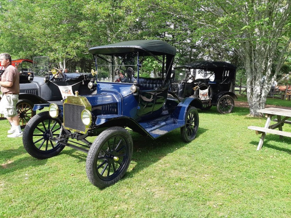

Hi Brian
There is one suggested paint code in the most recent MTFCI judging guidelines. However when I had mine painted a couple years ago and after some research on this forum I ended up with single stage and used a Mercedes Benz dark blue, DB904.
I also like single stage, it can be colour sanded and polished and has been easier to touch up then base clear. And being a regular "commercial" colour, touch up paints are available from various sources too.
The lighting makes a difference in how it looks. The body, fenders and wheels are all the same blue, but in the picture you may see some difference based on light and shadow. It normally looks a bit darker than it appears in the picture.
It was well received at the MTCI 2019 tour on PEI, Canada.
Drive Safe
Jeff
Nova Scotia Canada
Drive Safe
Jeff
Nova Scotia Canada

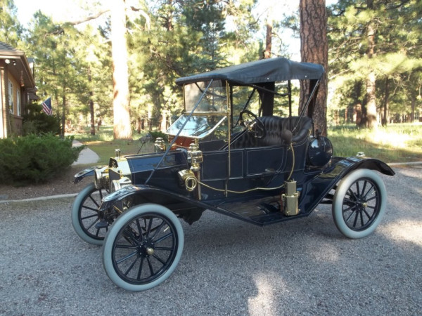

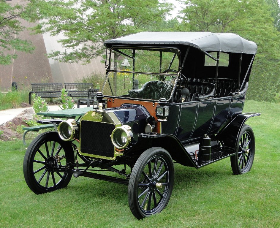

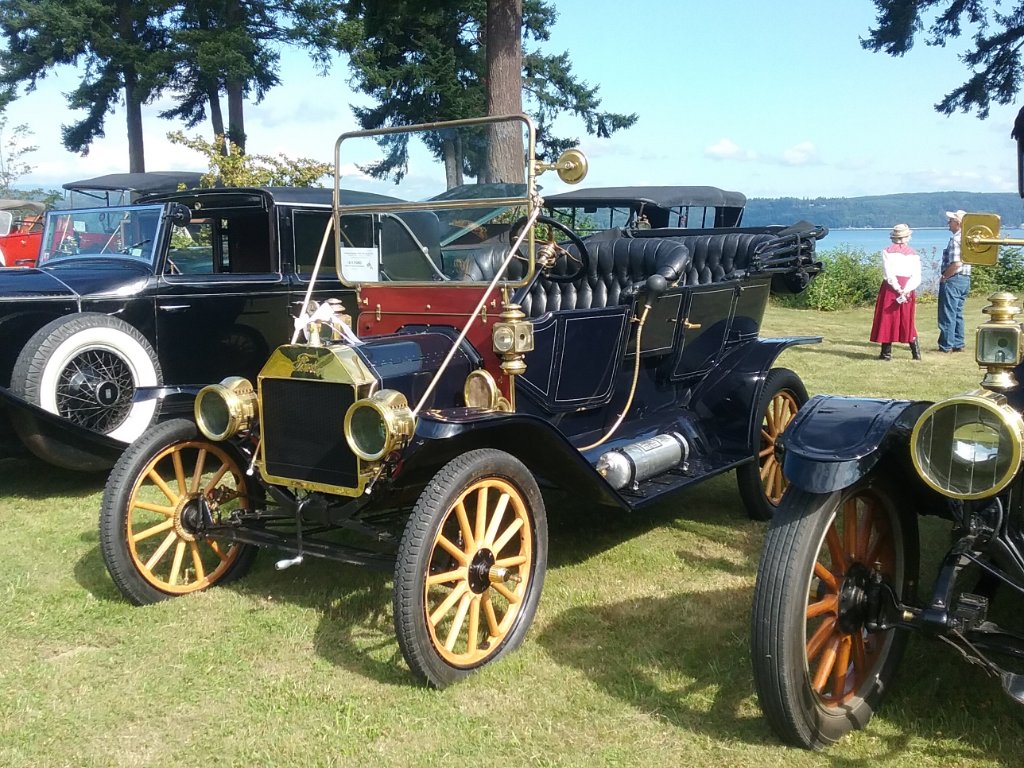

Brian-
The midnight blue on my 1911 is the Diamont Uno 4635 color that Les listed above. It is a Mercedes color, DB322, darker than the Mercedes DB409 color that Jeff painted his car.
For comparison, both the other cars are black.
Keith
Keith

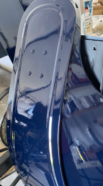

In an effort to mimic Keith Townsend’s 1911 Ford midnight blue, my paint is:
Axalta Centari Acrylic Enamel dark blue Code BS452 with 25% of each gallon being Axalta Centari Acrylic Enamel black Code 99-A . However, I still wanted it even darker so I dumped both gallons of the above mixture into a clean 5 gal bucket and mixed in one additional quart of Axalta Centari Acrylic Enamel black, Code 99-A. This is how I got the rich blue-black that we like.
The fender pic is this “even darker” midnight blue.
The color comparison pic shows before and after I added the final quart of pure black.
