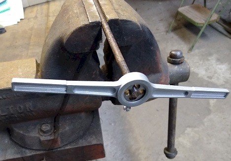

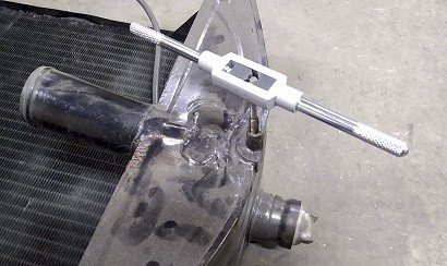

I re-threaded the radiator and found it to be 5/16"-24.
Some time ago the rods for the parking brake looked rusted out and for safety, I replaced them.
As it is they are the same diameter and thread per inch.

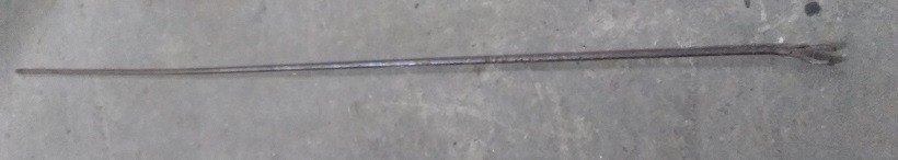

So, I ran a die on the end and cut the other end to length.

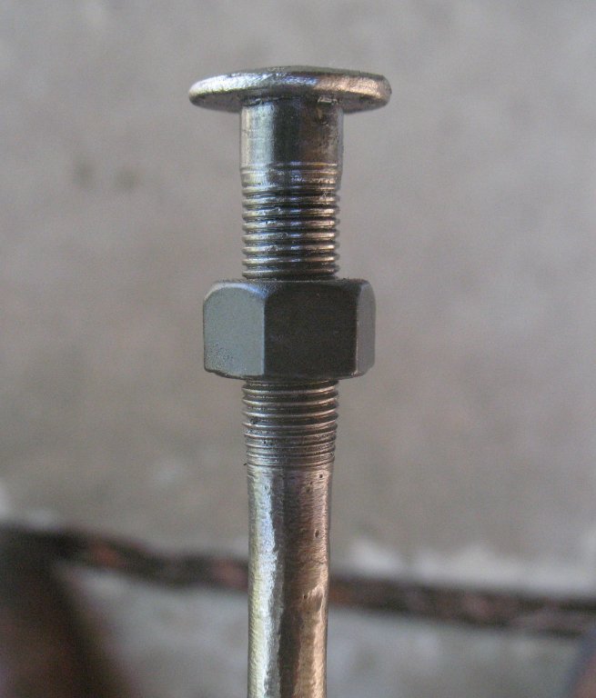

A large carriage bolt sacrificed its head, getting a weld to the end of the rod.
The other parking brake rod I cut for the hood center connection which was also missing.
I think they will both get painted either black or dark green.

I can't quite tell from the picture. Is the carriage bolt a size bigger (3/8") so you can get a nut on it?

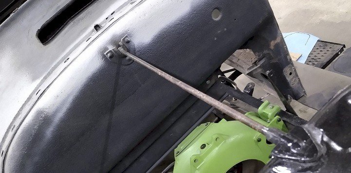

The rod is 5/16" diameter where it engages with the radiator. It needs a lock nut to stop it working on the thread. The other end at the firewall is 3/8" fine thread. It takes a plain hex nut which sandwiches it at the fire wall. This end must be anchored to stop it moving in the 26-7 firewall bracket or where it goes through either a wood or steel firewalls on earlier cars.

I can add a 5/16" fine thread nut on the radiator end.
The firewall side has no thread at all. I merely ran a bead all around the bevel cut and ground it square so that it could not turn.
To Do:
It sounds like I can cut the rod shorter at the firewall, weld on a carriage bolt 3/8" (with a nut already in place).
Vern (Vieux Carre)

The firewall end needs to be anchored. Otherwise the end you have stopped from turning is still free to move fore and aft, either within the bracket on an improved car, or through the firewall on any other. The rod is meant to hold the radiator in a steady position, and make the hood fitting constant.
