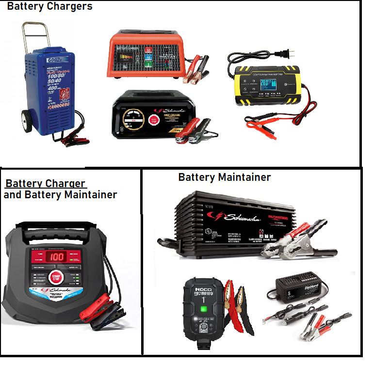

Many times, the Alternator will overheat causing one of three windings in the Stator to "darken", this will happen on early Alt. conversions with an External cooling fan as that is removed as part of the conversion. Newer Alternators that have been converted for use in a Model T have built in internal cooling fans. NO Alternator is designed as a Battery charger a mistake made by many folks even with Modern Vehicles, if you need to jump your car because the Battery is down or Bad trying to recharge it by driving only will cause the Alternator to overheat & possibly due Damage. It does not matter whether you have an Alternator or Generator the System needs a Good battery to preform properly & neither are a battery charger. On those with a Roll pin for gear retention it helps to run a Non-metallic safety wire thru the Pin & around the gear. George

Just so there is no confusion on the statement "NO Alternator is designed as a Battery charger"
An alternator is responsible for charging your car battery while driving. (maintaining...)
https://www.firestonecompleteautocare.c ... rnator-do/
However an alternator is not design to charge a dead or deeply-discharged battery.
https://www.optimabatteries.com/experie ... -batteries --
Battery Chargers vs Maintainers
