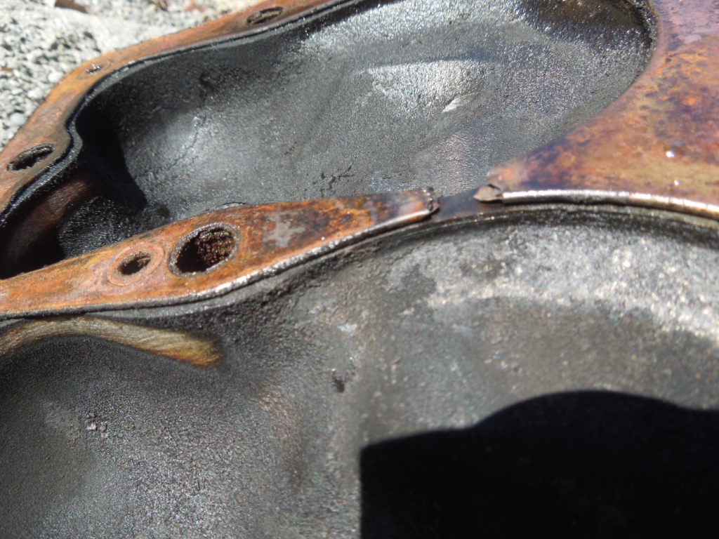

The reasons head gaskets fail, and normally at the center bolts, is the narrow gap between cylinders with Ford design (which you can't fix).

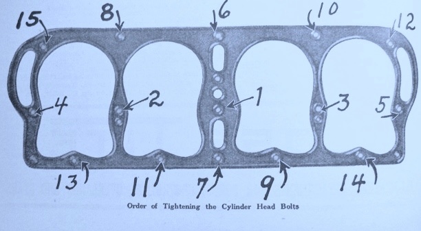

But you can minimize this with a new gasket so it will crush and seal, and be sure to use the Ford Method, after running down all the head bolts, of starting your torque sequence at the center of the head, to seal the midline of the head, then random out to the edges. That will clamp the center of the head first, and help prevent gasket failure. Of course the head and block surfaces should be true, flat, and the alum head without warp.
