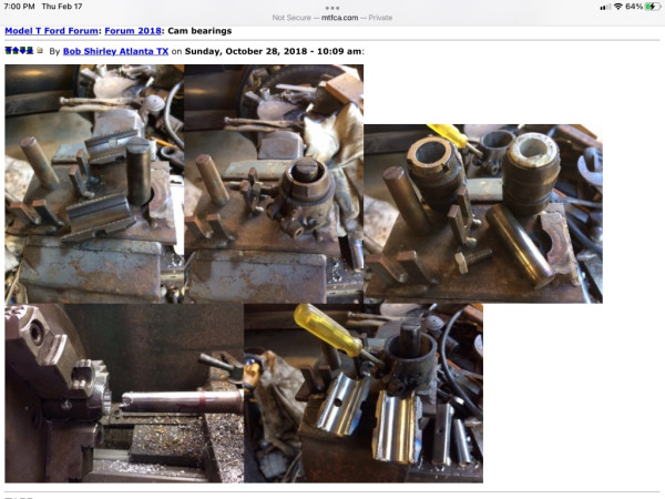

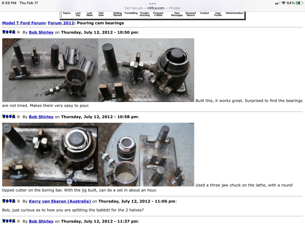

At one time Gaslight had at least a thousand raw castings of the bearings, they needed machined and poured then split?
- Posts: 5549
Re: Camshaft bearings repoured
http://www.mtfca.com/discus/messages/25 ... 1342157696
http://www.mtfca.com/discus/messages/41 ... 1395236094
Looking at that last link, it looks like the Babbitt is either not poured where the 2 halves meet (two ladles, mold having ridges on each side at the split) or after they are poured, the Babbitt is cut away. Guess it could be done with a hacksaw by cutting down to the shell, like cutting a bushing to remove it.

Once upon a time I made up a V shaped broaching tool to cut the Babbitt after the bearing bore was finished. The bearing is already in the lathe... might as well use the lathe to do all the work that needs to be done
Sean Butler
- Posts: 180
- Joined: Sun Jan 06, 2019 12:22 pm
- First Name: Sean
- Last Name: Butler
- * REQUIRED* Type and Year of Model Ts owned: 1911 Touring
- Location: Huntington Beach, CA
I, too, have used Kevin's broaching method. As he states, you've already got the bearing chucked up in the lathe. It also makes for a more professional looking job. Originally, I used Mark's hacksaw method.
