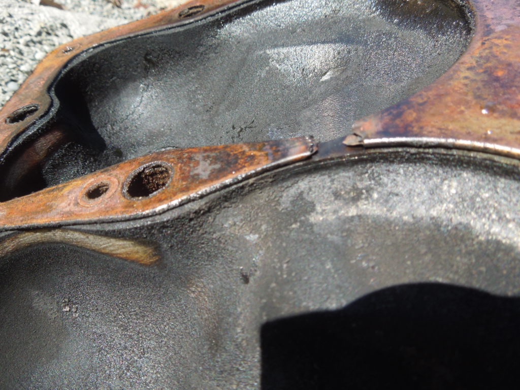

Have replaced busted gasket on Z head on tour, all that was avail. was a new steel gasket, sealed with high metallic content alum spray paint. Worked fine, still running.
While the Instruction Sheet with the Z head recommends using a new copper gasket, the key word is "new"! You don't want to reuse a head gasket that has already been crushed in torque of the head bolts to seal it.
The reasons head gaskets fail, and normally at the center bolts, is the narrow gap between cylinders with Ford design (which you can't fix).

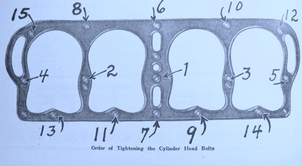

But you can minimize this with a new gasket so it will crush and seal, and be sure to use the Ford Method, after running down all the head bolts, of starting your torque sequence at the center of the head, to seal the midline of the head, then random out to the edges. That will clamp the center of the head first, and help prevent gasket failure. Of course the head and block surfaces should be true, flat, and the alum head without warp.
