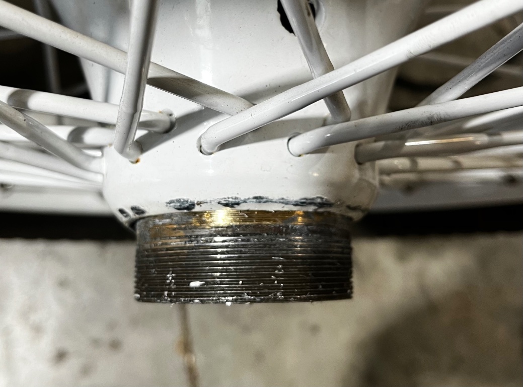

Still new to this hobby.
Just finished regreasing my front wheel bearings.
Went for a test ride today and right front threaded center hub which holds on my wire wheels had loosened up after about 4-5 miles
Fortunately I stopped before it came off completely. I had used a 5 pound sledge hammer on a 1 foot long wrench to tighten the front wheels so I was surprised this happened
The right side hub uses right hand thread while the left side uses left hand thread
This is the way my T came to me but should they be reversed left to right side.
Or do I need a 10 pound sledge and a big application of lock tight.
Appreciate your recommendation.

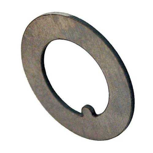

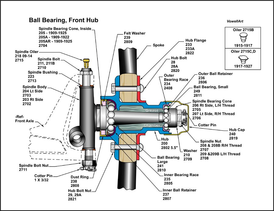

The lock washer has a tab on the inside (hole) of the washer. This slots into the groove on the spindle so the washer cannot spin.
assembly order: bearing / lock washer / castle nut / cotter pin/hub cap.
Jack up axle, spin wheel, keep tightening the (xx castle xx) nut on the end of the bearing until the wheel is firm but free spinning, no "in and out" movement on the spindle, then tighten the castle nut until you can fit the cotter pin in.
Sometimes, you may need to pack out the castle nut with a thin washer between the lock washer and the castle nut to be sure the cotter pin is snogged into a castle nut slot..
Glad to have you in the hobby and DON'T Worry! we ALL have gotten things a bit wrong - that's the beauty of the forum and the club branches, they are here to help.
I would recommend getting copies of the club booklets on maintenance and repair of each part of the car - they will explain set up of each part - including the steering/ camber/ linkages.

Adrian, what you are describing is as most cars are but the T outer bearing cone is threaded and the castle nut is a lock nut + cotter.

I will paraphrase the left hand/right hand answer. The bearings are threaded as if to loosen when driving, or to unscrew while driving. If you rotate the wheel as if driving forward will the bearing and nut tighten or loosen? If they were to tighten while driving forward they will lock up and seize. The toothed washer, nut and cotter pin will prevent the bearing from actually loosening or coming off, they will not, however, prevent the bearing from tightening up if the spindles are on the wrong side of the car.
If your spindles are reversed you may have other issues too. Look at your spring perches and see if the little center nub is offset to the front or offset to the rear. It should be offset to the rear to give the correct steering and tracking.

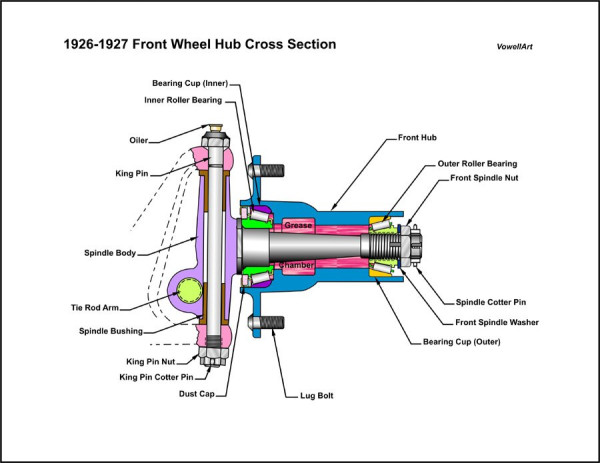

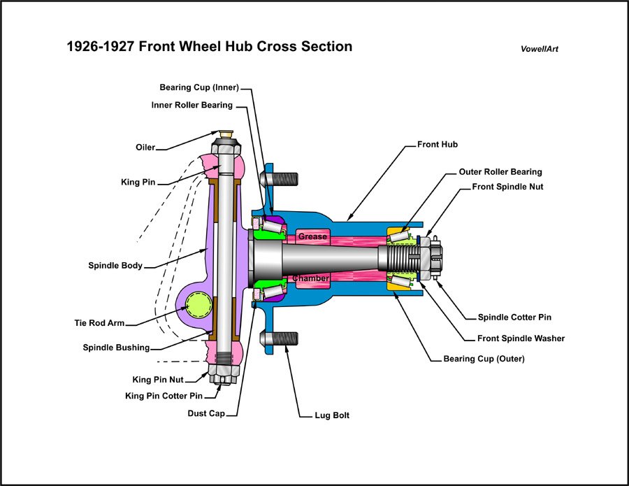

Re: Left hand thread vs right hand thread on front hubs
here an other drawing from Vowell art that explain the right and left thread.
Good luck
Andre
Belgium
Good luck
Andre
Belgium

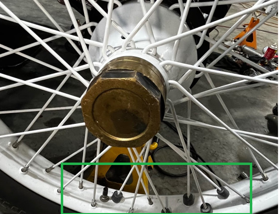

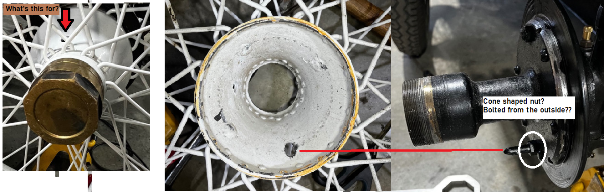

Will, if you can post a photo of your setup it may help us understand your question. This is a great place to ask, as the knowledge here is awsome.
- Posts: 4681
Need a picture to see what kind of wire wheels you have. Since you said “wire wheels” that would determine exactly what your talking about. Could be the Buffalo type wire wheels or it could be 26-27 T wheels. A picture says a thousand words. Either way something is causing the wheels to keep working loose.

searching Will's few posts easily brought up the fact that he DOES indeed have aftermarket wire wheels (very nice looking little car), so the question remains, "exactly what is coming loose?". Until that is answered, everything is speculation...and I do hope he will respond with details. At the very least, if it is the wire wheel's "cap" coming loose, I still would not want to beat on it to keep it on...
Will...where are you?

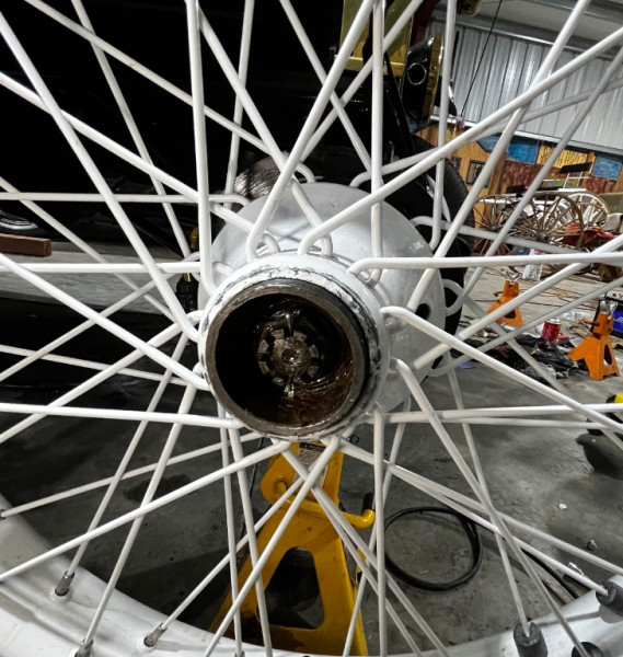

- Posts: 6581

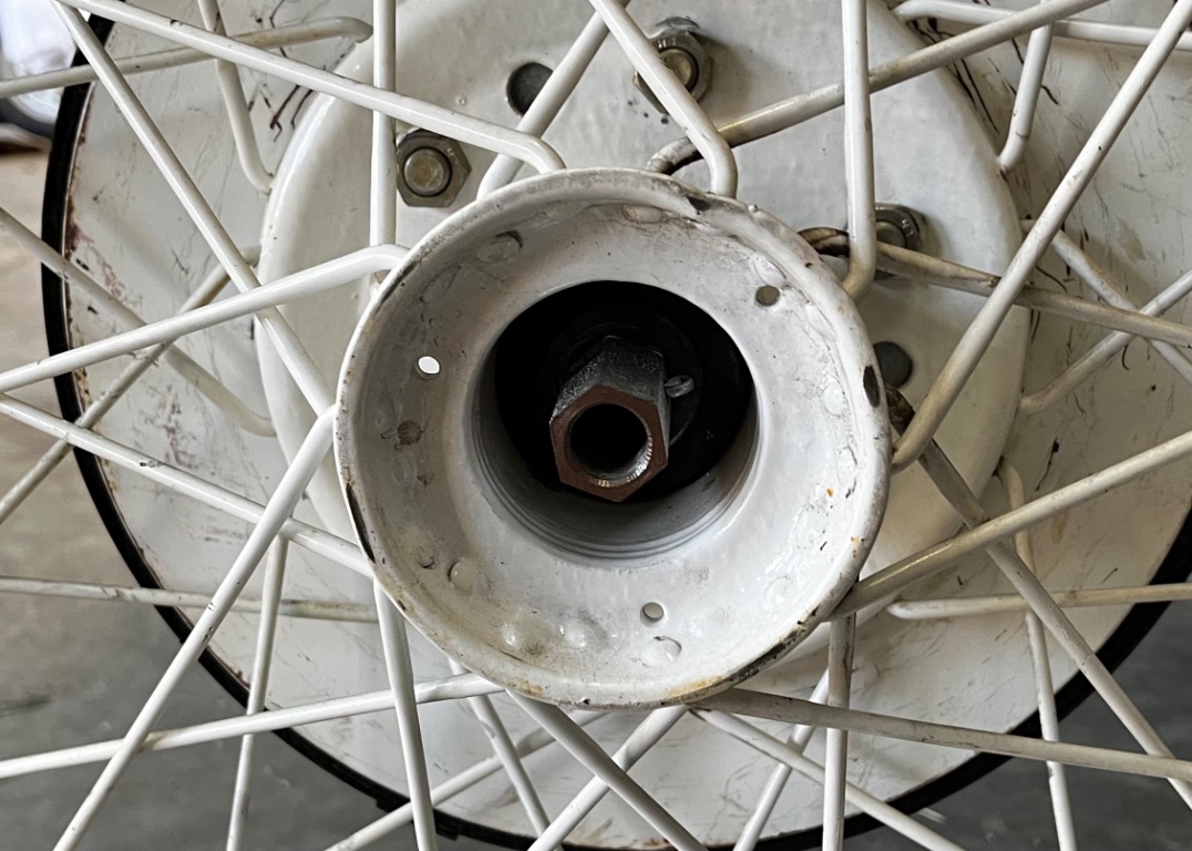

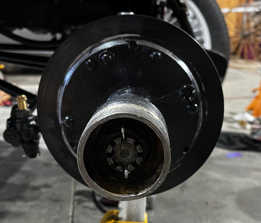

As stated above the description of the problem needs a bit a clarity to eliminate assumptions. A close up of the front wheel would helpWillsT wrote: ↑Thu Feb 10, 2022 10:42 pmS.... Just finished regreasing my front wheel bearings.
.....I had used a 5 pound sledge hammer on a 1 foot long wrench to tighten the front wheels so I was surprised this happened
The right side hub uses right hand thread while the left side uses left hand thread. This is the way my T came to me but should they be reversed left to right side...
-right front threaded center hub which holds on my wire wheels what brand wire wheels?
-I had used a 5 pound sledge hammer on a 1 foot long wrench to tighten the front wheels lugs, hub nuts , ?
-The right side hub uses right hand thread while the left side uses left hand thread is right based on sitting in the drivers seat?
If the "right and left" sides are based on sitting in the drivers seat and as he says "The right side hub uses right hand thread while the left side uses left hand thread" would you expect things to tighten. http://www.mtfca.com/discus/messages/41 ... 1392932768
- Attachments
- buff hub.png (406.45 KiB) Viewed 12343 times
- Posts: 5252
Yes could be wheel hubs on the wrong sides. I dont see any locking pin/ratchet. They look similar to Pasco 's. Pascos had a thin lock nut under the hub cap. If those are missing... Either way, dangerous to drive until sorted out.
I recall stories of a non locking buffalo capped wheel coming off during a tour in the country. Fortunately no one was injured, including the T, but the wheel flew away & an Easter egg hunt ensued.

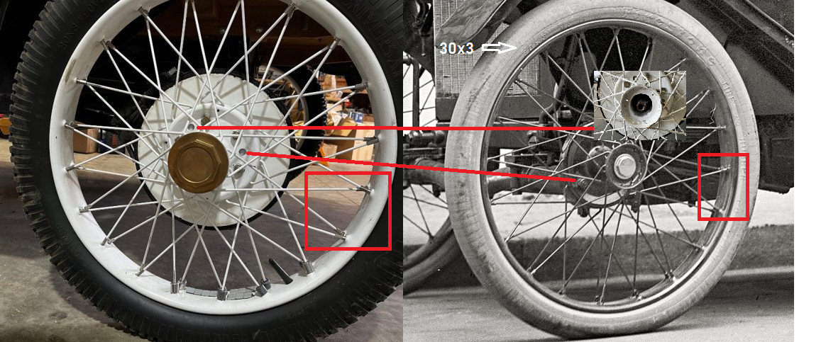

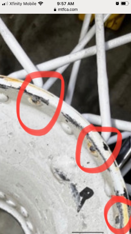

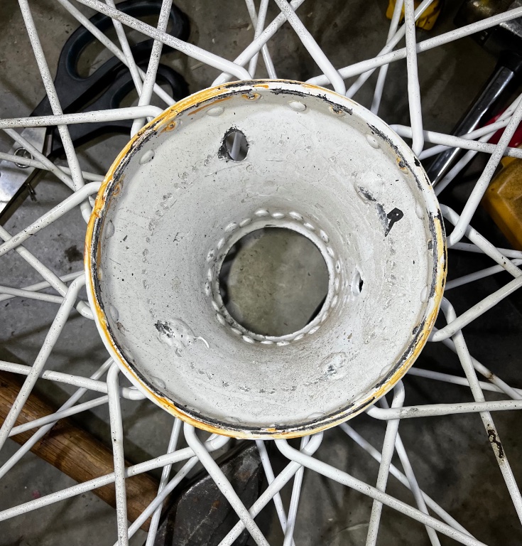

Those are not common wire wheels, so my reply is of a general nature. Wire wheel hubcaps that have internal threads will have left-hand threads on the right side of the car and right hand threads on the left side. This would apply to Houk, Dayton Pin Drive and Buffalo wheels.
Caps that use an external thread will have RH threads on the right side and left hand threads on the left side. An example of this would be Dayton dental drive wheels.
Many accessory wheels utilize some type of ratchet or pawl locking mechanism to help retain the hub cap. These are designed so that the factory wrench depresses a locking lever in the cap allowing the spring loaded lock to release during installation and removal. Many reproduction Buffalo hubs and caps have been made over the years that did not have this feature, and its important to check your caps for tightness every time you take the car out of the garage.
Most knockoff style caps never had locks, and those seem to stay tight - at least as well as any other cap, but its important to check those as well.
A common issue that causes wheels to come loose is excessive paint buildup on the hub/wheel center mating surfaces. Layers of paint deform and move allowing the wheel to come loose.
Perhaps post a picture of your wheel hub, cap etc, and we can offer more help.

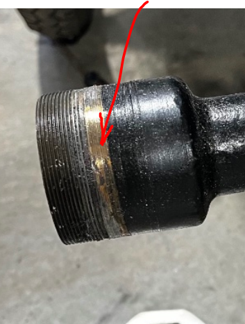

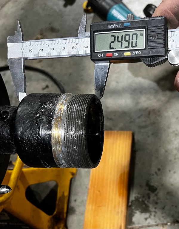

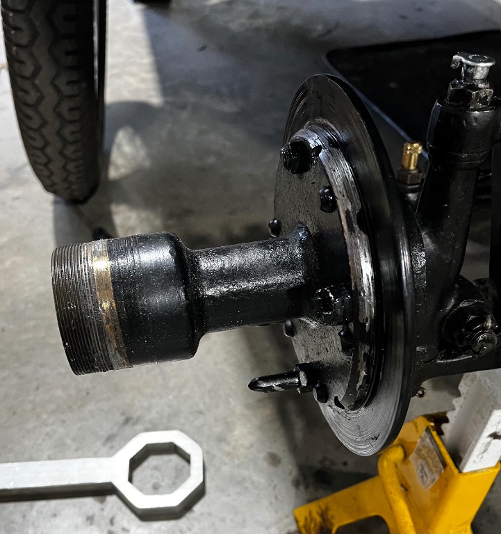

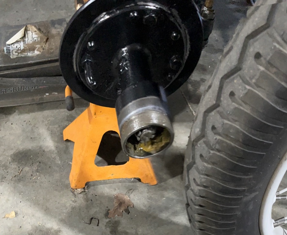

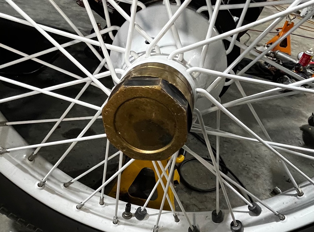

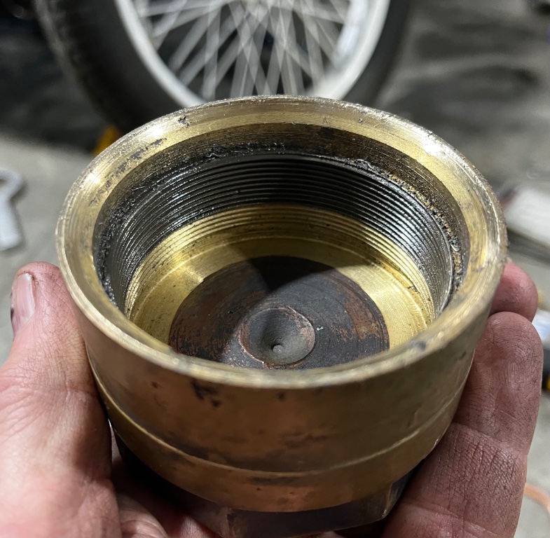

WillsT
Topic author - Posts: 28
- Joined: Sat Nov 27, 2021 12:54 am
- First Name: Will
- Last Name: Snyders
- * REQUIRED* Type and Year of Model Ts owned: 1915 Roadster Pickup
- Location: Penn Valley
Wow what a great a great set of replies thanks for all of your input

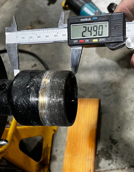

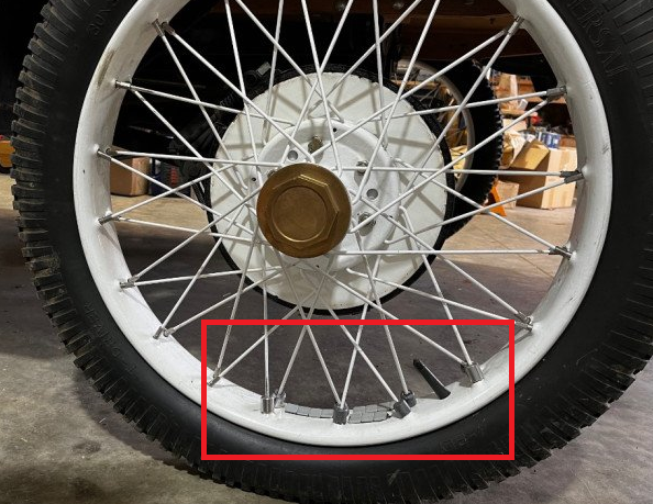

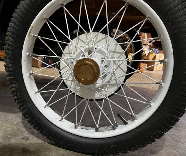

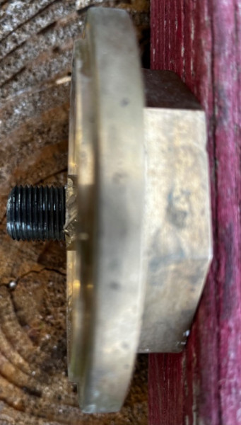

My front wheels have a separate set of hubs which hold the bearings and this hub, without wheel, is put on the spindle and held in place with castle nut and a cotter pin. No problems there
The wheel is then put on over the hub, there is a flange on the inside which centers the inside of wheel and the threaded center hubcap which centers the outside of the wheel and locks it in place
My other car, Buick, has Buffaloes and works about the same except it has 2 hubcaps that both screw on with the 2nd one is counter threaded and acts like a lock nut

Ok, here are some pictures of hub and wheel separate and once mounted
I have no issue with mounting the hub with two bearings castle nut and cotter pin
Everything stays in place and functions normally
The wheel slides over the hub and and is kept in place with the threaded hub cap/nut
This cap/nut is what comes loose after driving short distance

Missed picture of hub and castle nut holding it in place
After reading Dan’s. Post and browsing the Jaguar E-type forum where the E uses knock off wire wheels there seems to be agreement that the the hubs with the right hand thread for the hubcap should be on the left, or drivers, side and the hub with the left hand thread should be on the right side.
This is opposite to the way my T came so I will interchange the two and go for another test

Is the 1 pin what drives, locates, the wheel. I can see the shoulder on the inside. Would be interesting to see the rears apart.
- Posts: 6581
Have the same question. Guessing that the pin likely keeps the wheel from spinning on the hub and the hub cap keeps it against the hub, Wonder if the nut resting against the hub is goes on the outside of the rim and tightened. There is also another hole on the wheel hub - lock nut hole?

You guys are correct the pin on the hub goes through the hole in the wheel and prevents the two from slipping relative to each other
My buffalos has something similar where there are recesses in the wheel for the 6 mounting nuts that hold the hub to the spindle
The buffalos also use the same hubs on all 4 wheels, so wheels are identical on all 4 corners.
The other hole on the front wheel hub is in the center and had no purpose that I know of

Is the cup on the inside of the wheel properly engaging the cone on the hub? From the image of the scuffed black paint it appears to me the wheel is sitting on the lip/edge of the hub cone, and should go on another 1/4" or so? I doubt the black paint is the problem. And the hubcap appears to have plenty of thread and end clearance to tighten several more turns, which suggests (to me ) that the wheel is not fully engaging with the cone of the hub?
Beautiful vehicle, especially the wheels, I like the wheel balancing weights on the spokes. Best, jb
- Posts: 6799
As nice as they look from a distance, now that I've seen them close up, I would not drive on them. Dan McE has pointed out and commented on some things which I would have mentioned if he hadn't. The front hubs plain old frighten me.
I think it is a cosmetically nice application with some clever machining done to effect it. Unfortunately there appears to be little if any real design put into it and simply looks hazardous as it is. Worse, I do not see how they could be easily modified to take the forces that are routinely applied to them when driving.
I highly suspect that if these wheels have been on this car for any length of time it is because this car was a trailer-queen. Despite their attractiveness, I personally would not put much time/energy into trying to make these work. Model T's come with plenty of built-in hazards as they stand, without adding a home-made wheel setup into the mix.

To add to others concerns, it scares me to think that the threaded nose on the hubs appear to be a brazed-on addition.

I suspect that this bronze ring is from the hub cap running on the hub surface...
- Posts: 8641

Lookin at the pics again... seems like the spoke ends could be crashing on the hub prior to the wheel seating on the hub fully. This erroneous seating of the wheel would cause the hub cap to tighten, but the hub/spoke heads would deform rapidly causing the assembly to work loose. Check for corresponding wear dimples on the hubs

Note differences in rim shape and valve stems... and spoke weights Front vs Rear (with lead weights)
Front --
Rear
Front --
Rear

Is the brass deposit on the inboard part of the hub threads actually brass threads pulled off another hub nut? If so, wouldn't it prevent the nut from tightening properly on the wheel's hub? Do these wheels make odd noises, like pops, squeaks, creaks, or thumps when going down the road?

First of all this car is no trailer queen, but a very nice driver, need to sand and redo the wooden box and fix paint in a couple of places.
Talked to previous owner and the wire wheels been on this car for 7-8 years on many tours without any issues.
I have only owned this car since October and have maybe 25 miles on car while fixing fuel issues and getting it to drive in a straight line, both items now resolved.
Took the other front wheel off and you can see a nice clean thread on the hub useable over the whole range of .66 inch, see picture
The hub in issue has some damage because the hub nut was half off which created the bare brass visible
Also the thread on the hub was not useable over the last .16 inch. Due to loose wheel or maybe before will never know
The useable part of the hub is just what is needed to tighten the wheel onto the hub within measurement error.
So did the hub nut stop turning because the thread was limiting or because wheel was tight ?
To remove this question I cleaned up the remaining .16 of the thread and the hub nut now travels the full .66 inch of thread without stopping without wheel in place, so hub nut will now stop when wheel is tight only.

May have found a possible match for the rear. Several past discussions about trying to ID them, all that was said that they were on a Monroe Auto. The rear hubs appear to be drilled out to match the T bolt pattern - note the 3 holes to mount on the original hubs on the the white wheel
Just found this scroll down to see info https://www.hemmings.com/stories/article/nobodys-dust
WHEELS & TIRES Wheels: Detachable Detroit Stanweld wire Front/rear: 30 x 3 inches --
http://www.mtfca.com/discus/messages/599638/696044.html
http://www.mtfca.com/discus/messages/11 ... 1293118764 --
http://www.viathema.com/chevrolet/ --

The rear's appear to be used on Cyclecars of that era https://auta5p-eu.translate.goog/katalo ... x_tr_hl=en
