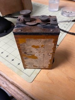

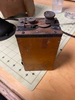

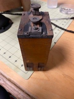

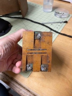

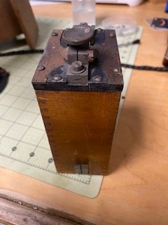

I picked this coil up in Findlay Ohio at Jefferies Antique Mall last weekend. I have a few boxes of coils but never seen one like this so of coarse I had to buy it (along with several other things
). Is this a Heinz coil? It sorta looks like some pictures I have seen but has a few differences. Experts?

A Heinze coil of that vintage might have the word "Heinze" engraved in a circle on the nuts on top of it.

The pictures I have seen only have 1 adjustment screw. This one has two obviously and the only writing on it says "Adjust Here".

Looks like a Heinze to me.
Forum search found this from the late great early coil expert
http://www.mtfca.com/discus/messages/82 ... 1531856913
Seems that coil came from a Model K Ford!

Dan nailed it! Model K coil....... Guess I'll polish it up and start looking for a Model K to put it in
