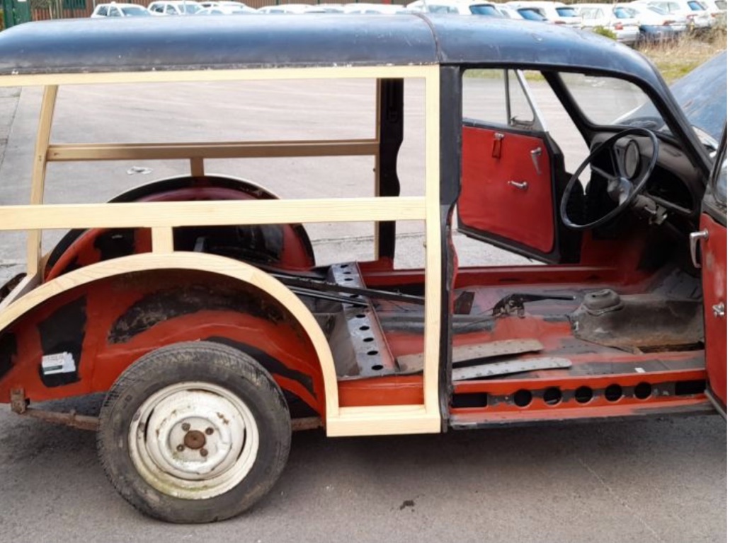

Yep. three down and three over is a somewhat nicer version of mine.
The frame is installed. The installer did the best he could with a janky kit from a well known Morris supplier.

That's not correct. The framework is structural. The panels are infil. The vehicle is unibody as in does not have a separate chassis but from the front cab section back the Ash frame is the body structure.
https://www.footmanjames.co.uk/assets/i ... resto2.jpg
https://www.morrisminorowners.co.uk/swa ... dframe.JPG
Dropacent
Posts: 3384
Last Name: Morsher
Location: Norwalk Ohio
Re: How to fill joint gaps in Ash wood framing
Post by Dropacent » Sun Feb 13, 2022 8:44 pm
Yup, sure looks structural to me !

My apologies folks. My first hand experience with the Austin 7 mini traveller is different. In this case, the mini traveller is based on the mini van. The timbers are purely decorative in this application. They were affixed to the body with screws through the bodywork from the inside.
