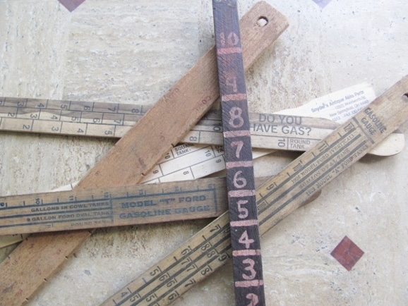

When in need, I've used a literal stick. I really only have three measurements.
That's a lot of gas
I'm OK on gas
Geez, I better get some gas

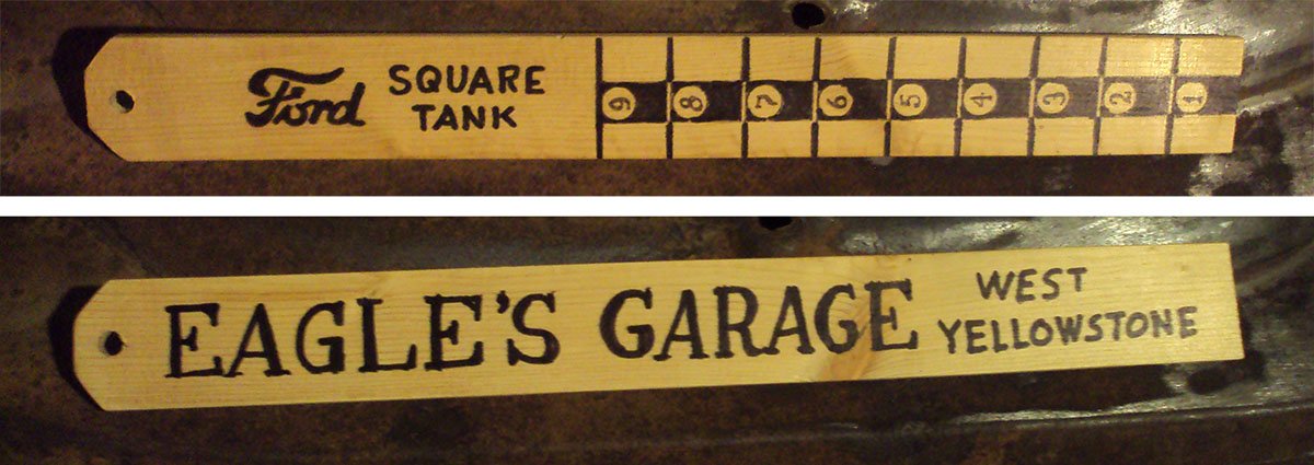

Have a few from over the years. The one with the small notches on the edges was cute, someone made those with a pen knife I would guess.
The flat black painted one with white model airplane dope numerals and lines is one I made as a teenager, it works well too, can still see the wet gas line easily. Maybe was thinking ahead that at one time my eyes would need large number font! :lol:

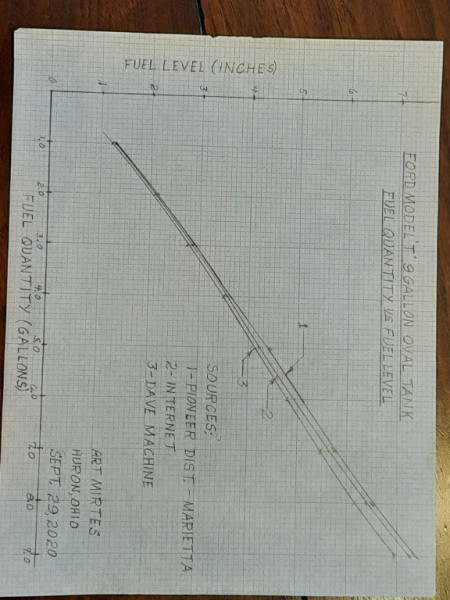

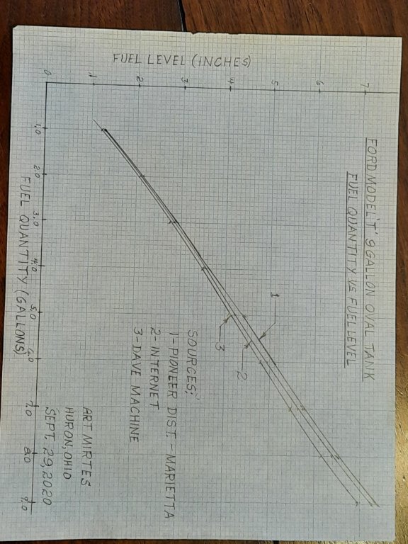

I was interested in the fuel level vs volume. I found 2 calibrated sticks from various vendors and a chart on the internet. These were plotted as shown on the attachment.
Bottom line. I keep the level above half way, because I never know when Tim will lead us to a 8 percent grade.
Art Mirtes

Post by Art M » Wed Feb 16, 2022 5:09 pm
Having trouble

Post by Art M » Wed Feb 16, 2022 6:32 pm
Tim came to my rescue.
