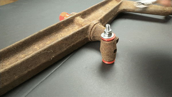

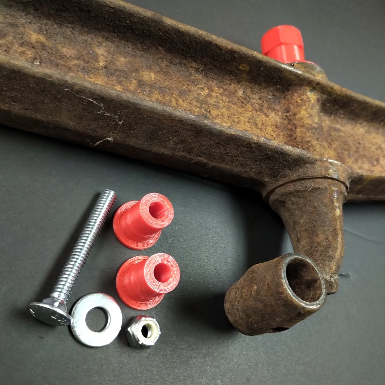

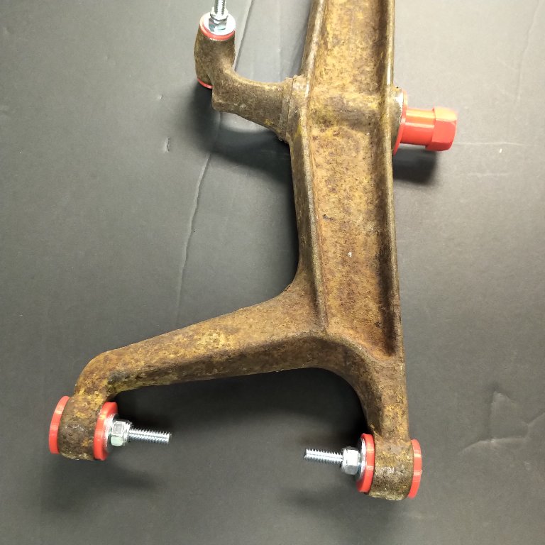

Going to sandblast a front axle, and wanted to protect some of the surfaces. Will try 3D-printed caps and plugs.

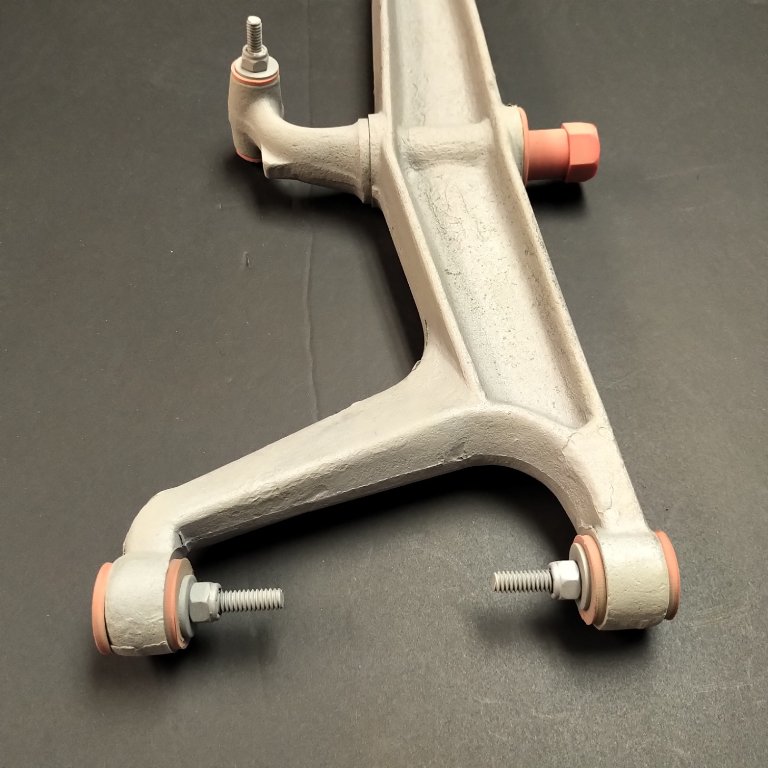

The masks survived blasting, and worked well.
