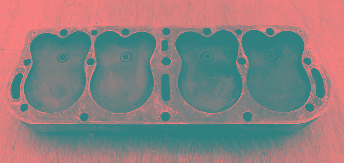

[image]Image[/image]
Looking for any details about any of the the aluminum high-compression low heads that have been on the market place over the last 50 or so years. Details and photos of these heads are hard to find, other than it has been reported that the most recents ones manufactured are said to have a 6.0:1 compression ratio.
I'm looking for photos of the combustion chambers of any one of these heads which have been manufactured recently.

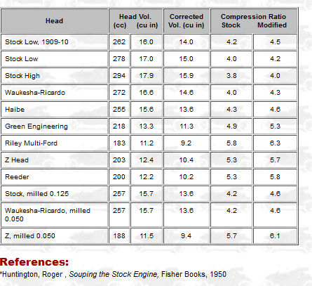

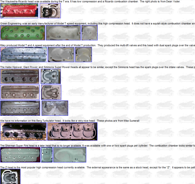

Post by TRDxB2 » Sat Feb 19, 2022 7:00 pm
Here is a comprehensive comparison of several heads done in 2011 I believe http://mtfctulsa.com/Tech/heads.htm
You'll need to navigate through several pages to see it all
compression ratios.png (104.58 KiB) Viewed 4050 times

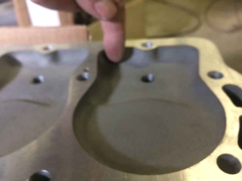

Re: Aluminum High Compression Low Head Details
Post by Kevin Pharis » Mon Mar 07, 2022 11:54 pm

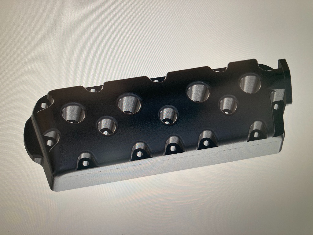

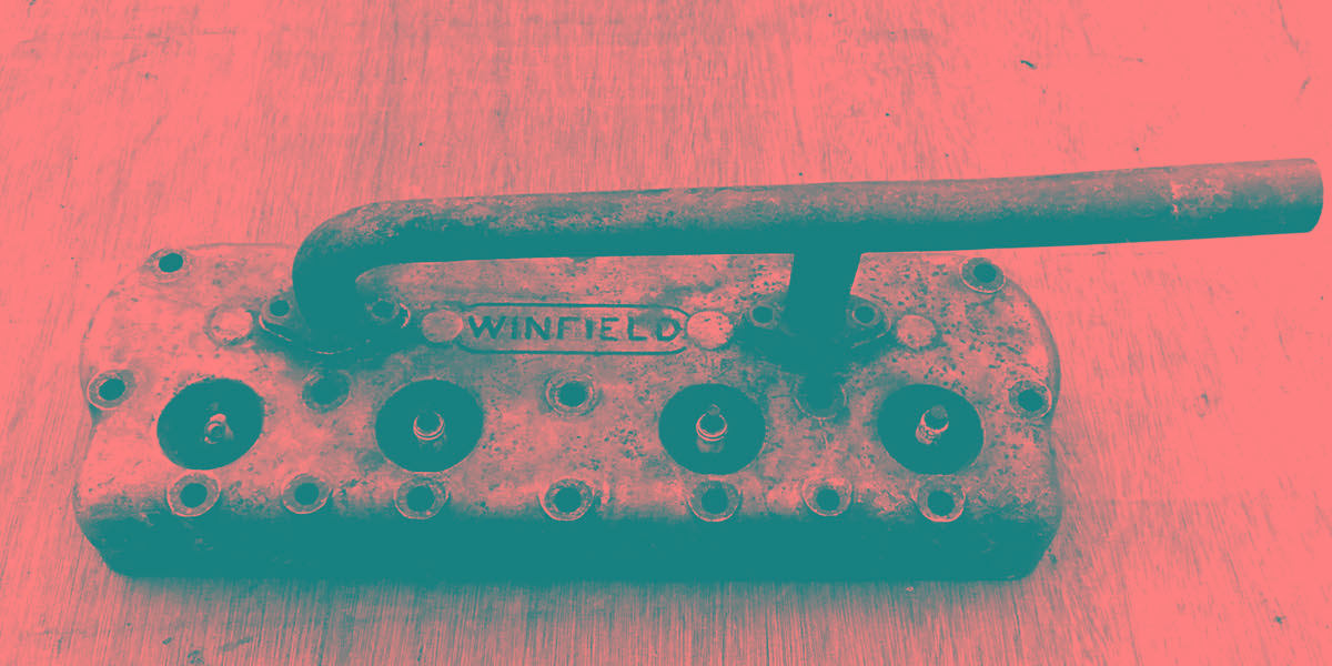

After pondering how to build a new Winfield head for several years, a little inspiration and curiosity yields something very similar to a Green. Better pics, or better yet measurements, and a little more patience could get a design that’s really close to an original...
Very nice work! Have you ever gotten involved with casting something like this? After having recast and machined several pre-WW1 engine blocks recently, the old-fashioned way with wooden patterns - modern cad design and core printing is the way I would do it from now on.
Have you even been involved with a casting with printed cores? Any chance you might may do a Winfield head? I've been thinking of talking with friend Lee Stohr at https://www.stohrdesign.com/ about doing a Green head if I decide to go down that road.

Perhaps another option would be an original, never used Winfield head from the day the racer was shaking up the racing world?
It is interesting that Winfield never cast a water inlet in his head. He used two inlets on top of the head with a manifold arrangement
similar to an exhaust header to transfer coolant. I expect it reduced the water capacity in the head, but provided more equal cooling.
Harry

Harry Lillo wrote:
Tue Mar 08, 2022 10:04 am
Harry
Let’s see this mythical creature...

Post by Harry Lillo » Tue Mar 08, 2022 11:31 am
Kevin,
I am in Panama right now so don't have ready access to get you pictures.
I purchased it a quite a number of years ago from another collector.
When I get home next month I will get you some pictures.
Harry

As close as I’ve ever been to a real Winfield...

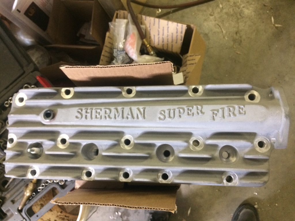

Sherman head pictures

Kevin,
That looks like the brother to my unicorn!!
Harry
