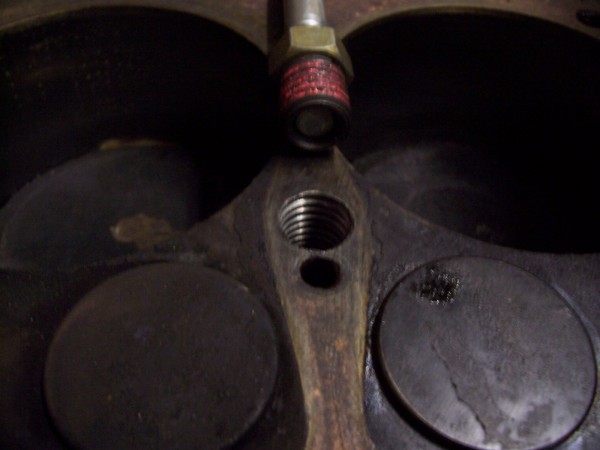

I need to repair one head bolt hole in my 1925 block, the one just outboard of the valves for #4 cylinder. I plan to use the “standard wall” 7/16-14 EZ Lok insert which uses a .531 (17/32”) tap drill, which precludes using the head as a drill guide. How do I best assure the hole gets properly located and aligned?
Miles

Thank you Jerry. I thought of trying that, but with the top of the hole already around a half inch, and oblong, I wasn’t sure the 0.531 drill would self-center properly.Jerry VanOoteghem wrote: ↑Sat Oct 23, 2021 5:24 pmMiles,
You might try using the cylinder head as a drill guide. I know the hole in the head is not big enough for the EZ Lock insert, but if you drill as large as the head will allow, it may clean up the hole enough so that redrilling with the larger drill will locate as it should.
How about if I take that cracked head I have and have that hole location bored out to 0.531, and use that as a drill guide?

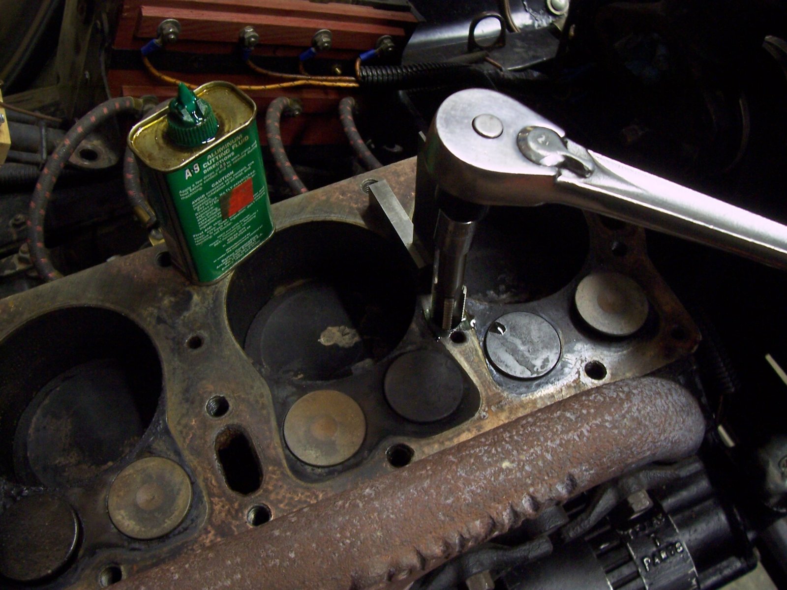

- Posts: 5548
- Last Name: Hatch
- Location: Alabama
Re: Stripped threads in block

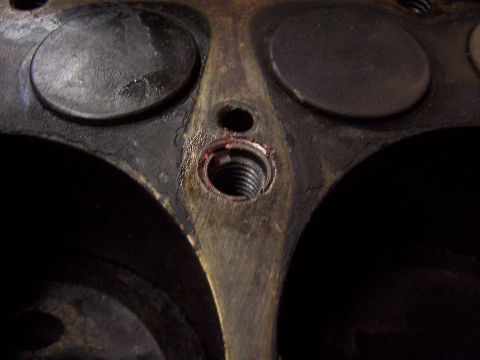

Here is a picture of the Lock n Stitch alignment fixture.

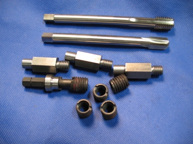

Here is picture of the Stevens kit I made a few years ago.
I still have some of the spacers for the head if you need.

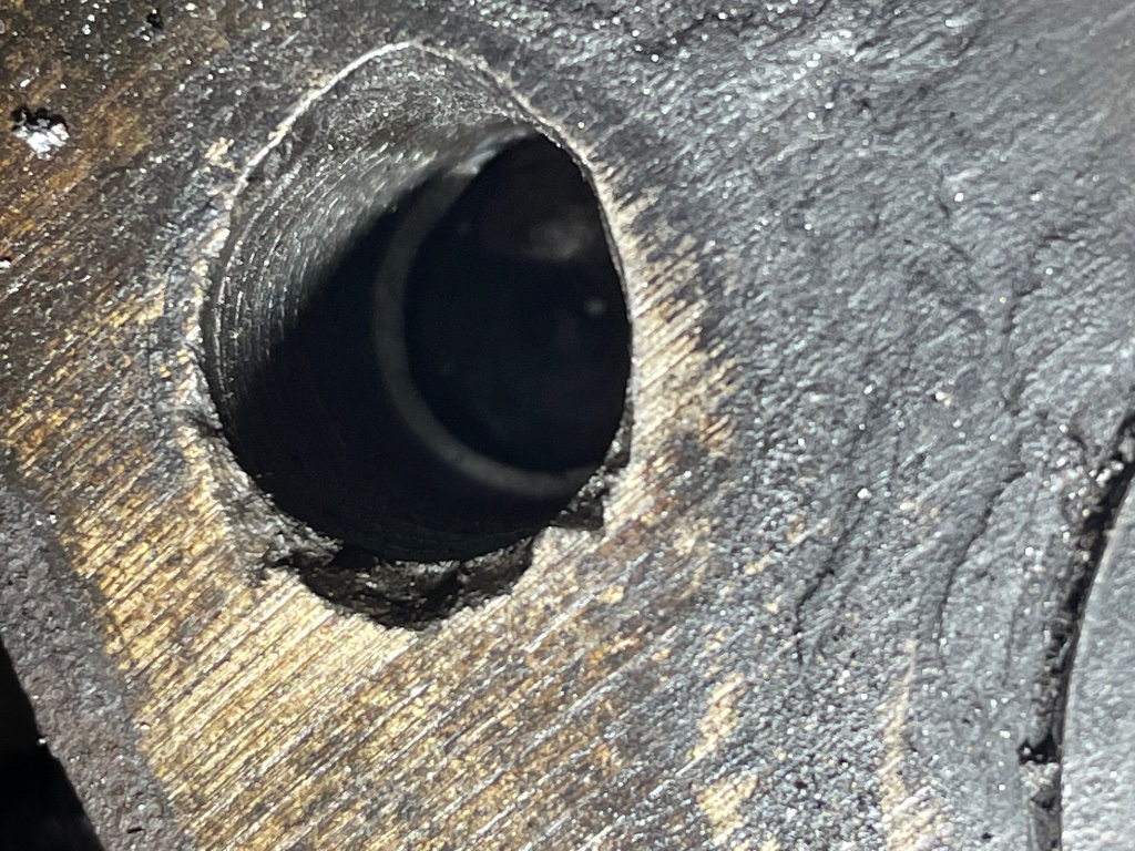

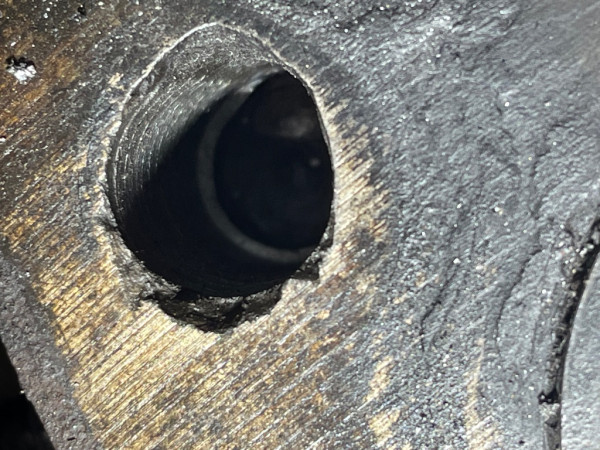

The photo below is AFTER I cleaned up the hole with a 29/64 bit, using the head as a drill guide. There’s very little cleanup, except that what little bit of thread that previously allowed the bolt to snug up is gone. There is still noticeable wobble of the 29/32 bit in the hole with the head off, so I’m not going to chance the Helicoil brand and go with EZ Lok.

- Posts: 5268
Helicoil is always my first choice. In this case, clearly not an option.mbowen wrote: ↑Sat Oct 30, 2021 12:18 pmThe photo below is AFTER I cleaned up the hole with a 29/64 bit, using the head as a drill guide. There’s very little cleanup, except that what little bit of thread that previously allowed the bolt to snug up is gone. There is still noticeable wobble of the 29/32 bit in the hole with the head off, so I’m not going to chance the Helicoil brand and go with EZ Lok.
I like the idea of sacrificing an old $10 head as a drill guide. Another head slap. One could hang onto it for different blocks down the road.
Better use than for the boat.
- Posts: 6805
Helicoil is always my first choice, too, as evidenced by my earlier posts. I agree that it is not an option for this job.
- Posts: 5268
Yes. for the reasons you mentioned, plus the idea of further down the road, if the helicoil hole were to fail again, one could go to the larger insert. As unlikely as that would be. Keep options open & do less harm. In this particular case, I would consider plugging the hole with a cast iron or steel pipe plug, removing the square drive & thread back to standard. Very effective for a miss located hole also. (should have mentioned that earlier) A fix I have done in the past with on hand parts & taps.Scott_Conger wrote: ↑Sat Oct 30, 2021 2:23 pmHelicoil is always my first choice, too, as evidenced by my earlier posts. I agree that it is not an option for this job.
mbowen
- Posts: 450
- First Name: Miles
- Last Name: Bowen
- Location: Brighton, MI

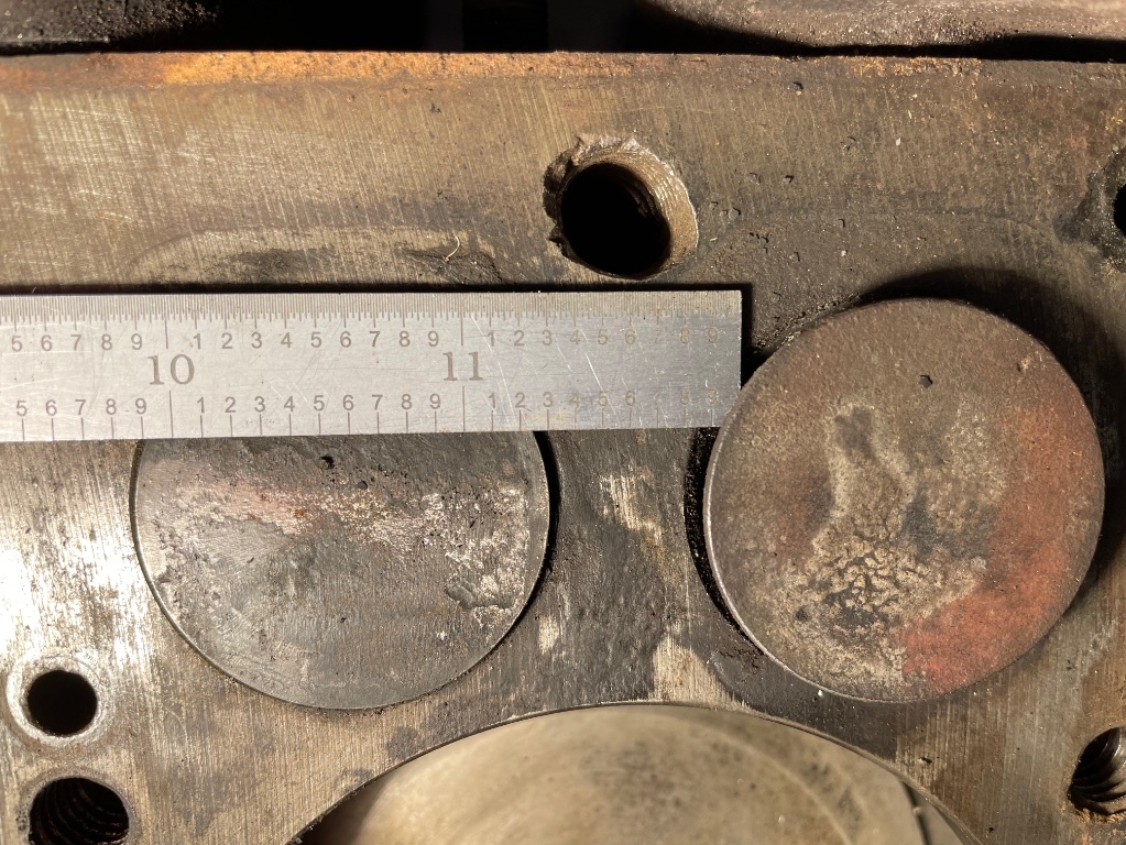

Following the “keep options open and do less harm” philosophy (and the advice of a respected T engine builder), I’ve decided to go with EZ LOK. The 7/16-14 EZ LOK insert only requires a 33/64” drill, as opposed to 37/64” for a 3/8-18 pipe plug. Also, the EZ LOK insert is 9/16” long, whereas a 3/8 pipe plug is only about 7/16 long. (BTW, if anyone decides to go with a pipe plug, the internal hex drive style wouldn’t have to be ground down).
Rockler Hardware sells a kit that includes a drill, tap, insertion tool, and 10 inserts. $80 is a a tad expensive, but I’ll make it available to others in similar situation. https://www.rockler.com/e-z-lok-thread- ... -x-9-16-12
Miles
1924 Touring “Bonnie”
1925 Express Wagon “Clyde”
- Posts: 4479
And.... the EZ LOK insert will be made of FAR better steel than a pipe plug! Good choice! The EZ LOK was designed and made to be a high quality thread insert. A pipe plug was made to be... a pipe plug...mbowen wrote: ↑Sat Oct 30, 2021 5:30 pmFollowing the “keep options open and do less harm” philosophy (and the advice of a respected T engine builder), I’ve decided to go with EZ LOK. The 7/16-14 EZ LOK insert only requires a 33/64” drill, as opposed to 37/64” for a 3/8-18 pipe plug. Also, the EZ LOK insert is 9/16” long, whereas a 3/8 pipe plug is only about 7/16 long. (BTW, if anyone decides to go with a pipe plug, the internal hex drive style wouldn’t have to be ground down).
- Posts: 5268

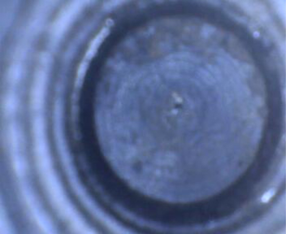

For the purpose of education, allow me to defend my plug decision. Some might be less dismissive.Jerry VanOoteghem wrote: ↑Sat Oct 30, 2021 7:32 pmAnd.... the EZ LOK insert will be made of FAR better steel than a pipe plug! Good choice! The EZ LOK was designed and made to be a high quality thread insert. A pipe plug was made to be... a pipe plug...mbowen wrote: ↑Sat Oct 30, 2021 5:30 pmFollowing the “keep options open and do less harm” philosophy (and the advice of a respected T engine builder), I’ve decided to go with EZ LOK. The 7/16-14 EZ LOK insert only requires a 33/64” drill, as opposed to 37/64” for a 3/8-18 pipe plug. Also, the EZ LOK insert is 9/16” long, whereas a 3/8 pipe plug is only about 7/16 long. (BTW, if anyone decides to go with a pipe plug, the internal hex drive style wouldn’t have to be ground down).
Any repair requires a careful evaluation of the problem & all feasible solutions. The final choice involves many factors, including ability, experience, time frame, $$, etc, etc.
In my case, the hole was next to a water jacket & more rotted toward that side. A helicoil was going to be to weak & walk over, misaligning the hole location. A keensert would have worked, but required more material removal, more fixturing for centering the hole, maybe via a sacrificial head. My choice was to Plug the hole & make a new one in the correct original location.
How to plug? Carefully considered also. Taper plug to lock it in. It aint backing out. Like a tapered cast iron crack repair pin.
What to use? Pipe plug size works. Have the tap.
What to use as a plug. Many options. Send for a chunk of cast iron, arrives same day & make one? Evaluate on hand or available. Galley plug type too short. steel hex pipe plug? cast iron square drive longer, better. If you are a packrat you have a NOS iron one thats 1 thread longer. Bingo.
The repair was quick(bonus, but rarely a factor), Accomplished the goal,(very well), Got the job done without pulling the motor, has been effective & trouble free for decades. I have no regrets or apologies.

Lock n Stitch plugs
http://castingrepair.locknstitch.com/vi ... basic-kits
They have many other repair options.
Not cheap, but they work.
