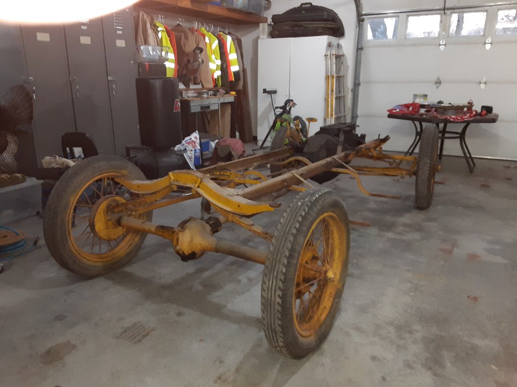

This does not address the topic, but I would like to share my experience with my original tires on my 1927 coupe. The coupe had not been run since 1960. Three of the tires never lost any pressure during those 60 years. The car was never on jacks.
The car was moved from one storage place to another over that period of time, in North Dakota, Minnesota, and Iowa. Each time it was moved I found the front left tire completely flat. I would air it up, and it would hold air for several months and then go flat again. I am puzzled how the inner tube could stand going completely flat and still be able to hold air. You would think that it would have developed cracks.
I am replacing four of the tires with new Firestone, and am keeping one for the spare. Saving $ because I don't plan on going on tours!!
