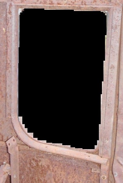

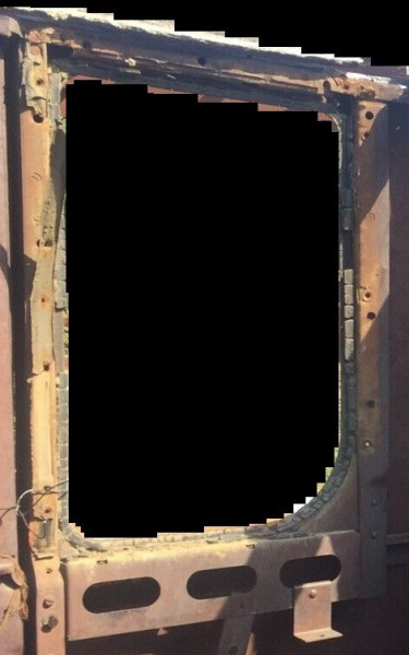

I will try from our Oct 1926 coupe. There is no interior yet.
There are different 26-27 rear and side constructions and I really need to see what style you have.
One of the best options will be to use a cardboard template by tracing the interior of the side windows.
Here are some examples that I found from unobtainium:
