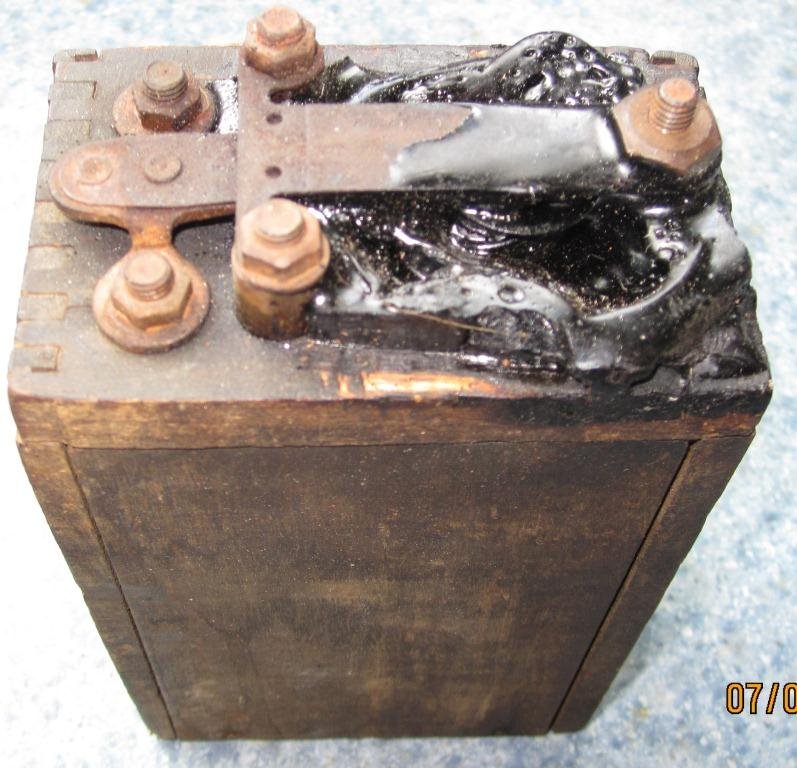

Re: One coil buzzes constantly
Anytime one coil is operating continously regardless of timer position can be caused by several things as indicated in several responces to the original post. But I can tell you this, it can be very dangerous fire hazard and you had bettered get to the bottom of the cause immediately!
What hapens is shown in the attached photo and worse yet the points get jamed closed by the hot tar boiling out of the primary winding core hole on top of the coil wood top. Ron Patterson
