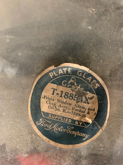

A friend accompanying me pointed out he had some original glass in his car. An interesting discussion followed.
