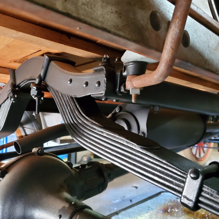

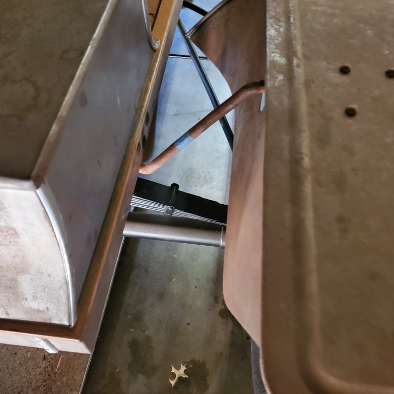

Assembling a 12 roadster and need to know the size of the bolt that passes through the frame brackets (ears) at the rear and the holes in the body bracket. The holes are too large for a 3/8x24 bolt. Would like to know before I purchase them.

I believe the body bracket bolts were 7/16" that held the body to the frame. Perhaps I'm not understanding your question - only the rear body brackets on the runabout have square holes for the fender bracket as they use a 3/8" carriage bolt inboard with the nuts outboard.

Thanks for the photos Richard ! I wasn't aware of the "single" bolt holding the iron - earlier type than I'm familiar with.
